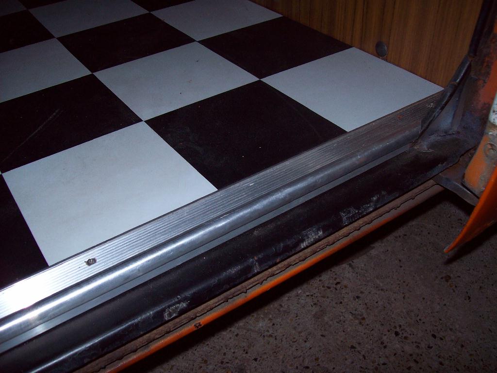

hazetguy Samba Member
Joined: April 06, 2001 Posts: 10804 Location: the past
| Back to top |
vw57drvr Samba Member
Joined: October 23, 2005 Posts: 1705 Location: Rome, Ga
Posted: Mon Mar 23, 2009 10:43 am Post subject: |
Looks good. The only concern I have is that with me using pergo type floor, I have to cut the edges on each sheet. If they arent perfect, it is gonna show. _________________ 60 Rock Grey Vert |

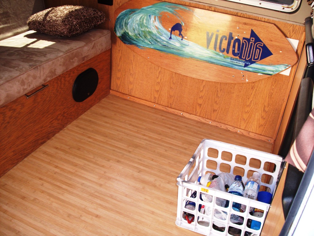

DSM8 Samba Member
Joined: March 09, 2008 Posts: 44 Location: Vancouver, WA.
Posted: Mon Mar 23, 2009 2:05 pm Post subject: My wood flooring |
I cut the floor around the sink, removed the fridge/stovetop and cut the flooring just under the door of the bed. Made things alot easier to fit, and no one sees under the bed anyway. Could'nt believe how easy it was.

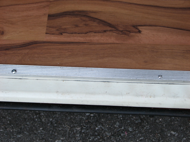

Rubber Duck Samba Member
Joined: January 18, 2006 Posts: 806 Location: Pitt Meadows BC
Posted: Wed Mar 25, 2009 7:35 am Post subject: |
I didn't go under in mine as well. I believe the subfloor has to go under...there's some spacers that came with the bed for that. But the actual floor did not fit under the bed.
In hindshight, maybe I should've gone with a thinner subfloor, I went with the recommendations of some members here, but I also put a little bit of foam underlay (the kind that goes under laminate anyway) and that little bit is what added up.
This is the original trim piece that came with the bus, as well as the white plastic piece. It cleans up good with dishwashing liquid.
As you can see, the flooring goes fine under the jump seat as well as the fridge/cooler thing.
The net result though, is quite nice, to my eyes at least

Gr8tfulEd Samba Member
Joined: February 19, 2009 Posts: 125 Location: L.O., OR, USA
Posted: Wed Mar 25, 2009 7:49 am Post subject: Re: My wood flooring |
| DSM8 wrote: |
Dang that looks sharp. Is there a frig or icebox in that layout? _________________ ------------
1973 Kombi Riviera camper named "Belle"
1979 Super Beetle Convertible named "Otto"- daily driver |

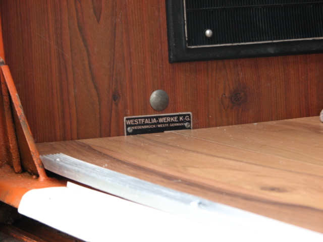

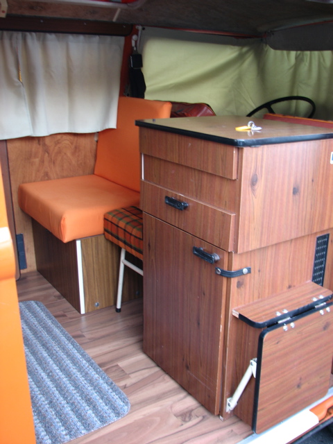

itlives Samba Member
Joined: July 12, 2005 Posts: 1424 Location: Shreveport La
| Back to top |
Posted: Wed Mar 25, 2009 8:01 am Post subject: |
Very nice and clean. I do not have that original trim piece at the sliding door unfortunately. Seems like someone took this thing apart, then lost all of the little pieces. Trim, screws, etc. _________________ 60 Rock Grey Vert |

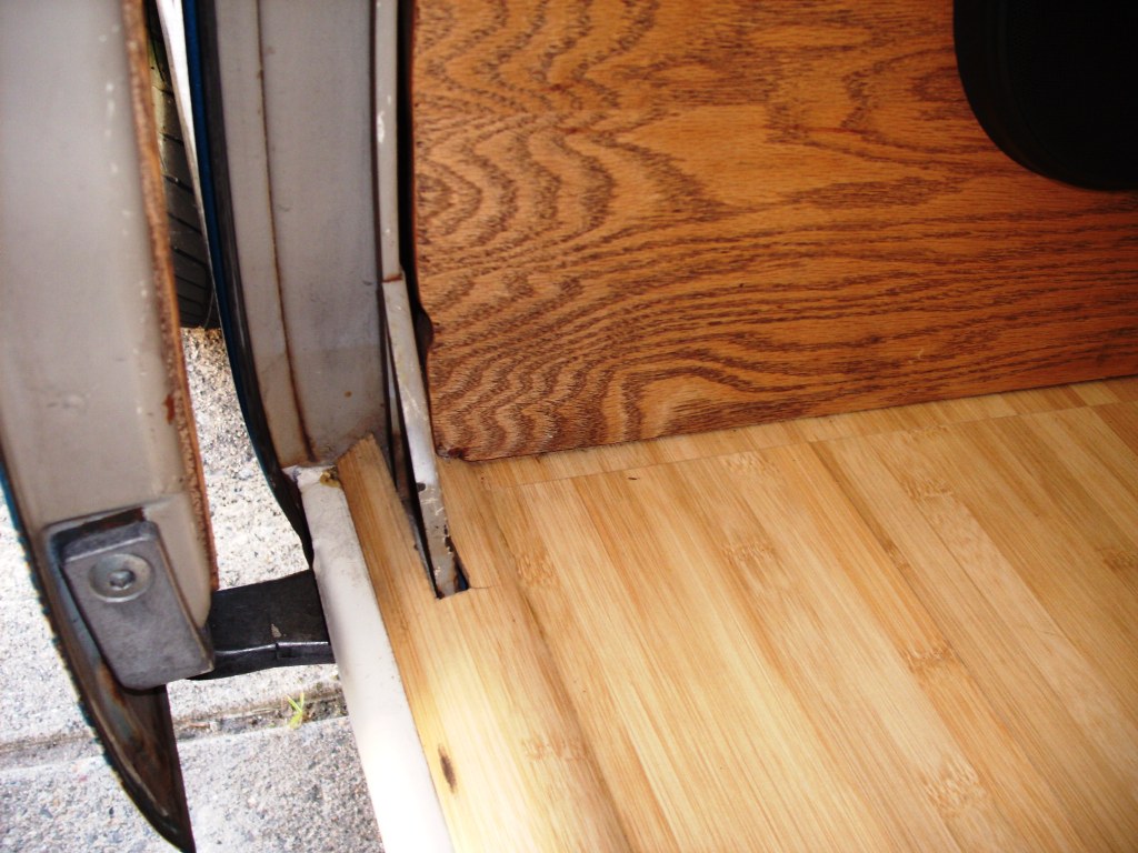

I did extend mine under the bed. Mind you I do not have the stove or fridge in mine either. Or the cabinets for that matter!
The bamboo flooring from Home Depot came with the trim peices. i just had to do a little cutting.
I think it looks pretty good!
