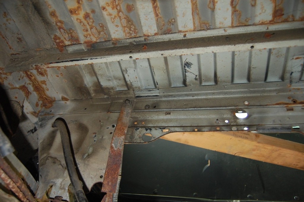

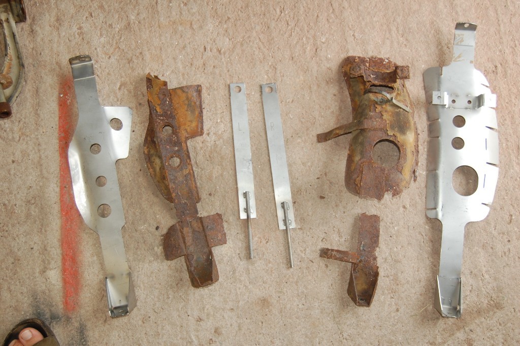

The first thing to remove is the skid rails. I took out the spare tire carrier while I was under there. Once the skid rails were off, I removed the prop shaft.

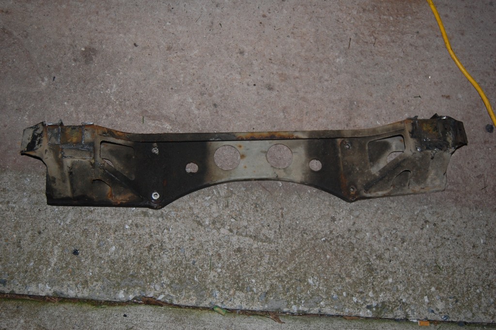

The next thing I did was to drop the Syncro's engine and tranny. I used an idea I saw on the Samba about using a boat trailer hoist on a 2x4 frame.
PB Blaster is your friend. Soak every fastener you need to remove for the entire project. Any bolt or nut you see, give it a shot.

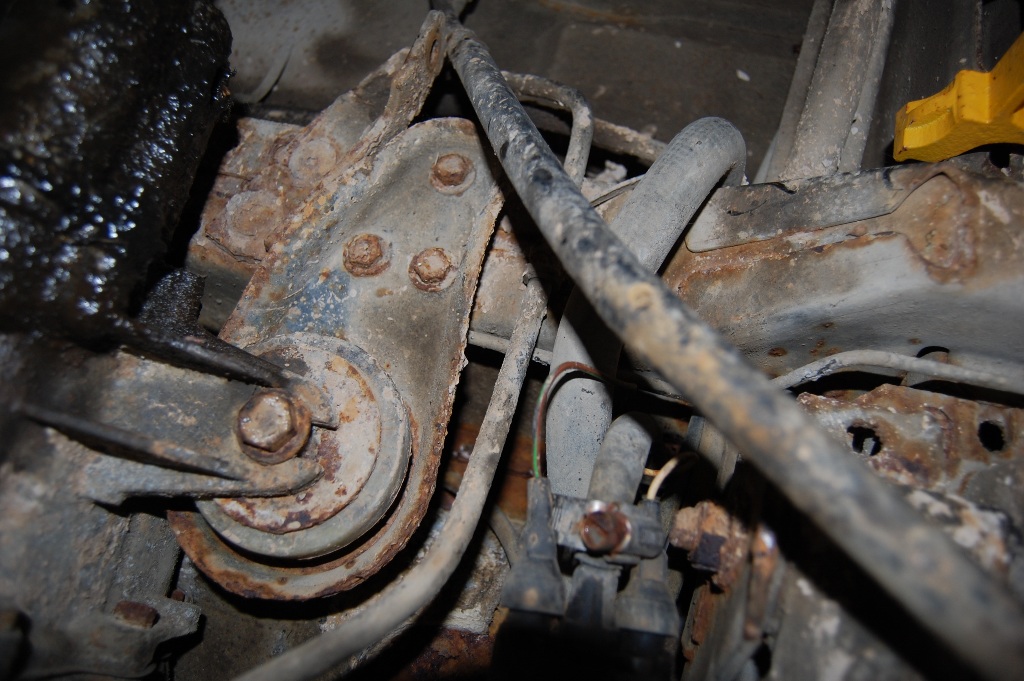

I found that it is easier to remove the three bolts which hold the tranny mount to the frame than it is to remove the one bolt which holds the bushings for the tranny.
Note the bracket spot welded to the frame. This is a mount for the skid rail. These brackets will need to be transferred to your 2wd. More on that later.

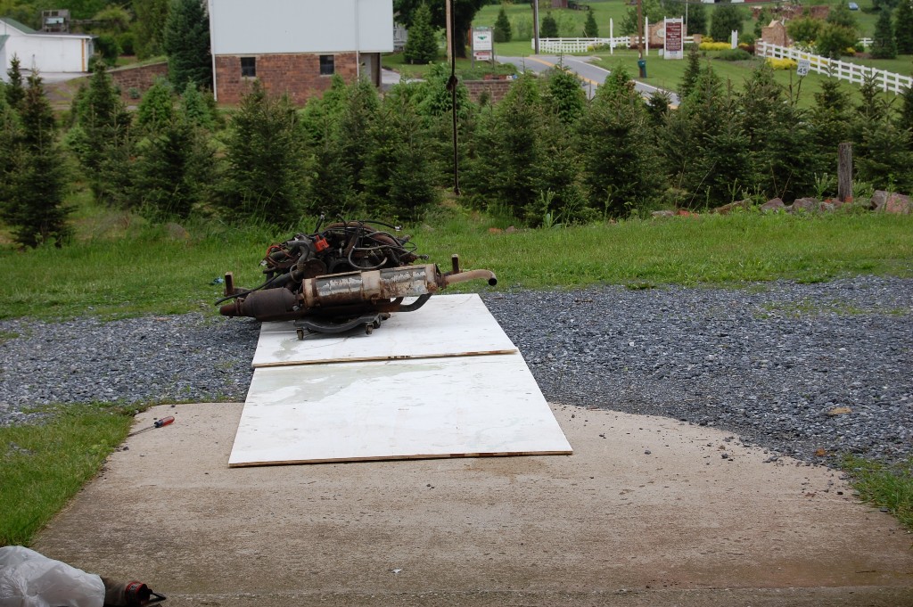

Once I had the engine and tranny out of the van, I made a “road” by pulling the engine/tranny from one piece of ply wood to the next then advancing the empty piece of plywood to the front. A little time consuming, but manageable for one person.
Follow the Yellow Brick Road.

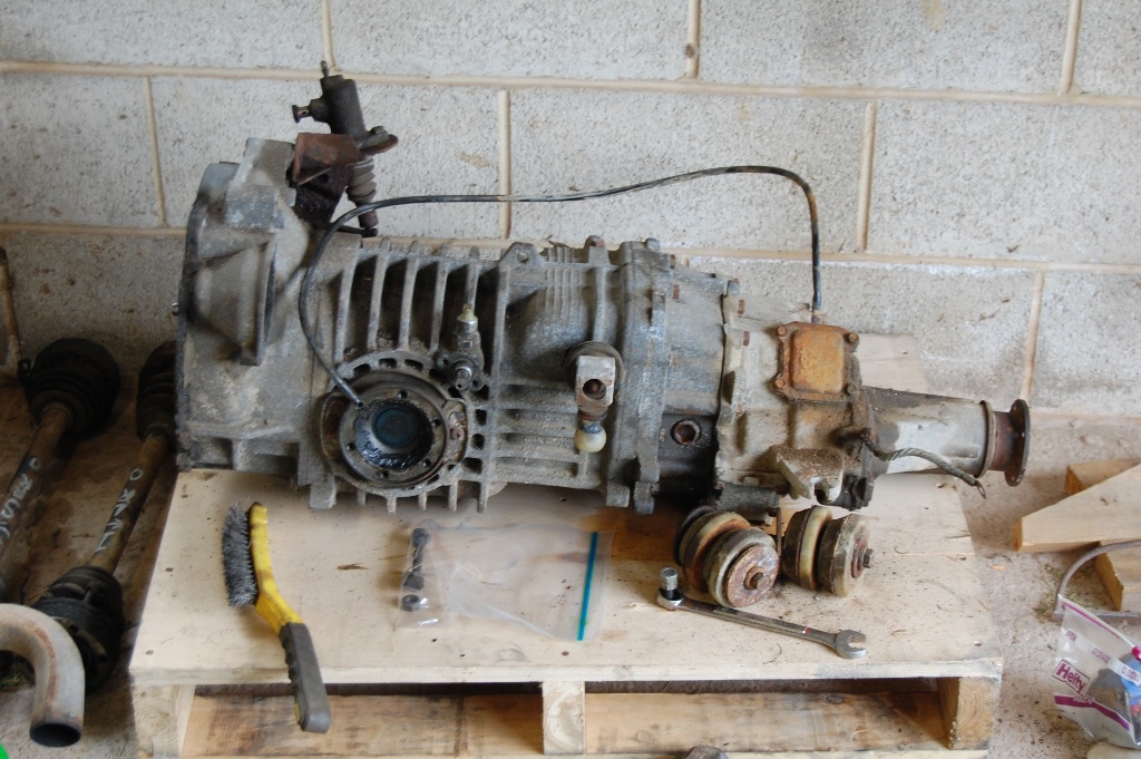

The Syncro engine is the same as the 2wd engine except the Syncro has an extra seal. There are some differences in the coolant piping due to the fuel tank, but we'll get into that later. The Syncro tranny mounts differently than the 2wd tranny so you have to make your own threaded holes in the frame.
Syncro transmission. Note the pin for the rear locker and the poor man’s fill/drain plug wrench: a 17 mm bolt double nutted. I ended up having to break down and buy a 17 mm Allen head socket to break free the fill plug.

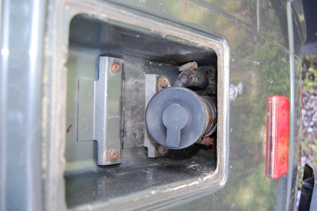

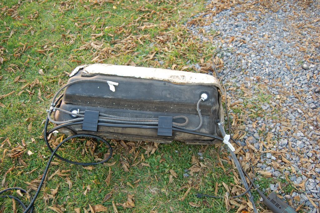

Once the engine and tranny were out, I tackled the fuel tank. For those not in the know, the Syncro fuel tank resides above the transmission since the 2wd fuel tank location is where the front differential and sub frame live.
First off, disconnect the fill pipe from the tank. You need to remove the right rear shock to do this.
Remove the fuel filler and vent hose.
Remove the hoses to the charcoal canister located in the driver's side rear wheel well. Note the position of the Air Conditioner receiver/dryer. It is in the vertical position on the Syncro, but is angled toward the rear on the 2wd. Not much of a big deal now, but this little detail made for some head scratching further down the road.
The fuel filter is located on the other side of the spring support.
Disconnect the fuel return line and wire from the fuel level sender on the left side of the tank.
Right fuel tank strap.
Left fuel tank strap
As can be seen from the photos, the fuel tank straps were shot.
I ordered a set of stainless steel ones from the Samba Classifieds.
Removing the fuel tank is a real bear. It's sort of like sanding drywall, putting up insulation and trying to squeeze a fat chick through a small door all wrapped up together. The donor's fuel tank was covered a layer of fine salty dust accumulated over the years of driving in New York winters. Even with safety glasses and a dust mask on, this cloud of irritant attacked my eyes and mucus membranes with the accuracy of a smart bomb. Then there was the insulation. Wear long sleeves, so you can be both itchy and hot. Sweaty, salty and itchy I moved on to the next phase trying to squeeze that fat chick through the frame. The bolts of the fuel level sender catch on the frame during removal. I ended up using a crowbar to flex the plastic of the tank enough to slip each bolt one by one past the frame.
Here's a shot with the tank out. Note the two roll over valves on the top of the tank (white). These are brittle and break easily. Replace them now since it's such a bear to get back in to do it later. Also note the groove in the top of the tank.
This fits around the cross member which runs at the top of the cavity where the tank goes.
This shows the routing of the hoses above the fuel tank. The two brackets fit into mounts on top of the tank. Mine broke off during the removal of the tank. I ended up epoxying them back on.
Now's a great time to replace all your fuel lines/hoses. I got a kit from Ken at Vanagain with more than enough hoses and clamps. When routing your NEW hoses especially your rollover vent hoses, make sure they don't cross the "valley" in your tank or they will be pinched during installation. Look at the photo below of my tank and ask me how I know this. Reminder: the roll over valves are brittle. Heat up the grommet with a heat gun before you try to install/rotate or your next call will be to the Bus Depot. (Again, ask me how I know this) Whole lot of learning going on.
I used metal tape to repair the spots on the tank where the metal covering the insulation had corroded away.

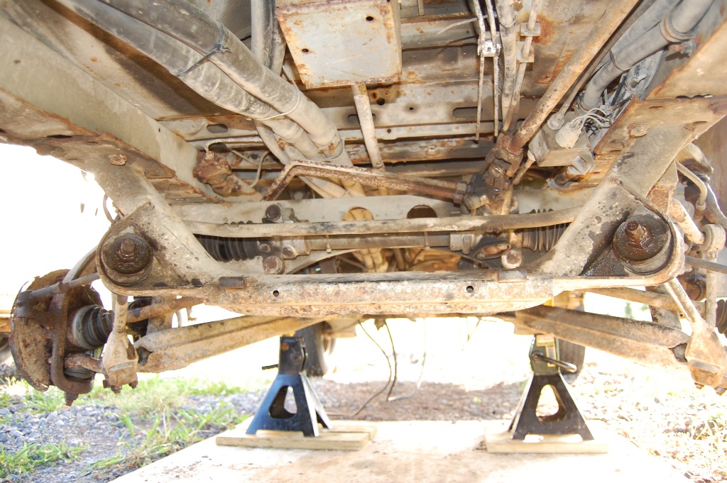

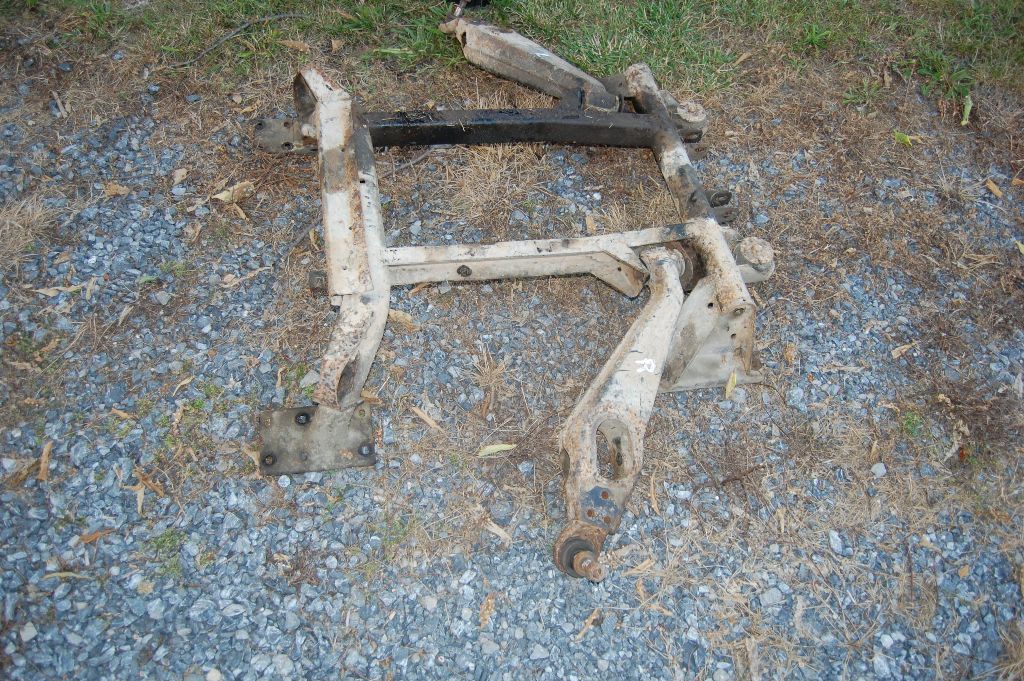

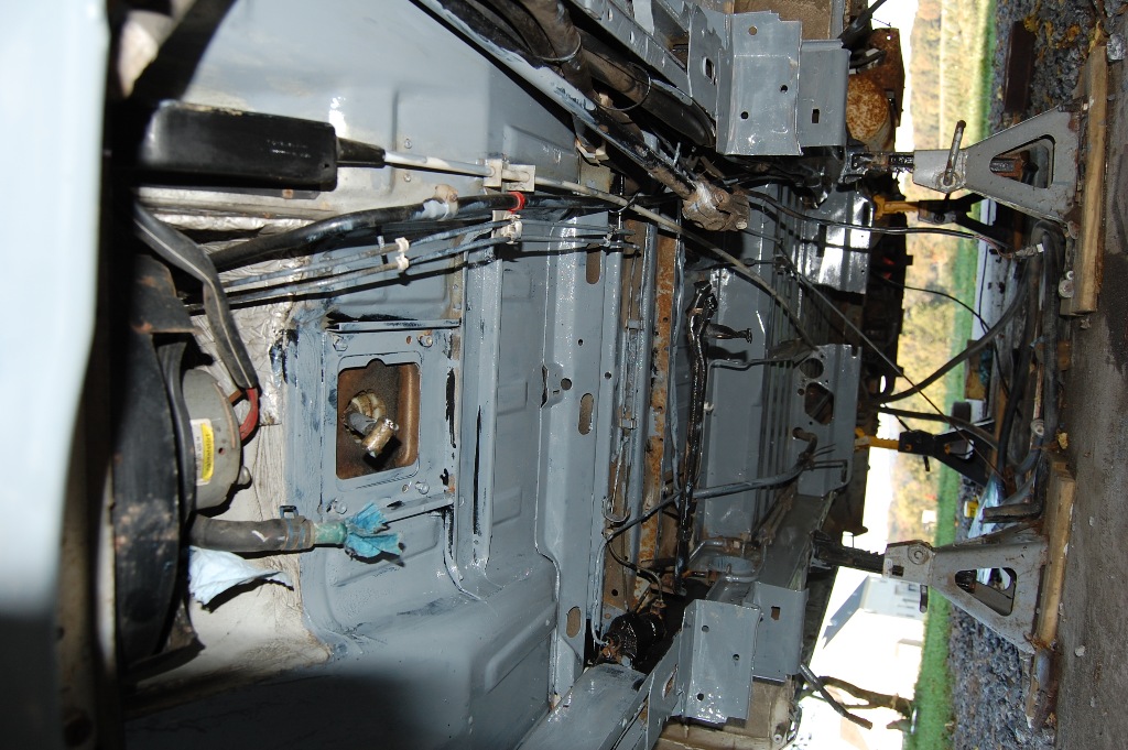

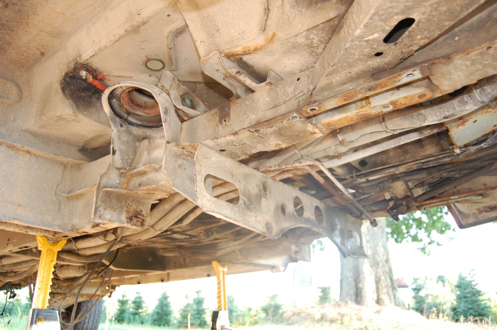

After I had the engine, tranny and fuel tank out of the donor Syncro, I moved on to the front end. The front suspension resides in a tubular sub frame which bolts to the frame rails.
First unbolt the axles from the front differential. Next, unbolt the front diff and remove. I attempted to unbolt the upper ball joints from the upper control arms, but was only able to break one of the Allen bolts free. After several attempts with PB Blaster, chisels, hammers, and other implements of destruction, I found success by using one of those damaged bolt head removers.
I then removed the tie rods, upper control arms, the shocks, springs and steering knuckles. The bolts for the lower control arms were frozen inside the bushings so these came out with the tube frame.
Here is a side view of the tube frame. From the looks of the oil, I’d say I’ve got a leak in my front differential axle seal. Note the mounting plate. This came mounted with three bolts, but there are 6 holes. I plan on adding more bolts for strength.
Once the sub frame was out, I was able to break one of the lower control arm bushings free with a breaker bar and a friendly neighborhood persuader. I beat on the other one long enough to devise a new plan. I ended up cutting it off with the angle grinder and a cut off wheel.

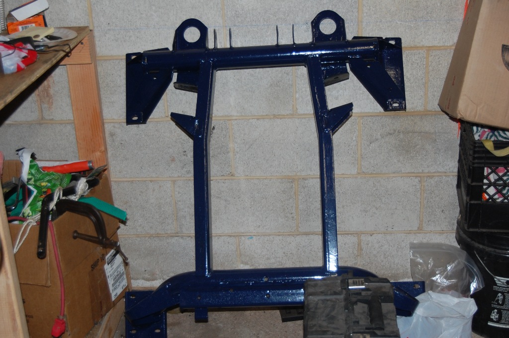

I cleaned up the sub frame with a wire wheel in my grinder. Make sure you’ve got a face shield as those little wires from the wheel fly off like little darts. I put on two coats of POR-15 and then brushed on a coat of Rustoleum blue.
Once the sub frame was out, I removed the power steering rack. Note the semi circular void at the bottom of the power steering rack mount. This provides the needed space for the front differential. Here's what it looks like under the Syncro without the sub frame and suspension parts. You can see where the sub frame was bolted onto the frame rails.
This entire rack needs to be transferred to your 2wd Vanagon. You will mount it to the stubs of your existing 2wd power steering rack mount. You want to remove the entire rack mount in its entirety.
It was a job to cut this PS rack mount out of the Syncro. I cut what I could with my angle grinder and cut off wheel, but I couldn't get the top. I drilled a series of holes through the frame rails and then connected them into a slot with my dremmel tool. This allowed me to get the tip of a sawzall blade to cut the remainder. A torch would be the weapon of choice for this unpleasant task.
Get this sucker out and throw it in your vise to grind off everything that isn't the Syncro power steering rack mount.
Here is one side all cleaned up.
I cleaned this up and it also got two coats of POR-15. _________________ 1990 Westy converted to a Syncro Westy

Sorry for the delay, but I’ve been on 12 hour days at work and just got off of a 12 day stretch.

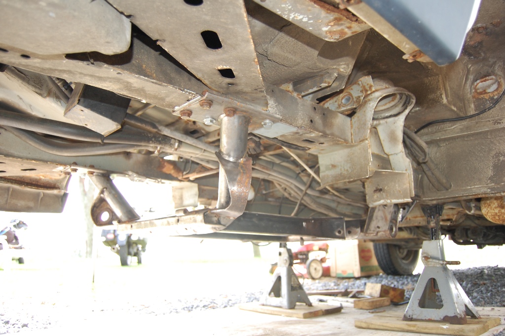

After I finished removing the front end from the donor Syncro, I focused my attention on the 2wd front end.
Here is the front end suspension minus the shocks and power steering rack after I removed it from the Westy.
This is what the front end looks like without the suspension.

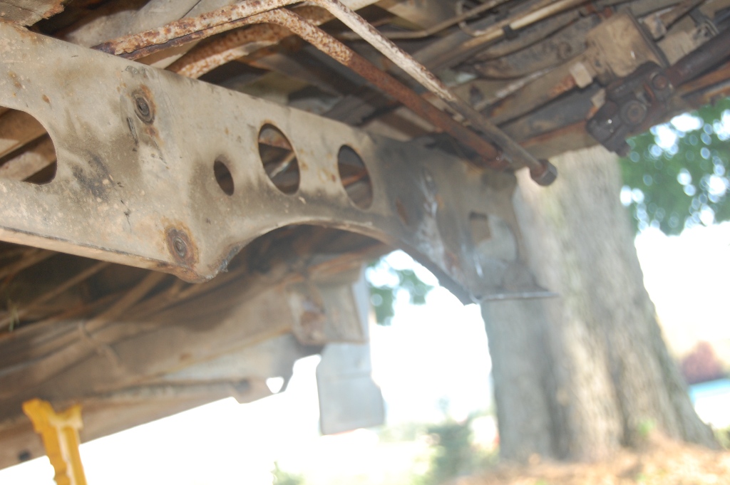

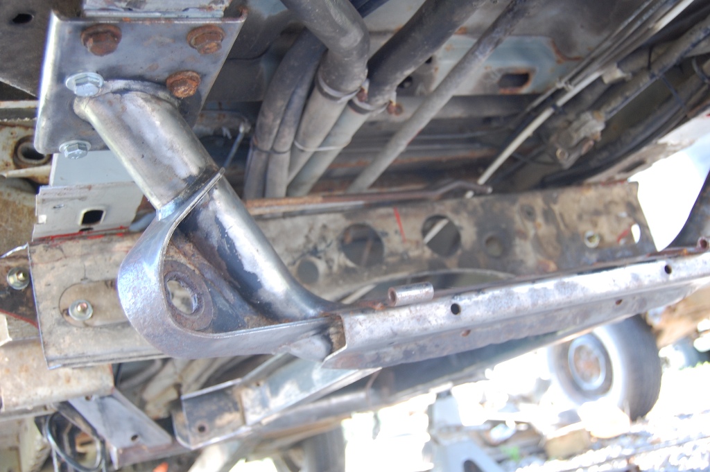

Note there are three brackets which need to be cut to allow for the mounting of the front differential and the tubular sub frame. From left to right: The lower control arm rear mounting point bracket, the power steering rack mount and the radius rod mount
I started with the front radius rod mount.

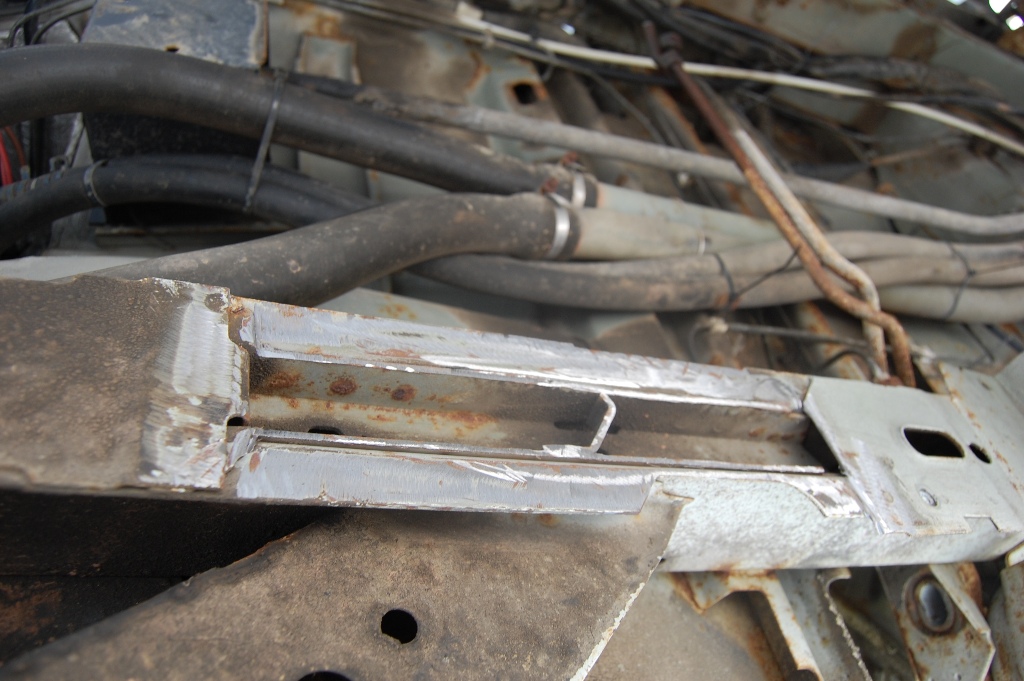

The front radius rod mounts are cut off flush with the frame rail. This is where the front of the Syncro’s sub frame will mount. I used a sawzall to cut the mount off then ground it flush with an angle grinder.
Next I cut some plates out of 1/8” steel to fit the recess. I believe these were 3” x 11”.
Next, you must cut out the middle portion of the power steering rack mount leaving stubs to bolt the Syncro power steering rack mount onto.
I cut mine about ¾” inside of the wiring harness mounting hole at the top.

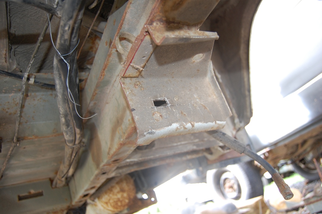

The last rack to be cut out is the lower control arm mount. This must be cut back close to the frame rails. I cut mine about 1/2" from the inside of the frame rail.

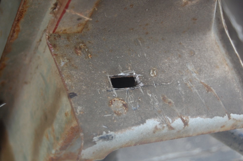

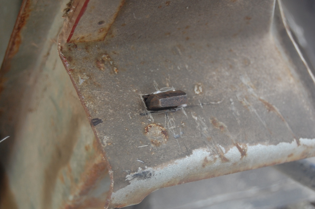

Inside each frame rail resides a flat stock bar with two threaded holes. You must cut a slot in the end of the frame rail to insert this bar. Find the location on your donor van and transfer it over to your 2wd. I used my dremmel tool to cut this out.
Here it is with the threaded bar installed. There are existing holes in the frame rails which match up with these threaded holes.
Now you can mount the sub frame. The frame came mounted on the donor Syncro with 3 bolts, but there is room for more. 5 bolts attach directly to the frame rail lip. The 6th bolt will only hit the 1/8” plate.
Once I got the holes for the sub frame drilled, I clamped the 1/8” plate in place and welded it to the frame rails. A wise man would have marked where the sway bar mount would mount and try not to weld there. Lacking the forethought I had to grind out a groove in the weld for this mount. I have photos of this, but can’t find them right now. I’ll take some more and post later.
Next take the Syncro power steering rack and clamp it onto the stubs of the 2wd PS rack.
I installed four 3/8” bolts on each side. I welded this rack to the frame and tacked the nuts to the bolts to prevent them from spinning loose.
Here is the front sub frame and the power steering rack installed.
After that, I cleaned everything up and painted it with two coats of POR-15.

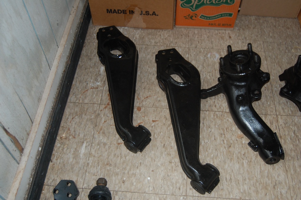

All of the suspension wear parts were replaced: ball joints, control arm bushings, wheel bearings, tie rods etc. I cleaned each part with my angle grinder and a wire wheel, put on two coats of POR-15, then had the new parts pressed in at Baum’s VW in New Cumberland.
Here are some of the after shots:
Upper control arms and lower ball joints
Lower control arms and steering knuckles and hubs
Radius rods and my home made plates
