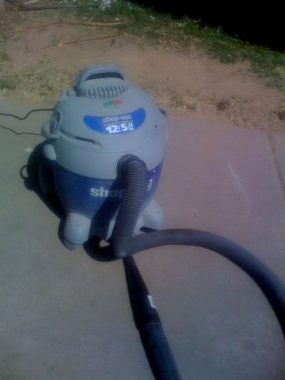

since I did have sparkling success with draining about 95% of the fluid out of my van using the shop vac method I thought I would post a few pics to help anyone else who is going to try this incredibly easy and clean method of removal... I was dreading it and it was just too easy.
Here is the vac I used:

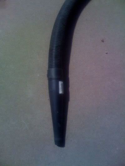

This is the adaptor that made it so easy, fit right into the tank:

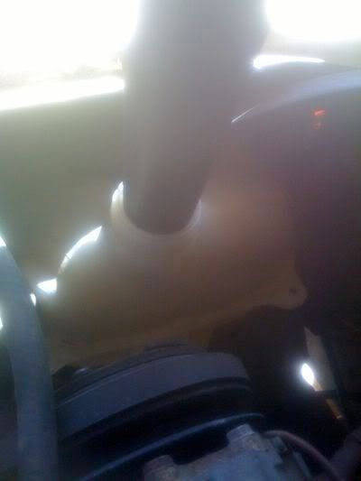

And here it is in the tank:
REMEMBER TO TAKE OUT THE RADIATOR BLEED SCREW!
and suck away. once I removed the practically dry front hoses from the radiator I gave them a good suck too... and got about 1/2 gallon more out.

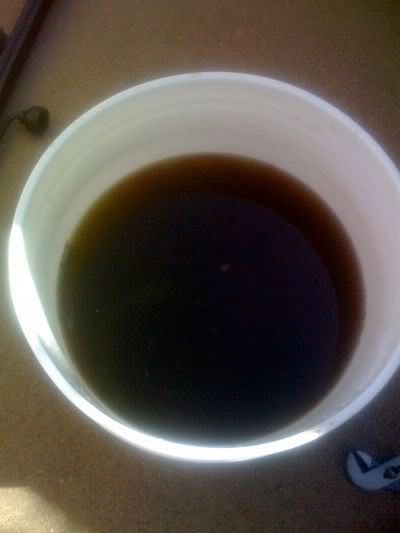

Here is the 5 gallon bucket of crap after it all:
When it was all done I simply sucked up some freshly chlorinated pool water and boom =)... the vac was nice N clean =)

I think I may try this. Some questions:
What/where is the 'bleed screw' and why does it have to be removed?
What antifreeze did you use and how much?
I once added a flush kit to a Toyota pickup, I wonder if this is an option with the vanagon. Did you think of a system flush or is your suck/drain method enough?
Great post, thanks.
Dogpilot
Joined: October 03, 2005
Posts: 4205
Location: Flagstaff, AZ
Dogpilot is offline
PostPosted: Sat Apr 04, 2009 9:05 am    Post subject: Reply with quote
You open the bleed screws so that it allows air to replace the coolant on the far end of the system. Then the coolant can migrate to the vac without collapsing the lines or the radiator.
