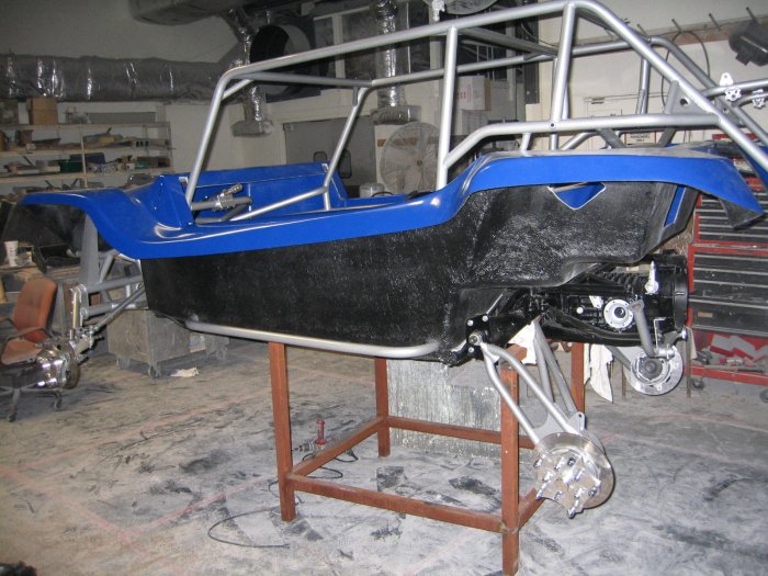

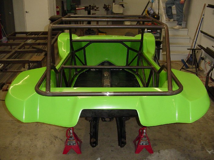

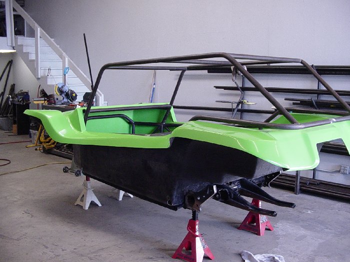

Here are some pictures of my Mid-travel Manx body & chassis project. The body and chassis will be sold as a kit. We are making the chassis out of 1 1/2" .095" D.O.M. tubing with 1" D.O.M. tubing lacing. We will offer it with either a 6" wider beam front end or a "J" arm front end. The chassis is design to fit on a stock VW pan.

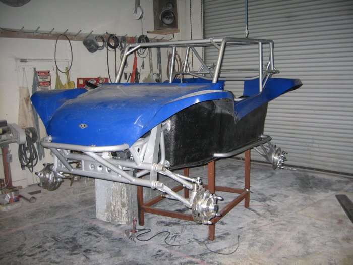

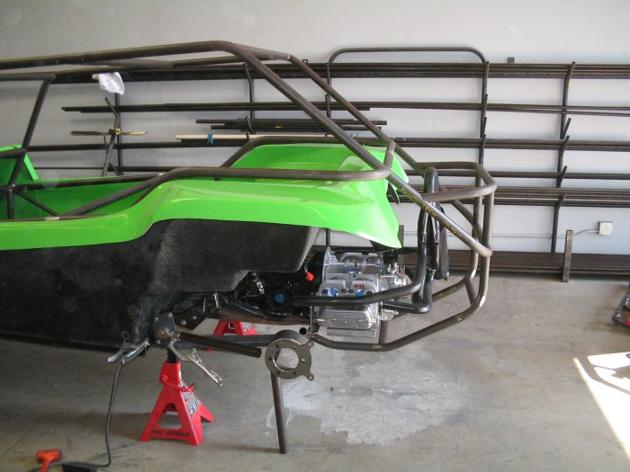

Here's a couple more pictures of the mid travel manx

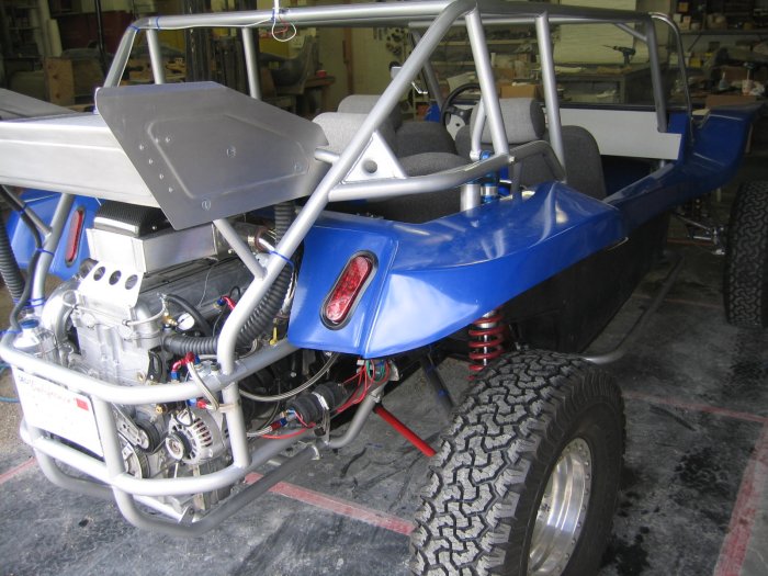

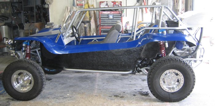

Im loving that blue one. Is that an Ecotec engine? How is the reliability of those engines compared to a Subaru??

That is an Ecotec in the blue car and the green car is getting a VW engine. The bodies are from MGM/FRP. The new mid-travel body has been working out great because it's 5" wider & 4" taller then the old manx style body plus it has raised fender to acomodate up to 16" front travel with a beam front and up to 17" rear travel with 3x5 trailing arms.

I like the fact that it's gonna fit a stock length pan. I always thought the manxes were too short. Cool

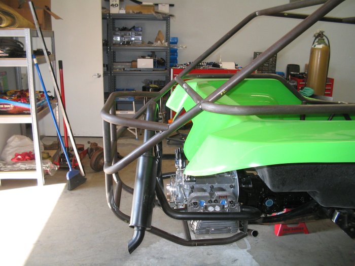

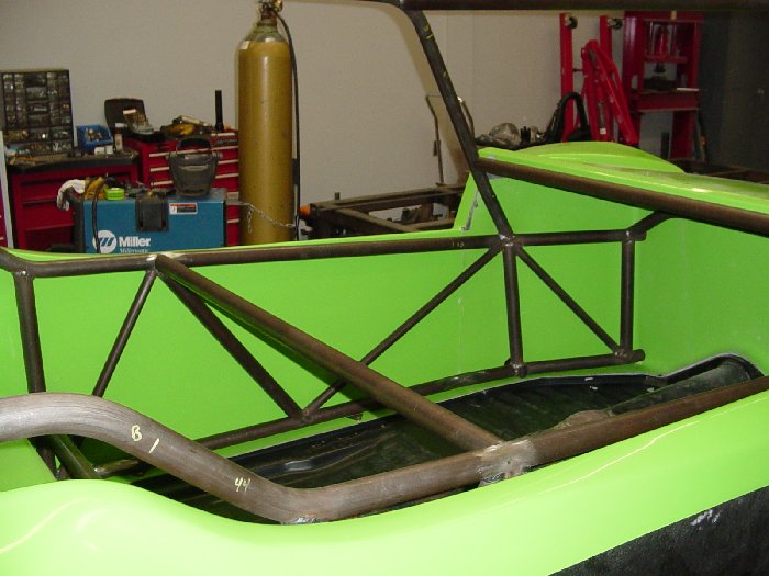

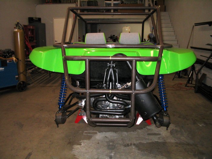

Here's a couple of new pictures of the rear of the project car.

Are you going to make the engine cage removable?
Are you worried about the large flat span of unsupported cage over the passenger compartment?
I really wish I had access to dunes in Florida. I would build a car like yours in an instant. It would get torn up in the tight woods we have to ride in though Sad
The engine cage will be removable with 3 bolt flanges and the large flat span will have a supports add to it. I'm putting 5x5 rear trailling arms with 14" travel shocks so I'm waiting to put that last support in intill we figure out the shock location. The blue car that has been finished, has 3x5 rear trailling arms with 12" travel shocks, so the cage supports are in a different location and we did not want to copy that location just to take them back out again.

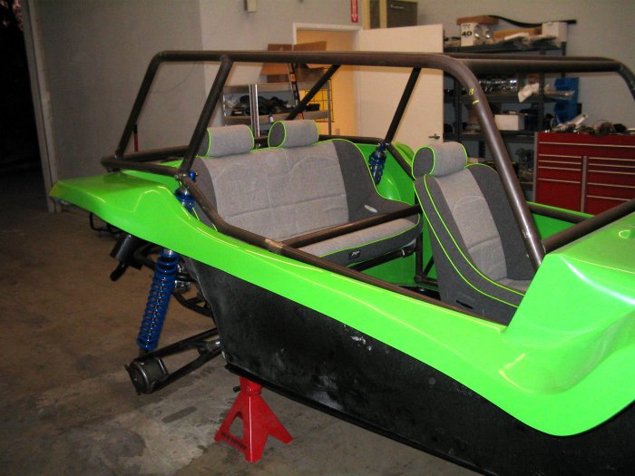

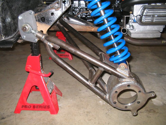

Here's a couple of new pictures of the rear 5x5 arms with 14" travel shocks. also have the seats placed as well.
