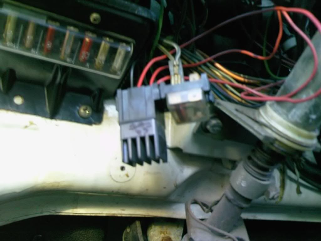

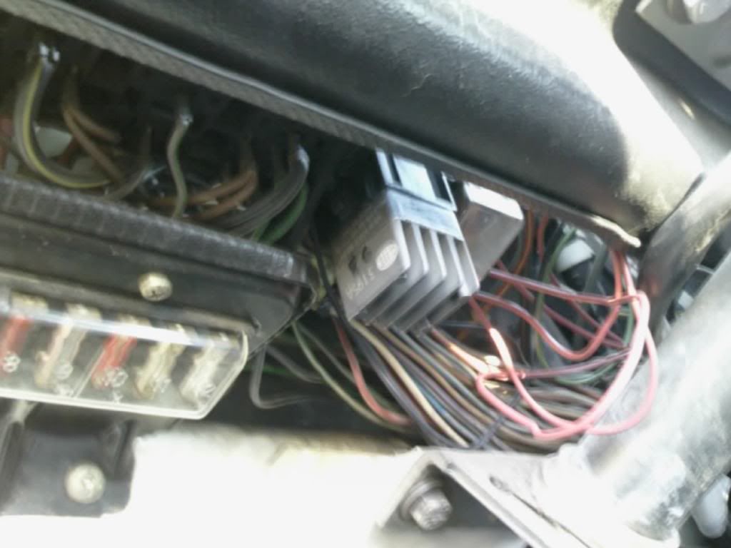

Posted: Fri Jun 13, 2008 9:10 pm Post subject: |
Well I have had the relay for my key in/radio on, key out/radio off modification under the dash (it runs off the grey/black door buzzer wire leading from the ignition). But it was making noise because the relay was just in there loose banging about.
My relay sockets above my fuse box didn't have any expansion left.
I did notice that there was a clip on expansion fuse box on the relay sockets. So if I could find a used relay expansion socket, not only would it solve the problem of banging about, but it would look totally stock!
Went to a VW garage today and they had a 2.1 relay/fuse panel. There were some clip on relay sockets and I got one.
Luckily it fit onto the 1.9 relay panel. Here is what it looks like:
The parts nos. are:
VW 161 937 501 B
AMP 927 288
These would also be good for the SA headlamp relay conversion, nice clean look![/img] |

keithwwalker Samba Member
Joined: May 30, 2005 Posts: 886
Posted: Wed Apr 15, 2009 4:06 pm Post subject: |
The part number is for the clip/base that holds the relay to the fusebox. It is good for housekeeping under the dash.
The relay is a solid state Hella
http://www.rallylights.com/detail.aspx?ID=435
The unit to the right in the photo was on my doka to begin with. I didn't trace the wires. |
