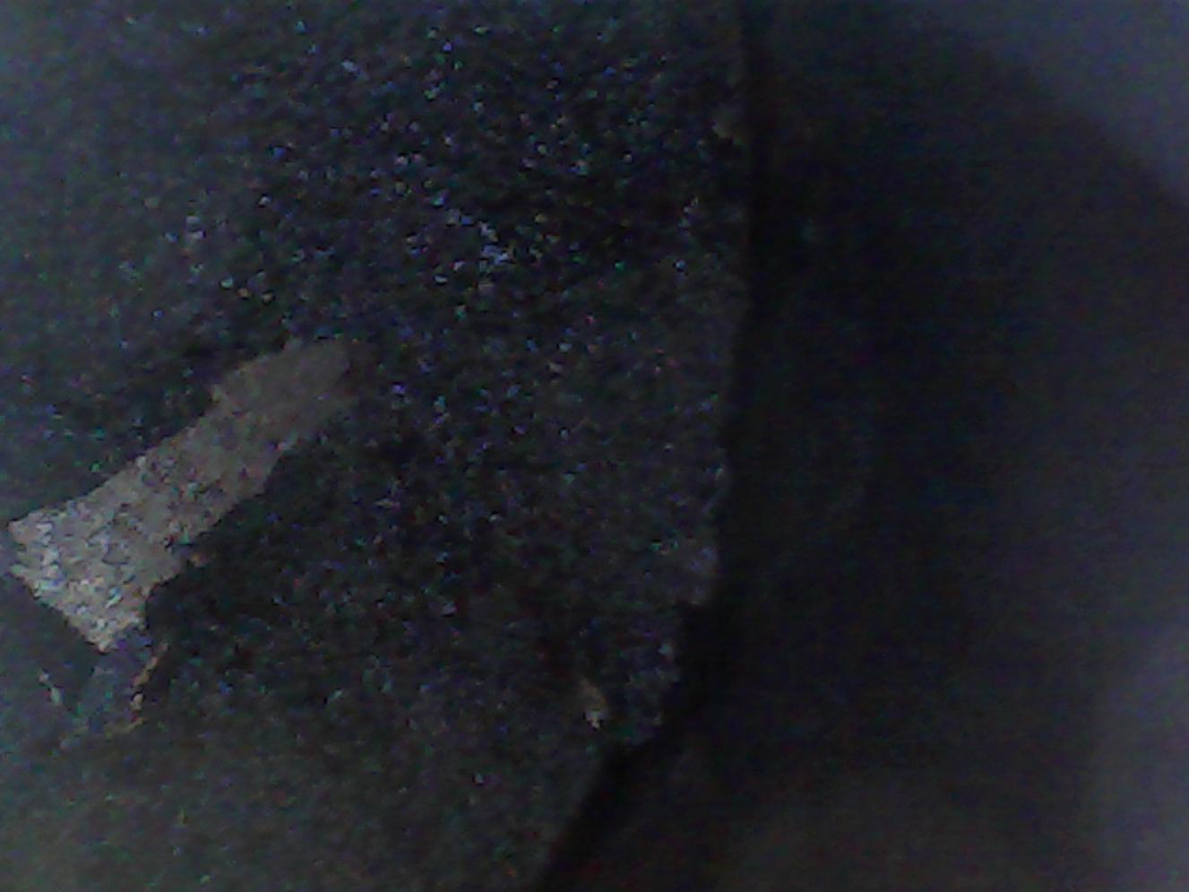

PostPosted: Mon Feb 23, 2015 10:10 pm    Post subject: Reply with quote
Arise, my frankenthread!
Man, it's been a real busy few months - bought the house we've been renting, worked some side jobs to raise cash, and the Thing has sat and sat, staring at me in the garage. I ordered a cheap inspection camera from Amazon.com, and this last weekend rented a compression tester - which didn't have the correct adapter %$&^! Another Amazon.com order, and I'll see the adapter tomorrow.
Anyway, pulled the plugs and discovered 1, 2 and 3 wet with oil, but 4 is dry. Inspection camera showed cylinder tops that look like overused frying pans Embarassed. As I rotated the engine to move the pistons down, I watched oil seep around the rings of #1 and #2.
Piston #2:
None of the tops were smooth as far as I could tell, but #4 seemed particularly bad:
Man is it tough to get good images with that camera, but seeing this really brings home how much I've beat this engine up. I feel somewhat embarrassed to make this post.
I've had a CHT sensor on #2 from day one. I chose #2 because that's the one that showed the highest temp (by just a few degrees) when testing. Unfortunately that means that #4 could have burned without the gauge showing any problem.
When I get the adapters for the compression tester, I'll see what numbers I get. But at this point I'm resigned to a rebuild. Thankfully, I have the cash coming in to do it - and even upgrade it to FI, which I've wanted to do for years for a few reasons. If I can get away with just a "top-end" build, I think I'll try and tackle it myself.
