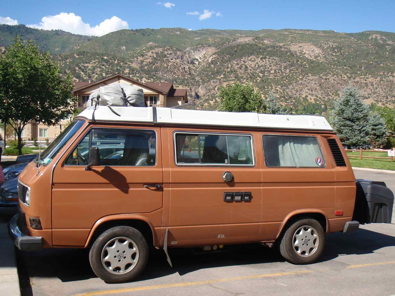

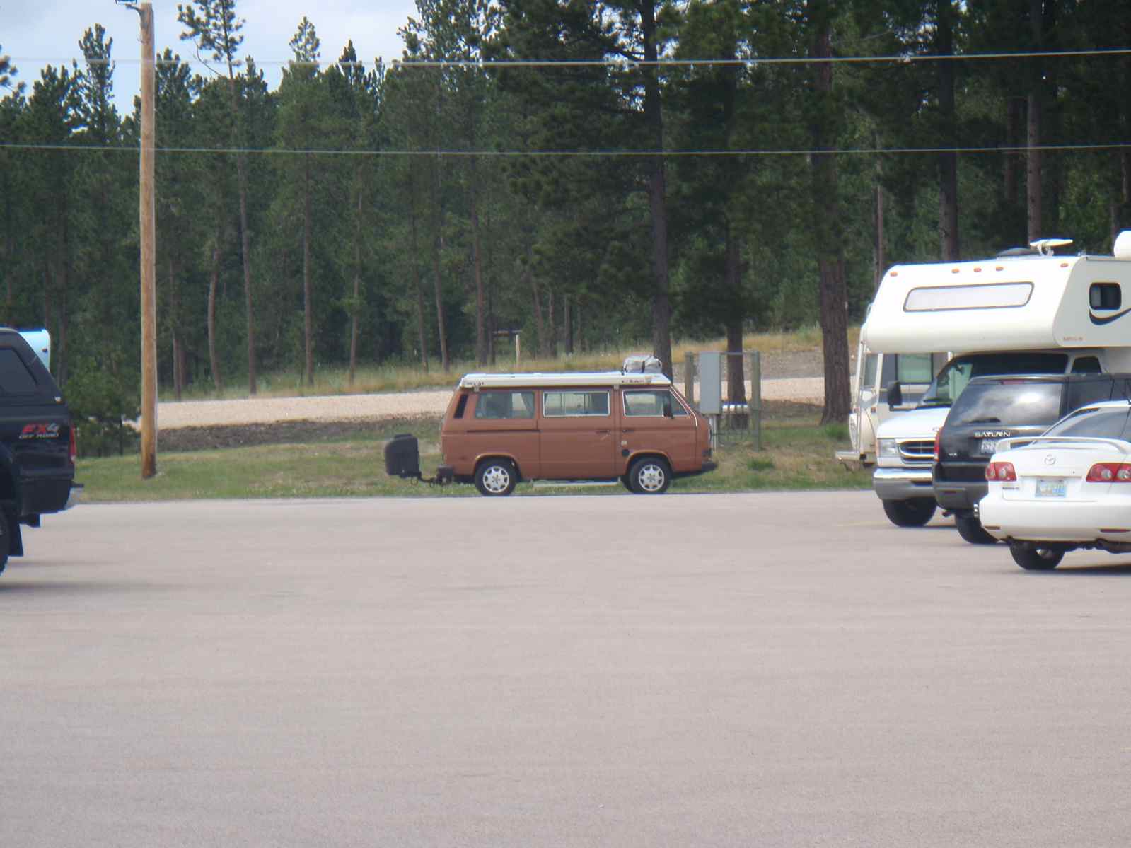

I have one and the only complaint i have is in steep enough drive ways or any other incline it'll scrap off the ground. I'm using a toe loop hitch. We went cross country last august for the whole month and I dropped the coin for one of these http://www.stowaway2.com/product.aspx?id=81&cid=57
it was was pricey sure but it worked flawlessly. Lockable, waterproof, brake lights, plate light, and it swings out of the way to get the hatch open. enough coolers on the other hitch attachment and I don't think the hatch would open unless unloaded. There's also a drain plug you could prolly just fill it with beer, soda and ice and need no coolers. I apparently only took three photos of the van with the box on our trip.
