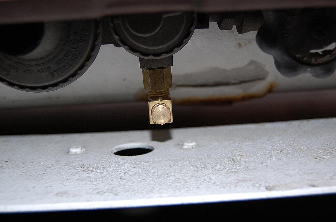

For a long time, I've been following the discussions about the 'Extend-a-Stay' propane fittings and the 'Second Chance' attachments. Those are modifications to your propane system in a Westfalia that let you supply gas to barbecues outside the van, or screw in a small canister of propane to supply your system if you've run out of gas during a camp out. I didn't like the idea of such a fitting being inside my van, and I didn't need or want to have an external tap into the system. I do my cooking inside Winston when I camp in him.
What I really wanted was the ability to screw in a cylinder if I run out suddenly. THAT has happened twice, both times at the START of a camp out, and both times, it was miserable. I decided to take Winston and my problems to:
Tim Glover
AAA Propane Sales and Rentals, Inc.
7405 W. 44th Avenue
Wheat Ridge, CO 80033
303-425-7623
I usually buy my propane at their other, nearer location at 2851 W. Hampden, but I'd been told there that the best propane man in the Denver metro area was Tim. I have a respect for propane and decided to pay for expertise in return for confidence in the modification. Tim, his wife Tammy, and their assistant could NOT have treated me better.
I was smart enough both to wait 'til Winston's system was nearly empty and to explain to Tim what I wanted, rather than saying, 'Install a Second Chance' or Extend-a-Stay.' I did have some offline photographs of what those installations look like. Once Tim understood my objective, he laughed and just pointed out that the regulator on Winston's propane system has a little test fitting on the bottom. A tap could go into that from which the whole system could be pressurized through a custom hose. Here's the tap:
and here's the hose:
The hose is just long enough for the canister to sit on the ground next to the brushguard while it runs the system. Tim had that little extra trait, besides kindness, that makes for excellence--he tested the set-up by having me light and run the stove off a 2 lb. cylinder he had on hand. It all works perfectly. Tim also went on to fill my system, with savoir faire, and the whole procedure only cost $44. Just the perfect solution to a horrible problem I worried about for far too long.
Thought you'd like to know.

Nice post. Without looking in the dark right now at Westapotamous' tap, is that a cap or a plug? I wonder if there's a quick connector or is that overkill for the number of times you might need to tap into it?

PostPosted: Thu Apr 23, 2009 8:29 pm    Post subject: That's a Plug Reply with quote
The test fitting on the bottom of the regulator fitting was open. Tim tapped into that, then put in the right-angle connector, then made my hose. The plug in the connector needs a socket and a wrench to remove it, but if you don't have a socket set of some sort in your van, you ought to.

Back to Winston's propane tank mod, does anyone know if all tanks have that same hook up potential, OEM or replacement? I like the idea of having a 1 lb backup ready, though I do carry a little backpack stove if needed.
DwarfVader
Joined: July 28, 2015
Posts: 646
Location: Missoula, MT
DwarfVader is offline
PostPosted: Tue May 24, 2016 6:21 pm    Post subject: Re: Winston Gets a Second Chance, Propane-wise (Verbose) Reply with quote
All tanks have the potential for what you want... I can't speak to whether the stock LP regulator has that valve though.
An extend-a-stay will give you what you want (a way to use 1lb canisters as backup to your primary LP...) As well as give you the ability to power other propane devices off of your primary LP tank.
To be done properly it should be installed to your tank, but that's easily done by a RV shop or propane dealer.
If you have the original rectangle regulator it does not have the test screw. What you need is a two stage regulator.
I listed the parts below from Amazon that I used and have ordered another for a friend. Remove the 1/8 brass plug from the below 2 stage regulator and install the reducing elbow and 1/4 brass plug. I also listed the parts for the hose that adapts the small gas bottle.
Have fun.
http://www.amazon.com/Camco-59333-Horizontal-Propa...+regulator
http://www.amazon.com/Anderson-Metals-Fitting-Forg...merReviews
http://www.amazon.com/Dixon-Valve-HHP2M-Brass-Fitt...ge_o02_s00
http://www.amazon.com/Mr-Heater-Throwaway-Cylinder...ge_o02_s00
http://www.amazon.com/Camco-59883-Propane-Applianc...ge_o01_s00
The 2 stage regulator is longer than the original. Remove the fittings from the old and put on the new, keeping everything in the same direction. Now the 2 pipes going into the van need to be bent to fit. It a little tight, but take your time they will go. Be careful and do not kink them.

For any of you tapping into that gauge port on the bottom of your regulators, do you know if the port is connected to the high-pressure or the low-pressure side of the regulator?
I was thinking of using this port, but then thought if it taps into the low-pressure (post-regulation) side, you'd be injecting propane at full vapor pressure into the secondary regulator....
