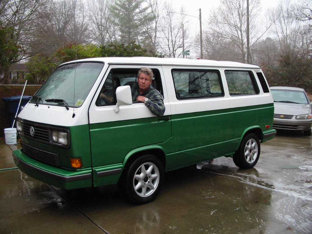

I am running 16" X 7" ET37 Mercedes rims with 215/60/16 Bridgestone Potenzas from Sams Club. 95 load rating. 1/4 inch spacers on the front wheels. You have to drill mounting holes on the rims and change to longer ball-end studs but they fit just fine. The ride is a little harsher than the standard tires, though.
https://www.thesamba.com/vw/gallery/pix/514369.jpg
