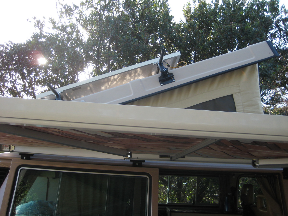

Solar runs everything
REAL happy i did not get the GW solar

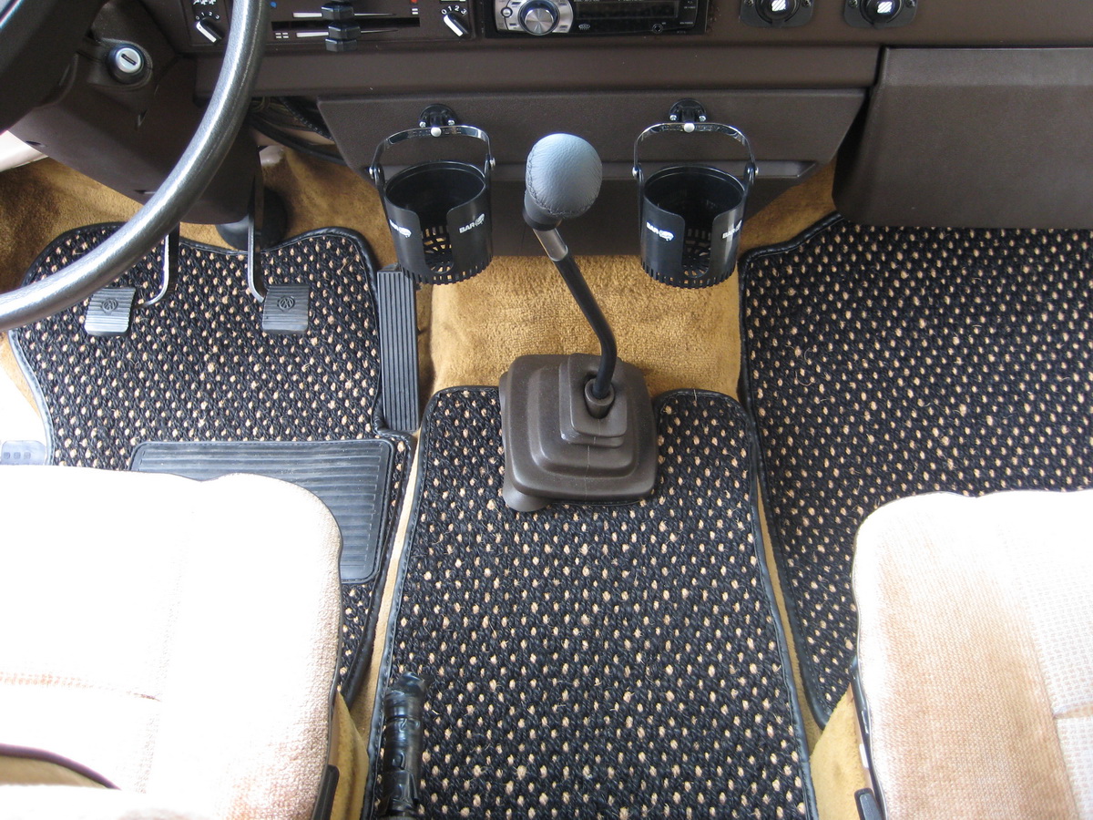

Coco Mats from http://www.cocomats.com/Custom.htm
full three piece set
The owner sent me paper templates and color samples
I doctored up the patterens and chose my color

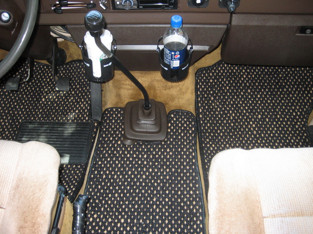

They rock, i have a set in my Grand Cherokee also

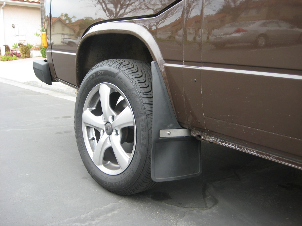

Mud Flaps Tires and Wheels
Tires = General Alimax RT 215/60 - R.16 95T
Cooper the Westy and Wilson the Westy & back of "Farang Buddha"

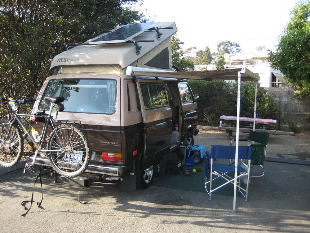

Fiamma Solar and Yakimas
Panel is Kyocera 130 watt
Yakimas are from GW

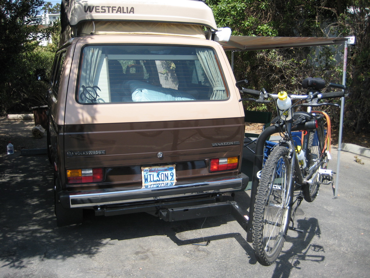

BVG XR2 Revolution Swing-Away Bike rack from RackNRoad.com
on GW bolt on hitch

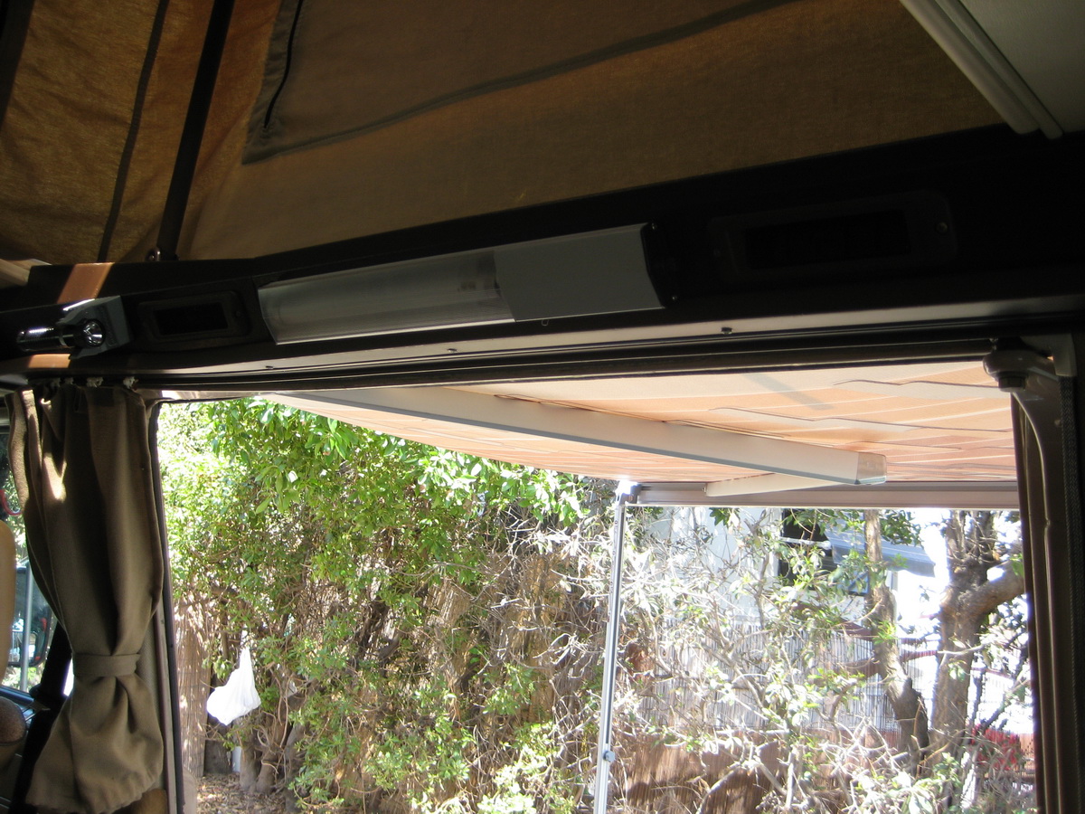

Xtra interior lights
2 florecent from GW
2 Oshram map lites
1 Streamlight hard wired flashlite ( can see in the upper right corner)

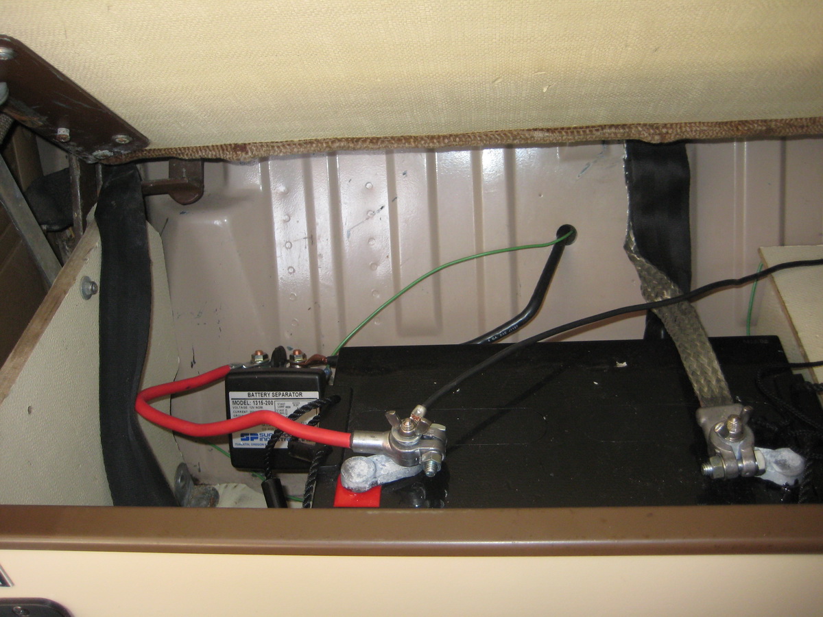

Solar meter Xtra lite and Oshram # 1
TEMP battery bank # 2 location showing Sure Power Battery combiner/seperator
(battery bank # 1 is Karls "4pac" under driver seat)
see last battery pic...

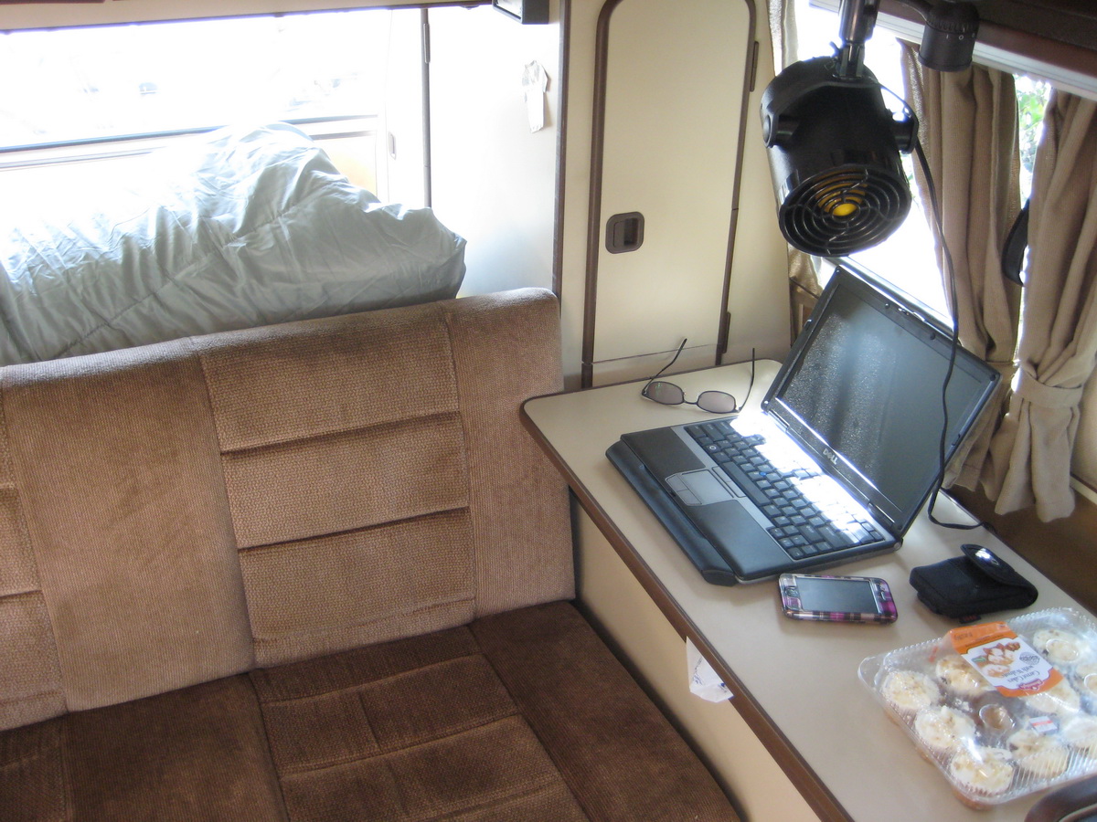

Truck Fridge and lower cabinet and carrot cake cupcakes !
AND one of FOUR 12 v outlets from West Marine
Ordered from Vengor listed on Karls site
Another 12v West marine outlet in back seat
and two more on dash, at top of photo
Turbo fan, noisy but blows ALOT
(NO, that is my Wifes I phone!)

Awesome man, in about 2 weeks ill be making a similar photofilled collauge of van porn......
Van looks dope, did you mod the front mudflap?
thanx buddy
serious porn!!
flaps came with NO instructions
I drilled the front so it would wrap with the body molding
there is one screw from the back into the flap
holding the curve
the rears i used the factory holes
i like em
i did not at first, wanted to black out the stainless
now i am down with it

Yeah they are suposed to be set back a bit like the rear.
I havent put mine on yet, wtf is up with no directions. i got the proper instruction though. I will be painting the hardware, even though its a PIA, but it'll bug me if I dont. Mad
the van is pre drilled to have front and back
flaps set back
i tweaked the fronts and defaulted on the rear

Hey man. Great pics and mods.
I've been so focused on mechanical things, I'm currently running a pretty minimal/low tech set up in terms of camping. (though it works well enough) Nice to see how things can be done right and look great.
btw. Thanks for pic on hardwired jumper connections. I was thinking of what one could install for that purpose just today. (yah. I left my lights on twice this month Rolling Eyes Laughing )

tires
I believe they are 165-60
I will ck it out
I will also post the rim specs and tire brand
