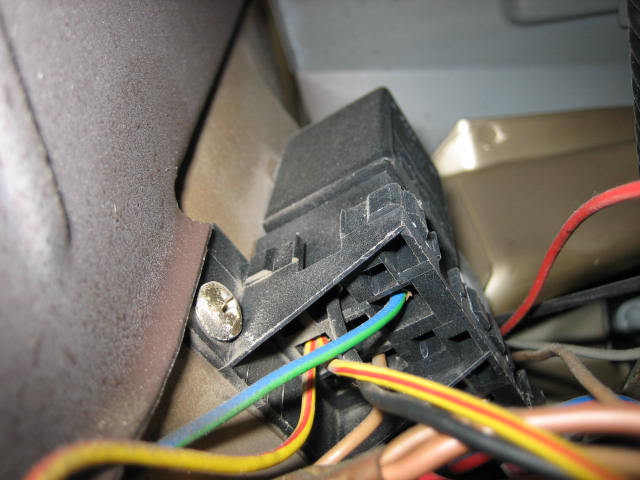

With the fuse panel dropped down and the steering column cover out of the way, the yellow and white wires (86 and later?, yellow/black and white wires for older Vanagons) need to be located. You can find these by looking at the left side of the steering column and following the sheathed wire bundle down from the turn signal/lo-high switch to where it goes under the dash. It is the sheathing that my finger is touching.
I followed this to the right side of the colum just below the dash. This is where the sheathing ends and the wires can be seen. In the picture below, the yellow and white wires can be seen coming out of the sheathing. They are the wires located half way between my hand and the steering column.
Once located, trace these wires to where they reach the back of the fuse panel. On my 89 Vanagon, the white wire went to the left side of the panel and the yellow wire went to the right side of the panel.
Now, you need to cut a couple of zip ties from the existing wire bundle to give yourself enough slack to work with the wires. In my case, I had to remove 3 zip ties. I started with the white wire, but you can start with either one as the process is the same for both.
Cut the wire, I would suggest doing this one at a time rather then cutting both at the same time. It makes it easier to ensure that you don't cross connect anything. As far as where to cut is concerned, I cut the wire about 4 inches from where it goes into the fuse panel. This gave me enough wire to work with later on.
With the wire cut, you need to strip the wire and crimp on the provided connector. I usually only strip about 1/4" of the wire because crimp on connectors aren't very deep.
I did the end of the wire from the steering column first and connected it to the wire of the same color labeled "IN" on the relay holder. Then, repeated the action on the other piece of the wire and connected it to the "OUT" wire.
Perform these steps for both the yellow and white wires. The "IN" wires on the relay holders connect to the wire from the steering column. The "OUT" wires connect to the wire going into the back of the fuse panel.
In this picture, the "IN" wire is the wire on the right, the "OUT" is on the left.

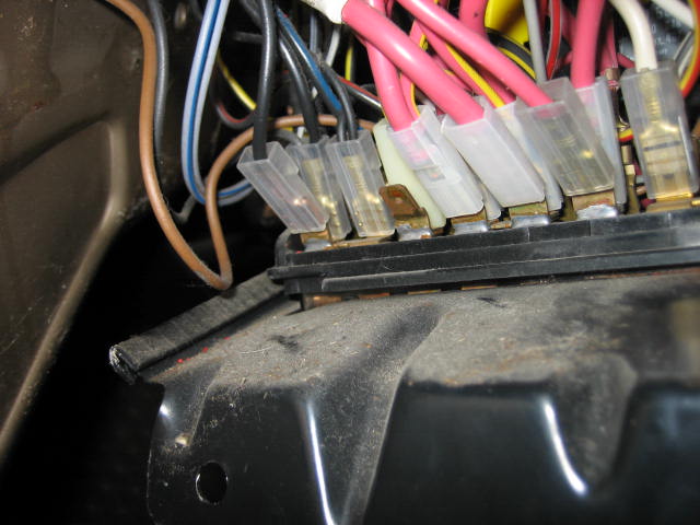

We're done with the toughest part, now we just need to connect four wires to already existing connections and attach the relays to the fuse panels.
To connect the two black ground wires, look up under the dash and towards the drivers side door for these.
Take the two black wires and connect them to two available spade terminals.
The power wires need to be connected to two available spade terminals on the back, left side of the the fuse panel.

So I am alo tryng to do the TK headlight relay upgrade. But I have an 85 westy. The fuse panel is much different and there is an additional relay panel above the grounding block.
I have only one spade connector free in the rear of the fuse panel.
My question is "Can I hook both hot wires from the relays onto the single spade connector?' (see photo below)
I am also unsure what this second relay panel is above the grounding block. Any help would be appreciated. (see photo below)

Don Hartman-I believe that relay in your second picture is for the blinking temp light.

Looking at the back of the fuse panel I have two free spade connectors. One like pictured two posts above, and another on top of the fuse panel that is part of a dual spade going to fuse #7ish.
Can I just connect two any available spades, and just upgrade a fuse if the headlights draw too many amps?
How does everyone connect to the fuse box on their early model westies?
