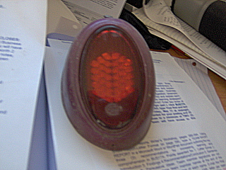

Saw these for sale in the classifieds.
I have seen the chevron style lens but not this one. Which market or years does this come from? Are they factory or safety add ons?

Swedish market

were the chevron style a euro market or country specific? Did Aussie VWs get standard snow flakes or different as well??
Were these just style changes or mandated for safety? More reflectors??

Yep, those are Swedish market lenses.
Australian market got the regular snowflakes. The only exception there was for 1961 they had a strange combined plastic taillight lense - smaller in size than later plastic lenses.

Great info! Now I know there are at least two tail light glass diffusor design... Embarassed
Does anybody have any more data about non-snowflake lights (markets, countries, aftermarkets patterns..)?

This type taillight lens is plastic, not glass. We throw them away and install glass snowflake instead.
Hella snowflake lenses come in three different script-variations.
What are chevron lenses?

Here is a pic of the chevron from the gallery. Euro market? I have seen two semaphore cars with these lights, not sure what year though.
I have seen two different Hella snowflakes, one with a K partnumber on the bottom with the hella logo and a later version with more numbers that "wrap around" both sides of the top of the lens.
There are hassia snowflakes as well.
As far as diffusers (the plastic on the inside that makes the color a deep blood red) I have seen two types as well. One with dots and another with horizontal lines. I usually take them out to make the brake lights as bright as possible.
Anyone know which diffusers go to what year or type?

There is also a smooth "diffuser"-plastic lens of the same (or atleast similar) material as the plastic used in heart taillights and earlier.
The smooth type is the earliest and goes with the Hella-logo-only lens (no wave or K1564, till late 1955/early 1956) and probably the very first of the wave+K1564 lenses.
The diffusers with the horizontal lines goes with most of the wave+K1564 lenses end the lenses with text wrapped around along the edge of the lens (late 1960 to april 1961).
The diffusers with the dots, I'm not sure but I think they came with the latest of the swedish taillights? Or could be some later (mid 60's) spare part diffuser? At least my late 1960 model still had the horizontal lines diffuser.

The diffusers with the dots, I'm not sure but I think they came with the latest of the swedish taillights? Or could be some later (mid 60's) spare part diffuser? At least my late 1960 model still had the horizontal lines diffuser.Ken.
Makes sense, the dot diffusers I had were from a NOS replacement set with the late 60-61 type glass lenses. I wish I had not thrown them away Crying or Very sad

Actually, I just found 3 different smooth diffusers, the one on the left is much more soft in the edges/pressings, maybe that's just because it has been warm, I don't know.

I forgot about the pink ones, I had a reproduction set of snowflakes from KDF back in the late 80s and they had the flimsy diffuser. It actually melted from the heat of the bulb!! I ended up taking them out as well.

Are these not M18 "larger reflector for taillights"?
