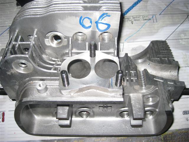

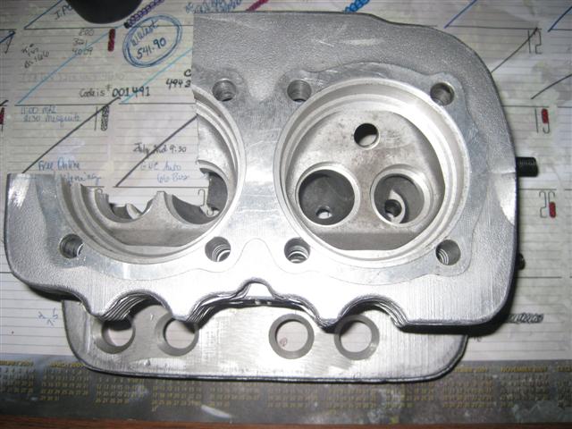

I am planning to to some port and valve work on the new ones when they come in for my 36 hp challange engine and was lucky enough to borrow this to see how far I can go.

Me and Tom Bruch talking the fundalmentals of Vintage speed in front of my Judson engine with the cut-a-way WW Okrassa head, can't wait to get it on a flow bench (not the cut-a-way) to see how it compares to Tom's Brukassa heads numbers.

Today we started playing with valve size, we could go big but I do not want to weld the head, what we do anybody will be able to do with-out spending big bucks. It looks like we can go approx 37 intake and 32 exhuast with-out welding. Porting will be limited also as to the lack of meat, but the intake ports have a nice line and there's room to clean up the exhuast, so we'll make them flow better. Damn I wish I had the real things allready. We're ready to go to work.
