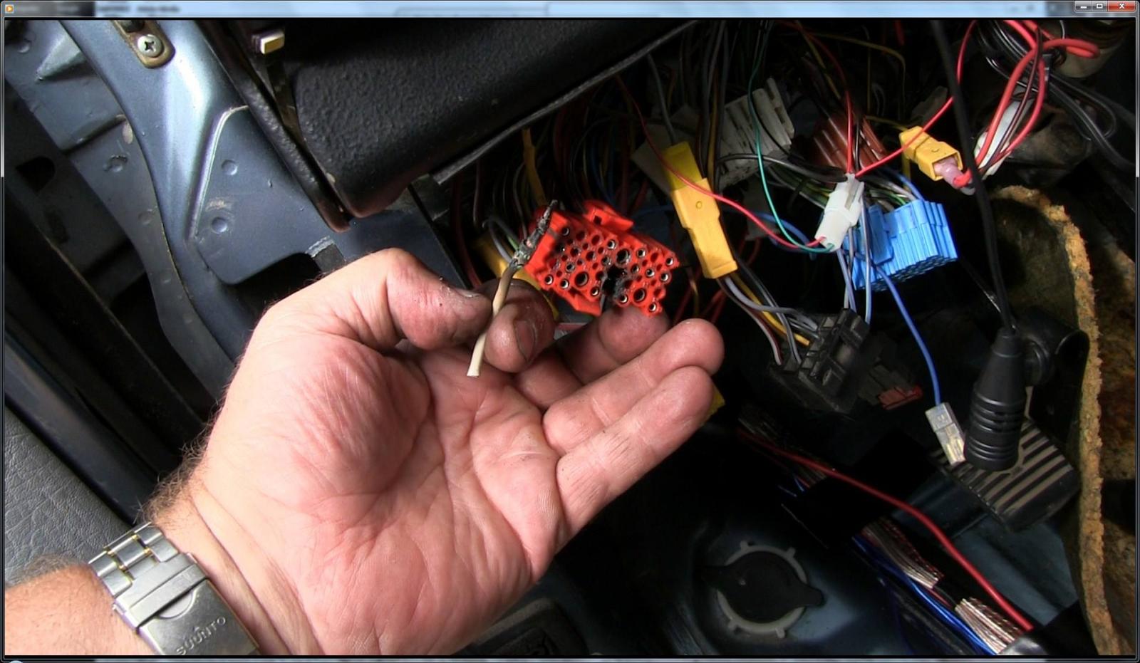

Ok. Little back story. Last weekend we made a long drive with the high beams on and I brushed my hand across the fuse box cover and noticed it was warm. I popped the cover off and the two high beam fuses were extremely hot. The plastic part of the fuses were partly melted. The rest of the trip I didn’t use them.
So this weekend I did a little investigating and this is what I found. Plug B on the back of the panel certainly showed evidence of heat at one of the big no.22 connector. Also there is a wire that comes off the back of that plug that goes up to another connector that the wire insulation was melted. Any guesses of what this little connector is for? The melted wire/insulation appears like it could be old as the wire looks a little corroded too.
Questions... is this a common vanagon issue? Could I just clean up the one connector on plug B, add a little dielectric grease and plug back in? Any guidance of what that little connector is?

Pin B22 is after the added relays so it carries full high beam amps and the relays don't help with that weakness.
Run reasonable wattage bulbs or risk burning out wiring etc. I have seen that pin damaged before as well as other parts of the wiring path leading to the high beams.

The relays can be helpful in all vans, reducing the load on some switches that commonly burn out even with stock bulbs.
There is a better way to do this for high wattage bulbs but not with an existing kit. I wish Jay would make one.
Here is a photo from the gallery of another melted B22.

That entire connector needs to be removed and replaced in kind or clipped and tAgged with documentation so that you/next owner can troubleshoot the next failure.

Far more vans get damage to the parts the relay kit DOES bypass and that is why we have the relay kits. It doesn't bypass everything and some vans still get damage.

Your underlying assumption is mistaken. The relay kits weren't designed to take the load out of the fuse box. The kits were designed to remove the main load from the much more failure prone ignition switch and headlight switches. The relay kits do this very effectively. Even vans with stock bulbs suffer from these switch failures but upgraded vans more so.
You can die from a head wound while wearing a bullet proof vest but that doesn't make bullet proof vests useless at all.

There are 4 headlight fuses in the panel, 2 for high left and right and 2 for low beams left and right.
Lets talk about just the highs since that is the problem area.
High beam power comes into the panel on B22, splits into 2 paths and each path get a fuse. Then each fused path has a wire out, a left side high beam wire and a right side high beam wire.
Fuse #9 = right side highs out on fuse panel pin C16 and wire is white with black stripe (also out pin A28 wire for dash high beam indicator)
Fuse #10 = left side highs out on fuse panel pin C17 and wire is white
So of course you can bypass the stock fuse panel completely but you need to split the relay output wire that used to feed B22 into 2 paths left/right and add fuses. Then also connect one of them to the wire for the dash led for high beam indicator.
(for vans that don't yet have serious damage to the stock fuse panel there are better ways than above)

For pre '86 Vanagons, buy fuses that have brass contacts verses zinc ones and you will have less corrosion and thus a better contact between the fuses and the contacts on the fuse box. Also use dielectric grease on the ends of the fuses. For the high speed fan circuit using a modern spade style fuse in an line fuse holder is a good idea, but be sure your crimps are A-1.
MarkWard
Joined: February 09, 2005
Posts: 18684
MarkWard is offline
PostPosted: Mon Nov 06, 2017 1:05 pm    Post subject: Re: Fuse box worries. Things melting Reply with quote
Never was a fan of the sandwich style fuse boxes. I was surprised to learn that the headlight relay kits only took the load off of the head light switch. I would have thought the kits would have included moving the load lead to a better suited location too.
