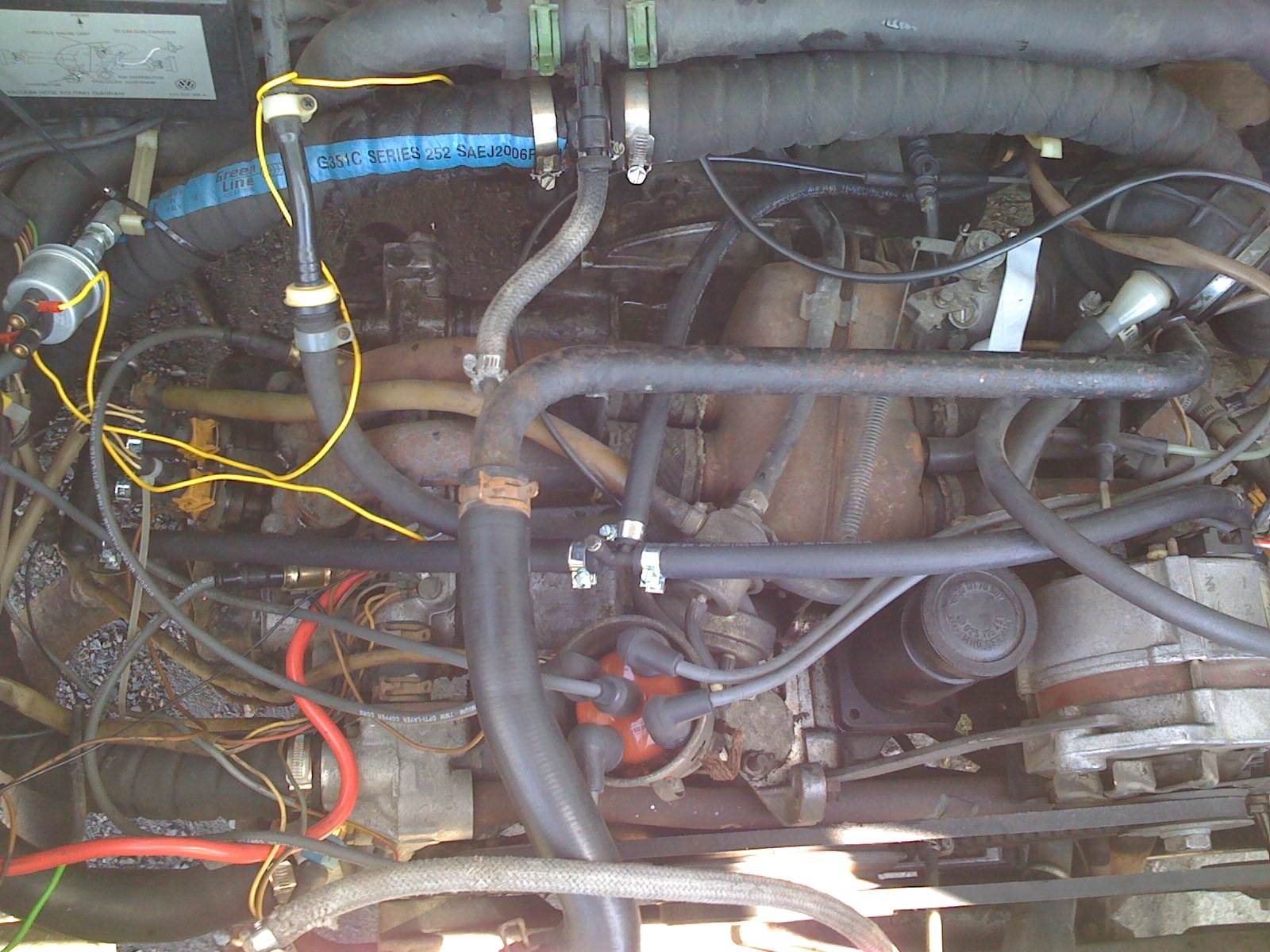

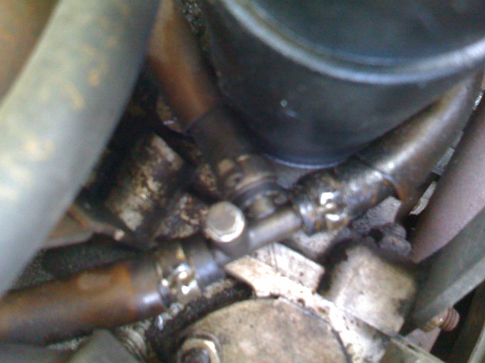

1990 VW Vanagon 2.1L 4-Speed Manual - Won't Start!?!?
Ok after searching some of the archives and checking a few things out I came across this. It is on the Air Cleaner Intake and looks a little worn in the area shown. Is it OK or should I replace it? please see image....
And...
Mark, what did you mean tiny bolt... where?!?!?

that tiny bolt. fuel should squirt out. you can also attach a fuel pressure gauge there.

after you replace the fuel lines it will look like this
if you don't , it might end up like this . . .

So as suggested before, I checked the pressure test port. Now it was stated that I should undo the nut and see if the fuel squirted out while turning the key... Well I loosened the bolt and it bubbled for a few seconds and then gas started POURING out. In my mind flashed the picture posted earlier and tightened it quickly. Should it be shooting out of the test port, because I expected a little leakage but not the amount that came out.
Also I still don't know if the oil light (pressure switches) would make it not start.
The picture of the part is it worn should I replace it?
