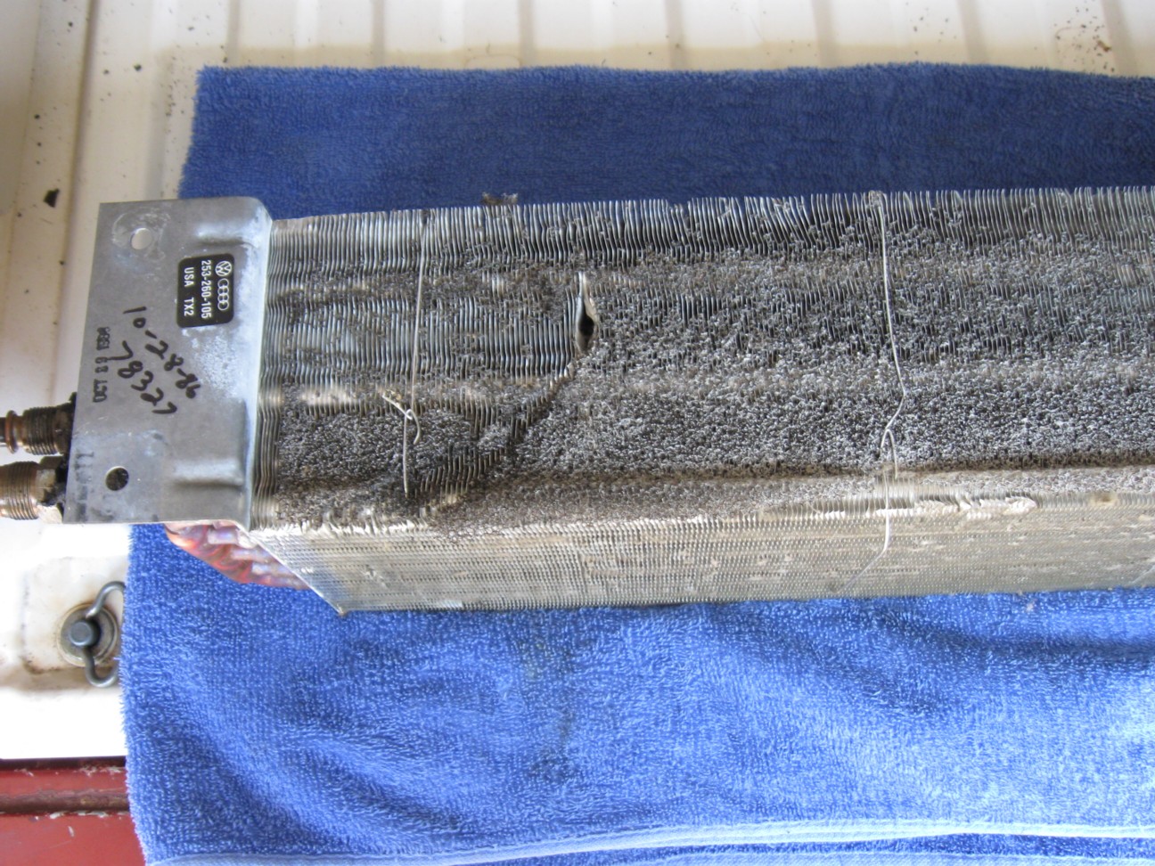

Decided to do the hardest job first and dropped the rear box to clean the evaporator and blowers and to remove the Expansion Valve. Hardest part was the rear brackets, but removing the speakers gave me room by working thru the speaker holes.
Intake (rear) view of the evaporator. Most of the rotten foam was gone. I managed to break one of the drain ends (on the right side).
Front side (inside the back seat) view of the evaporator. The arrows point to the wire used to tie on the rotten and gone filter.

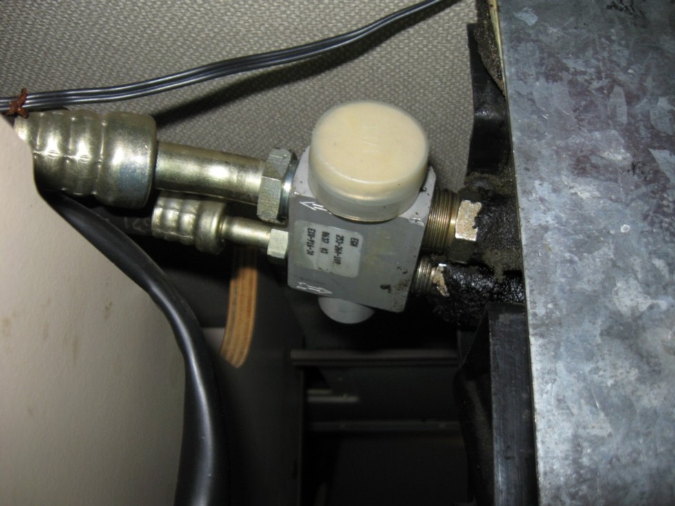

The expansion valve.
Closeup of expansion valve with evaporator lines disconnected.

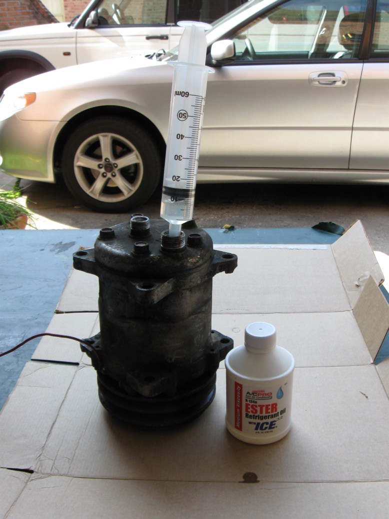

Got about 5 hrs of work on the van today. Started with the compressor.
Ran about 5 shots of Ester oil thru the suction side of the compressor to see what's in it.
Here's how I spun it to get the oil and crud to discharge.
First discharge of dirty oil/crud.

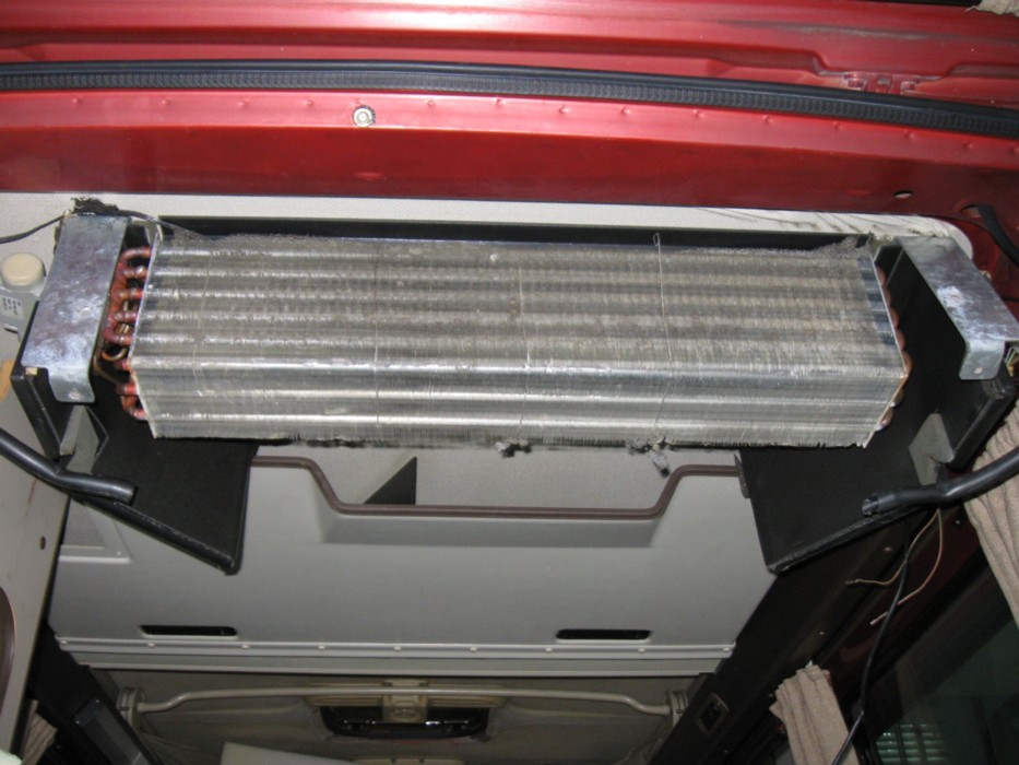

Found lots of rotten foam on the roof side of the evaporator.
Vacumed the foam and then used Simple Green and lots of water to clean the outside of the evaporator being careful to stay away from the fittings. I couldn't find TK's brake line cleaner on Friday night, but I bought a quart of AC system cleaner for $14. Too high but I wanted to work some today. Used another big siringe to put 2 full loads about four times thru the evaporator. Let it sit for 10 minutes as recommended on the bottle. Straightened some cooling fins while I was waiting. Compressed air to blow out the cleaner.
First load.
The last load looked much cleaner, but I'm going to run a bottle of brake line cleaner later when I find it. Am going to try to reuse the evaporator. Looks like it's about $350 to replace.

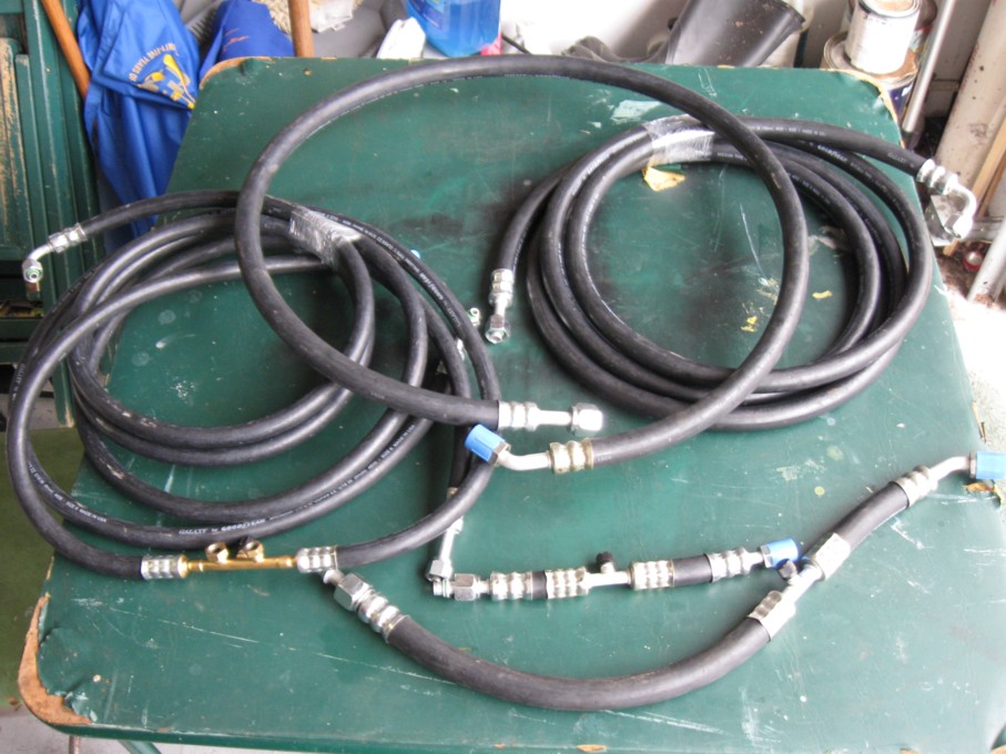

Decided to finish the day's work by pulling the two main lines to the front condensor and removed the dryer. Hard job to pull the hoses.
The hoses ready to go to local business to have them duplicated.
The smaller hose was pretty dry rotted. Time to buy some parts.

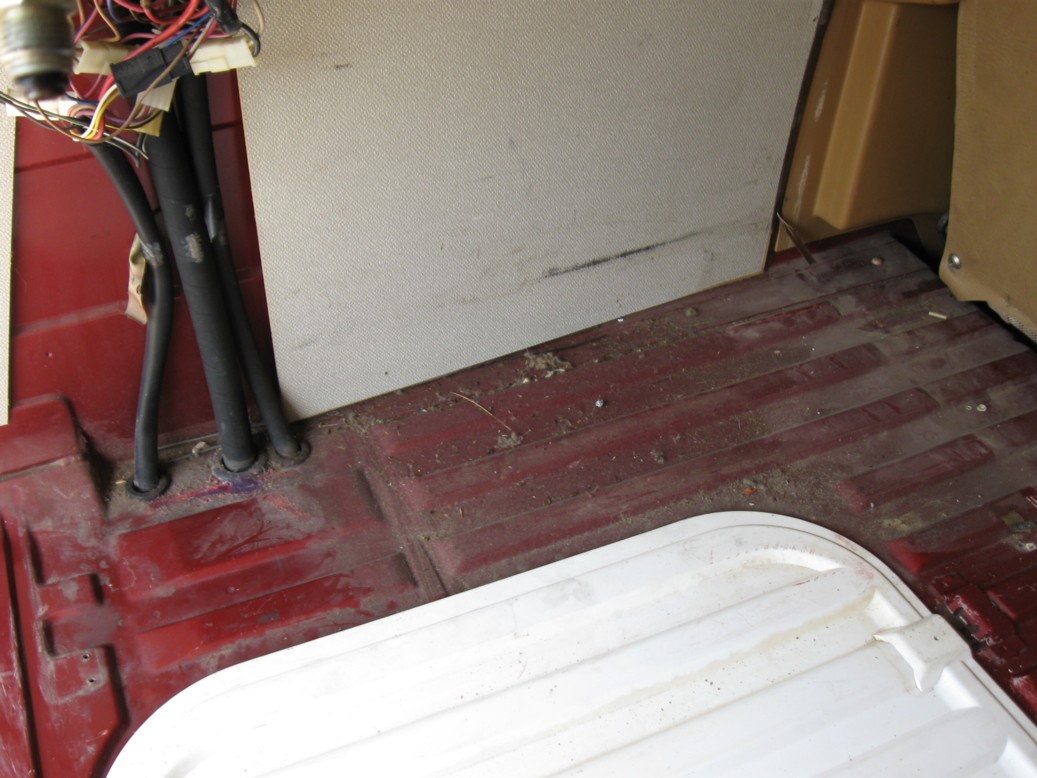

Pulled the interior lines Sunday. There are fewer total lines than I expected. Five total including the connector piece on the end of the line from the evaporator to the compressor.
Took the old lines to the local hose supplier and ordered a replacement set made in barrier hose. They expect the hoses to be ready by Wed. Estimated about $200 for the full set with new fittings unless there is a size they don't have in stock, they will re-use the old fitting.
For those curious, I checked the size of the line connections on my system so you know what size large open end wrenches you will need for this project.
The large long hose to the front condensor has 22mm on both ends.
The small long hose from the condensor back to the receiver/drier has 19mm on both ends.
The large evaporator fitting is 24mm.
The small evaporator fitting is 17mm.
The short piece of hose that attached on the end of the hose from the evaporator to the discharge side of the compressor is 27mm on one end and 22mm on the other.
I think that's all the fittings.

Hoses were ready this afternoon--right on schedule. $251.28 including tax. That's all new fittings and they even installed o-rings. They said all the fittings were standard, not metric so no problem on replacing all the fittings.
Mounted the evaporator with brackets back on the roof. Carefully wrapped the ends of the evaporator lines to run them down into the engine compartment and pre-installed them. The rubber grommets the hoses run thru the body were in pretty good shape so I lubed them and reused 'em.

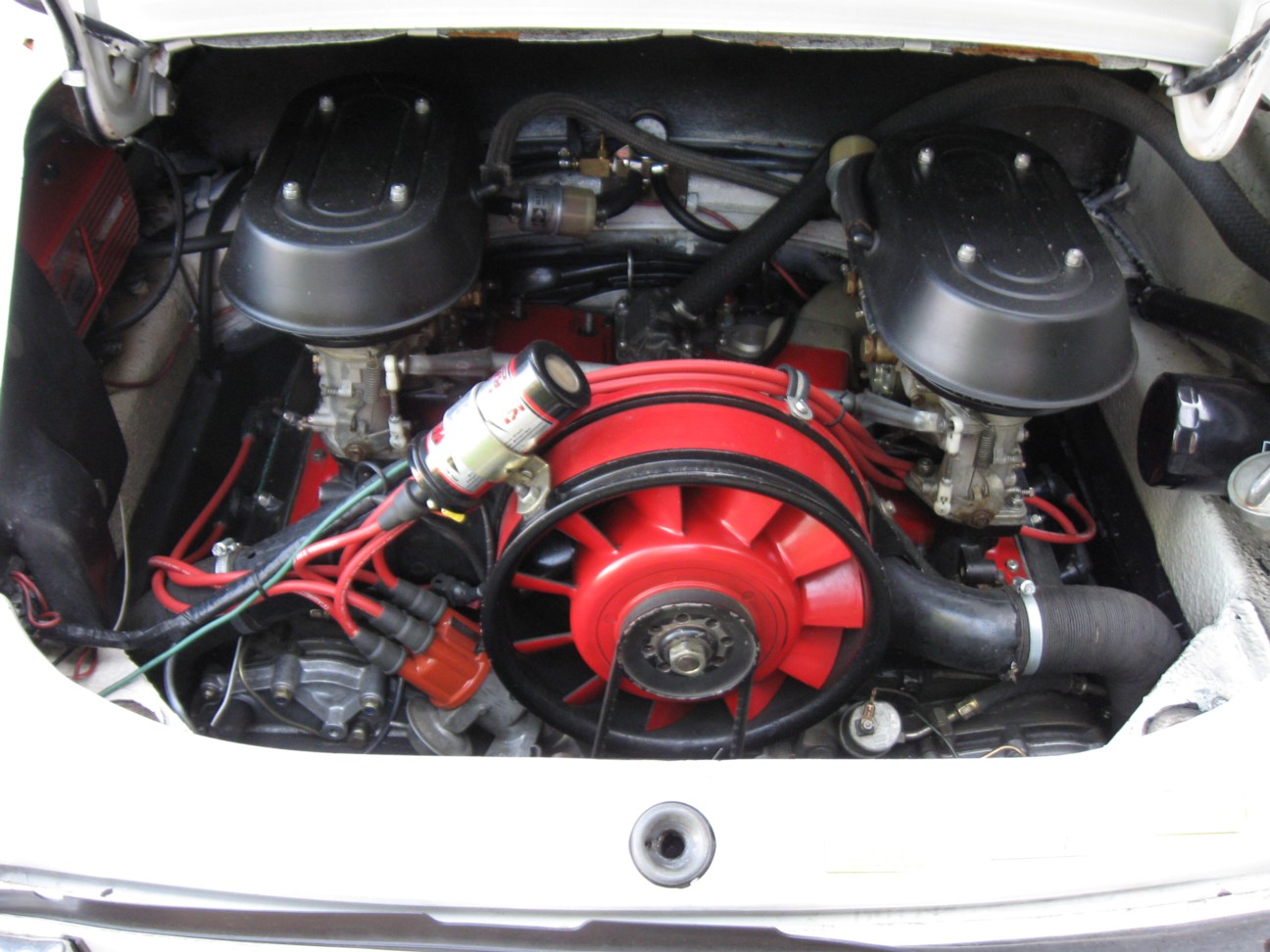

So we got the 356 engine installed Saturday.
Carbs and engine sheet metal installed after this photo. Waiting on gaskets to install exhaust and re-built fuel pump.
The car getting it's engine re-installed. Note the VW theme of my son's garage.
His other 356--a 59 Coupe.
Might as well add a photo of my 71 911E Sunroof. If this A/C rehab is successful, I'm planning on re-installing A/C in the 911. The body was cut for the A/C lines so I won't be cutting up such a nice early car. Planning on using an update kit that includes all new barrier lines, new upgraded evaporator and new modern wheelwell condensors.
And engine.

Worked a few hrs. Sunday afternoon. The new hose must have had a burr in the threads of the fitting for the low pressure switch so I bought a tap and die and finally got the switch installed. That meant I could stick the rear side cabinet back in, install the evaporator and the expansion valve.

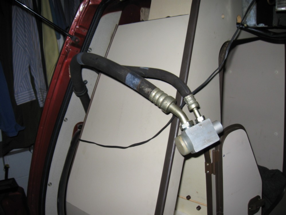

The EV was tough to install. If I did it over and with the new hoses, I would install the EV to the evaporator and then to the hoses on the workbench and then thread the hoses behind the cabinet. Not a lot of room to work in place with the cabinet in.
My Behr receiver/dryer is not marked. I'm assuming the top fitting is the line coming from the evaporator and the bottom fitting goes to the front condensor. That's what the drawing in Bentley looks like. The old R/D had a straight T fitting.

Great "How To" please go into detail on how to do the suck down test and charging. I replaced my receiver dryer and expansion valve. now need to do the suck down test and charge. I am hoping not to have to do all the lines like you did, but might just have to plus the compressor if mine doesn't work.
How do you check the compressor oil level?

If you look at the photo of the new compressor, there is a fitting on the left center of the compressor. Remove, drain shipping oil (or old oil in an existing compressor) and refill with 8oz of Ester oil. I'm using a measured syringe and squirting it in.
If you are re-using a compressor, I would perform the flushing job using Ester oil putting it in the suction side. Spin the compressor and it pumps out the crude inside.

Managed to work on the AC tonight. I installed the new compressor last week and started to hook up the new hoses and realized I had the wrong fittings on the compressor. Called the AC guy and he deduced that I really did need a compressor with two screw ends to hook to my two hoses ends--not a GM style fitting that slides in and is held on with one bolt in the center.
They sent the correct compressor and now I get to send back the wrong one for credit. Got it hooked up tonight with 8 oz. of Ester oil in the compressor and 2 oz in the suction hose.
Ran a suction for 1 1/2 hrs. with the Harbor Freight suction pump and my Sears air compressor. Basically, hooked the low pressure gauge line to the suction side and the high pressure gauge line to the high side. Opened both gauge valves and had the center hose hooked to the suction device and it is hooked to the air compressor.
I have 25 hgs. of suction showing on my low pressure gauge. A check in the morning to see if there is a drop of pressure. I can't charge the system until sometime next week as I'm gone all weekend . . . but I'm getting closer.
