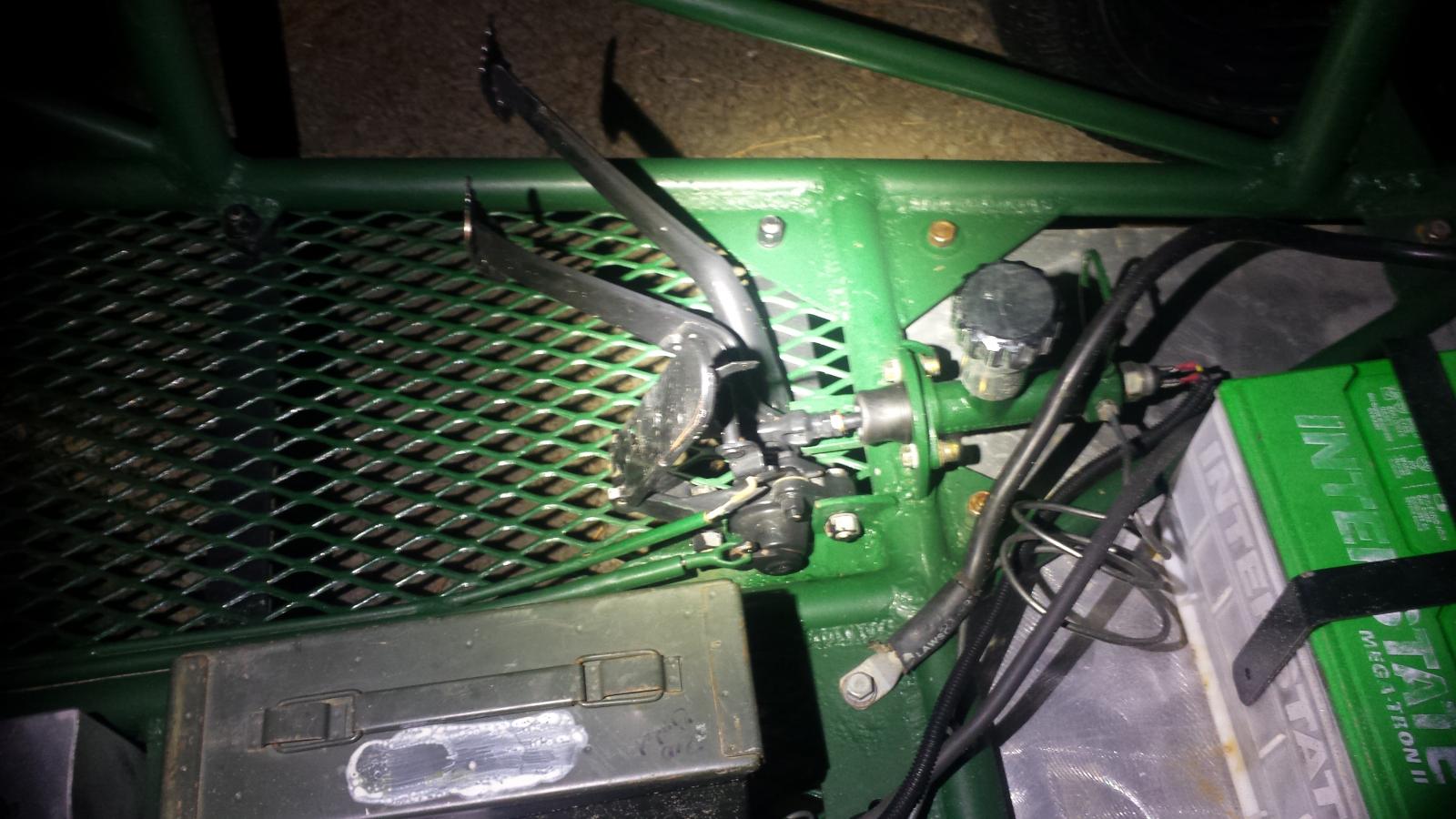

OK so I know there are some similar discussions close to my question but I Couldnt find one exactly what my problem is.. so on my rail I have just rear drum brakes all new all the way around don't remember the size of the master cylinder but it's a Varga Brazilian one and Jamar dual handle cutting brakes the brakes work OK the pedal is stiff but it stI'll locks up the tires if you stand on it but the turning brakes are spongy as crap unless I push on the brake pedal and pull up on the handle then they are stiff and work awesome so any thoughts on do I need a residual valve or two of them after the cutters before the wheel cylinders any advice is appreciated

Ya that makes perfect sense thanks allot man I would agree we have the same exact symptoms now just a thought I was having I don't know what kind of reservoir you have but I have some stupid Lil chrome one (I will put a picture) if you filled it to the brim would there be no room for fluid to back feed into the reservoir then just put the pressure on the cap ??? I think I will try Just because I think I will also order a pressure valve to try and yes I agree very ridiculous I just got back from the dunes and it was a pita to remember to pump up the brakes every time I went for the turning brake it would be nice if they were just pumped up every time I needed them
