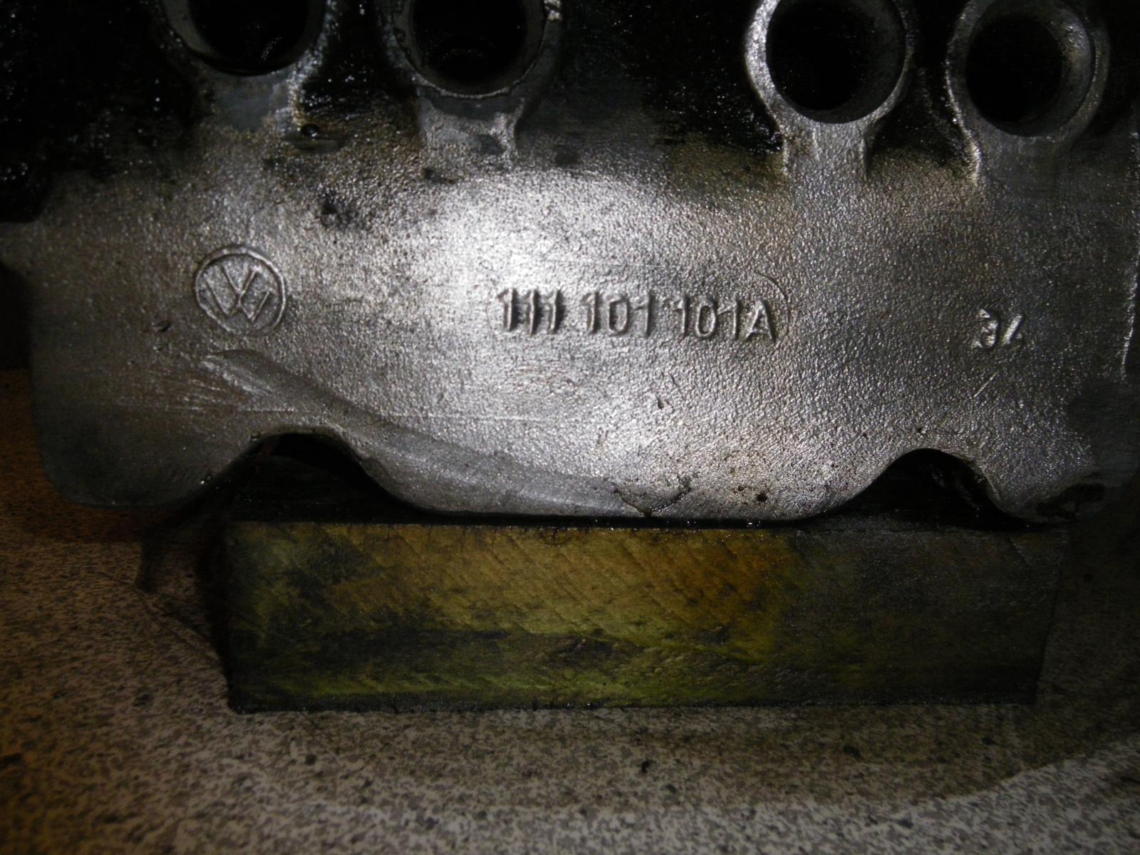

Eng Nr 1550496
Chassis Nr 1-0104330
Nr 110426

Engine: Sept 1956 (1957 model year--brain fart corrected). it may be a restamp, as the fat (1956-61) numbers were already in use.
Chassis: May 1949
Where is "-110426" located? I suspect it is the matching frame number for the May 1949 chassis.

pic #1 - engine September 1956
Where are pic #2 & 3 located on the vehicle?

Photo Nr 1...the hp / cc of the engine?
Photo Nr 2 is between the two front seats, next to the handbrake.
Photo Nr 3 is under the rear seat, on the hump.
No.
1550496 is the serial number of the engine. If you look at this chart http://www.thesamba.com/vw/archives/info/bugchassisdating.php you will see that the last engine in August `56 was serial # 1 533 485. The last engine in September `56 was serial # 1 569 111. Your engine falls between these two numbers.

I am going to say factory rebuild (kD) engine as it has no dash (-) before the 1 and between the 1 and 5 or at the end does it have any stamps on the other sides of the generator stand

These are the only numbers that the engine block has.
To the right of the engine number is a small 45
Floating around the middle is a small upside down 5
Near the bottom is a large 51
