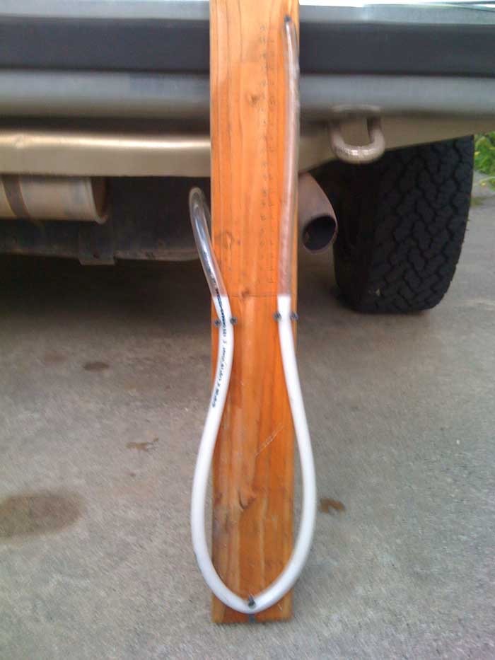

Jon_slider
Joined: April 11, 2007
Posts: 5091
Location: Santa Cruz, Crowdifornia
Jon_slider is offline
PostPosted: Fri Apr 17, 2009 7:44 pm    Post subject: Reply with quote
Thanks Karl!
your manometer picture inspired me to take the plunge
I made a Milk filled Manometer Smile
and set my pressure to 14 water collumn inches
Thanks to everyone for the support.
Now if anybody wants help setting their pressure I will be happy to help Smile
Testing at Sea Level shows the Propex is reliable on the first try, every time.
I will update after I get back to altitude.. which will be after SDM..
Outback Kampers
Joined: December 29, 2004
Posts: 2345
Location: Oregon Outback
Outback Kampers is offline
PostPosted: Fri Apr 17, 2009 8:23 pm    Post subject: Reply with quote
Jon_slider wrote:
Thanks Karl!
and set my pressure to 14 water column inches
Hehe....Jon, is that merely white water or really milk? I suspect 'milk column inches' might not be exactly the same as water column inches, as milk might be slightly heavier/lighter than water. I sometimes use food coloring in the water of mine.

PostPosted: Fri Apr 17, 2009 9:05 pm    Post subject: Reply with quote
mostly water, with a little half and half for food coloring Smile
tip of the day.. I spent a lot of time at the hardware store looking for a threaded fitting to match my regulator output nipple for my fridge propane line..
it would have been much simpler if I had just bought hose with a larger enough inner diameter and just push fit it to the nipple.. I used half inch ID hose, it was too tight.. dont know the best size to use for a push fit, but bigger than half inch.. glad thats over
if anybody wants to use my milkometer at SDM, let me know and I will bring it along..

PostPosted: Sat Apr 18, 2009 10:34 am    Post subject: Reply with quote
There ya go, Jon, now at least you're doing it right.
My post above was to stress that no one should go screwing around with the gas pressure regulator by trial and error. No, they are not delicate precision instruments, I've been inside regulators both brand new and 70 years old and they're all about the same, much like the very simple fuel pressure regs we have on our cars. Not rocket science, and not hard to do adjustments properly. I just wanted to point out, for safety's sake, why you should not play around with it until you know what you are doing, that's all.
I've been given exactly the same warnings by professionals who have made their careers working with this equipment, so I was just passing along good advice for the layperson.
