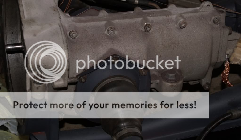

Hello
I have this 1200cc engine ... would be grateful if someone could tell me the specific production date based on the engine number in the pic? is it a 40hp?
engine has a 009 fitted and Solex 30 pict-2 .... but I would like to find out what the stock set up was on this engine
Thank you
Andy

Take a look here:
http://www.thesamba.com/vw/archives/info/chassisdating.php
It looks like it's a 65 1200cc 40 horse.

thank you for the replies - its a rebuilt Vege engine, which might explain the over stamped letter/digit at the start of the engine id code - my understanding is that bolt on generator tower would mean 40hp? Its 6 volt.
Anyone know if vege keep a record of their rebuilt engine?

Well, Vege hasn't done 1200 engines that I know of, at least not for a long time. I've never seen one and back the mid 90s when I was mechanic they were not in the Vege catalog.
Are you sure it's a VEGE? - they use a riveted tag over the original number, and I don't see any rivet holes on this. The stamped letter, well, by the time that VW put a letter in front of the serial number it was the D seires. I don't see a D in that mangled letter.
What manifiold do you have?
Oh, and personally, I do not find that chart to be very helpful. It's just too vague and general. (And sloppy - HS?? No such thing either, typo, they mean H5) The VIN chart on theSamba is much better as is this one:

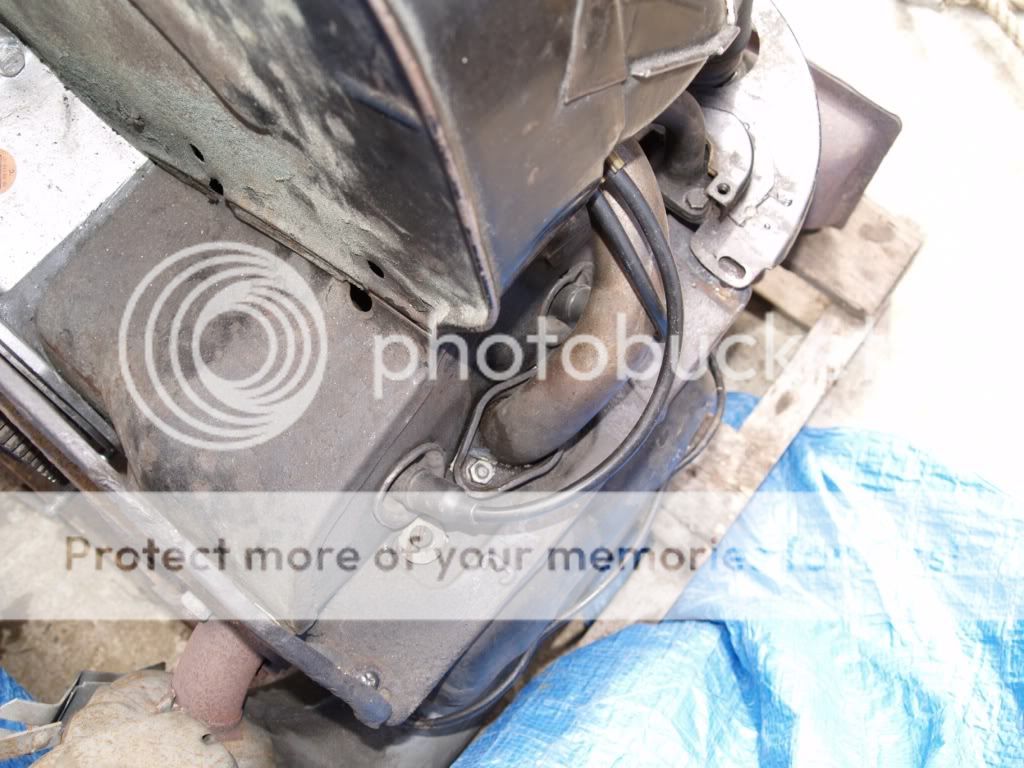

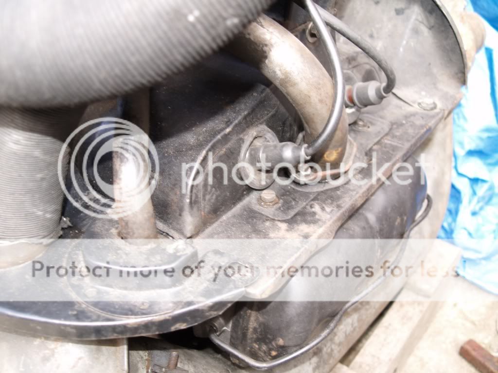

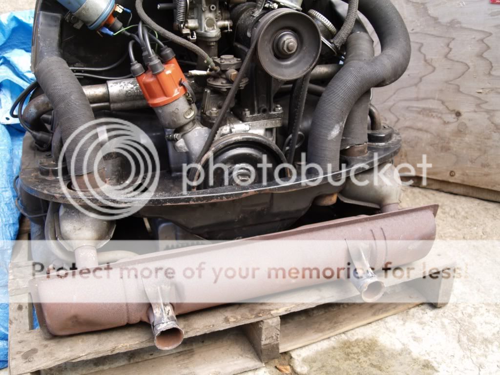

Hi heres a few pics of the engine ... what you think looks like single port 1300-1600 manifold?
I want to mount the engine here with 1950s box until i get my other engine sorted ....

I may be way off here, but that looks like a type 3 engine that has been modified to type 1 configuration, just by looking at the oil pressure switch and how the tinwork is not correct Rolling Eyes
Good eye I must say. Yes why is the oil pressure switch mounted vertically??? Im not familiar with type 3 engines but maybe they have this configuration.
I was thinking on the lines of an E series 1300cc engine. Why the preceding alphabet has been overwritten, beats me....
IMHO, all the lists I have seen having the engine number codes have limitations. The list shown above does not list quite a few other codes. E series engines are very common in Pakistan. These were more common than the F series 1300s. The E ones had a lower power output and perhaps were designed to run on inferior gasoline with a lower compression ratio.
Any other Idea s people???

interesting thank you ... I had another look round the engine and so some more information .... one head is stamped 211.101.373 and other is 311.101.373A
Also, low down on the side of the engine block it is stamped
40 vw 000.101.102A and on other side of the block it is stamped
23 vw 000.001.101A
any info much appreciated
thanks
Andy

Judging from the tables and pics then it must be a rebuilt E series 1300cc engine ...anyone else got any ideas or info on this engine type?

I don't think it's an E or an L block though, they didn't make no 800,000+ of them. I think an F or an H block would have been most likely for that, then someone stamped over it with an E maybe? I think some H series blocks did come with the oil switch pointing up like yours is, even on type 1s. A type 3 engine would not have had its number stamped where yours is.
With the mismatched later heads on there I'm going to guess it's now just your normal run of the mill 1600SP. I'd probably take it down to the block and inspect it anyway.
Again, was there a reason you thought it was a Vege engine?

T3's have the oil pressure switch on the oil cooler -- and In case it matters, my 1600 DP in my ghia, the longblock built by VW paradise, has the oil pressure switch mounted in exactly the same way. I don't know the casting number off the top of my head but I've seen several upright engines configured that way -- I don't see how it's at all "weird"
