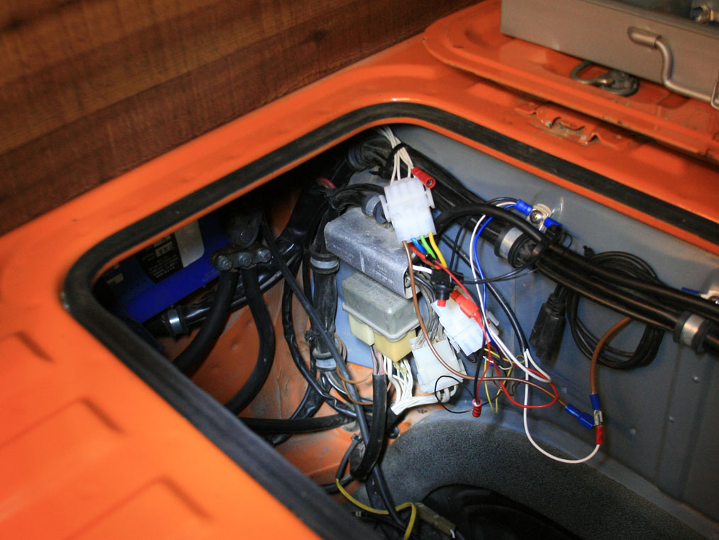

Just a small update. Been working on wiring for the Megasquirt and removing the Amsterdam - Beijing stickering.
Old spare ECU is being converted to connect the Ljet system to the megasquirt.
Madmax78 wrote:
I'm planning to run the MegaSquirt parallel to the L-jet, so if the MS would fail I can just pull the L-jet plug from the adapter box and plug it back into the L-jet computer and off we go.
Sure, add a few wires here and there

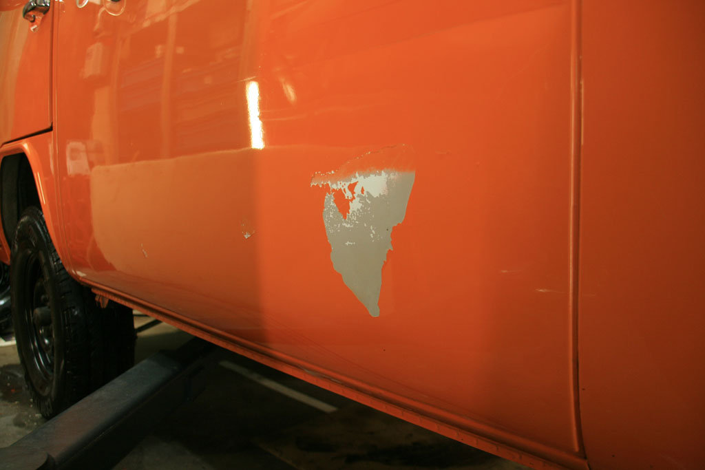

The old Amsterdam - Beijing stickers removed. After a proper rinse and wax-on wax-off shines like never before. Orange Trophy Amsterdam - Cape Town outings will be applied next week
Stickers removed, and then some... Rolling Eyes

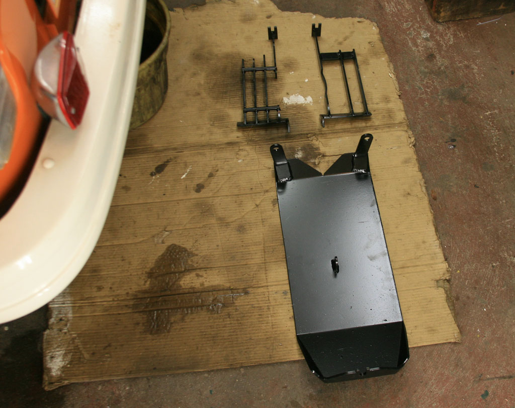

Transmission and sump skid plates as per VAG Ratgeber for 091 transmission and type IV. According to the blueprints supplied by VW in 1984. 4mm steel protection still allowing for airflow.

Looking good guys! That tranny skid plate looks way cool...

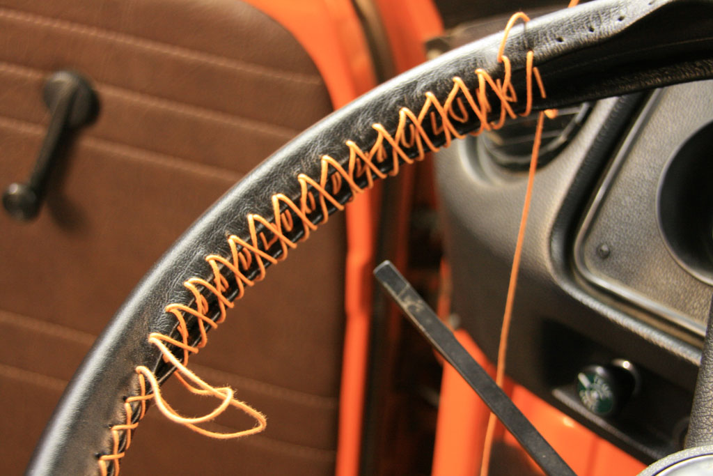

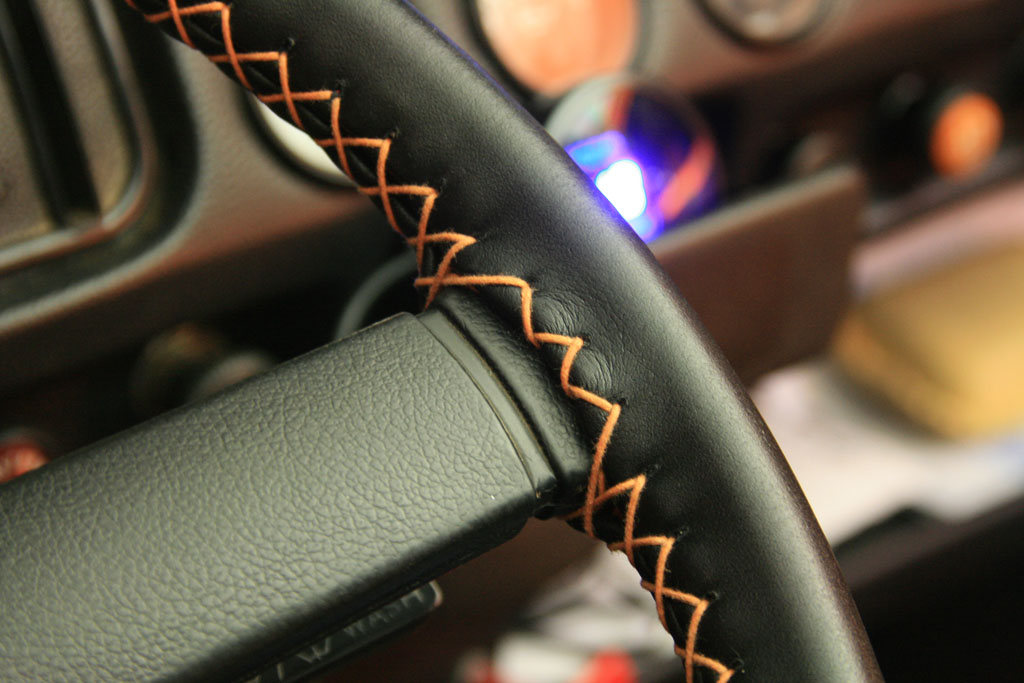

Wheelskin steering wheel cover, cross-stitched with approx. 20ft of 1mm waxcord. Took me 5-6 hours as a novice.
Genuine Leather Cool yeaaah
