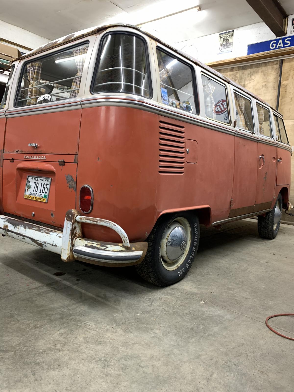

These are 205/75 15s on a stock wheel/axle. There’s no clearance issue at all. I assumed 205/85 15s would all be the same. Strange.

^^^Mine is a 63^^^ Maybe that lip makes all the difference.

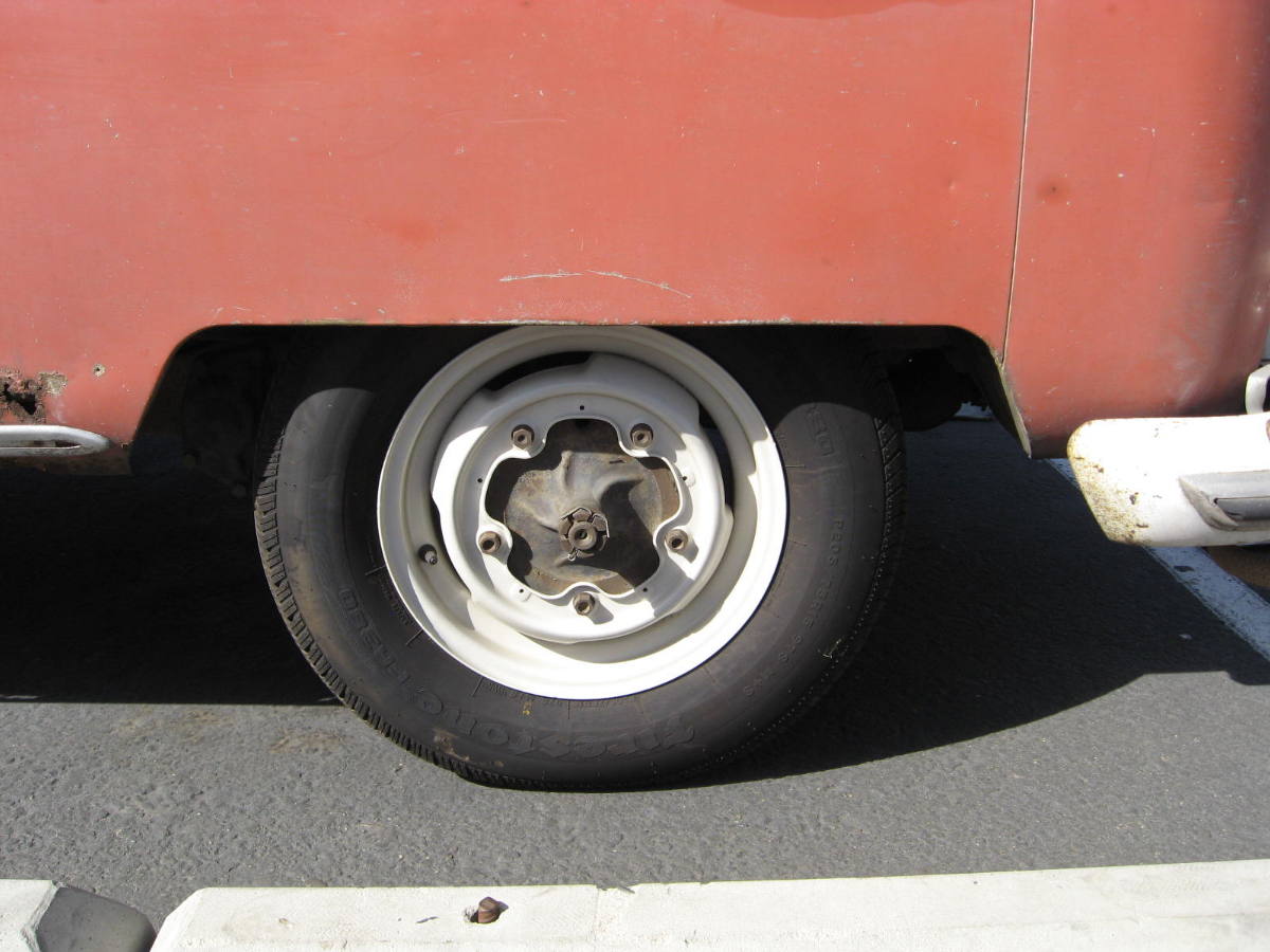

It's not so much the lip on 63' and later, it's that the earlier flat fenderwells actually extend down an extra inch and a half or so than the later ones. Same with the doglegs on earlier buses.
Here are some 215/75 R15 BFG All Terrain mounted on a 59' :
They were a tight fit to get on for the rears. This is with a split case trans.
Switched later to a tunnel trans and I had to deflate them a bit to get them on.
The later rear wheel wells bulge outward so the inner lip on the fender well does not stick inward of the rest of the side sheet metal like the flat fender wells do. Definitely having the early rear wheel wells being lower does not help either. Both equally add up to a harder to get wider tires in there situation.
True! I've also noticed a number of early bus flat style fenderwells bulged out slightly, likely from folks pulling them out a bit to fit larger than stock tires.
