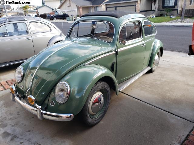

Reviving a dead thread. But what about this one? 🤔
https://www.thesamba.com/vw/classifieds/detail.php?id=2653102
CCs with vent wings? Says he's owned for 55 years. I'm very curious about it.

That's a very well ventilated car - Crotch coolers, 1/4 lights, wind down windows, opening rear 1/4 windows, and a sunroof. The only way to beat this is to have one of those opening front windows!
Except it’s fake news.

What do you think is grafted? It has to be more than just the CC's right?

I believe VW never made a car like this. Change my mind.

Oh I'm not trying to change your mind. Something about the car seems wrong to me. But I don't know zwitters well enough to put my finger on it. But I know VW used to use what they had on hand sometimes. This seems more than that to me though. Car just has me intrigued is all.
