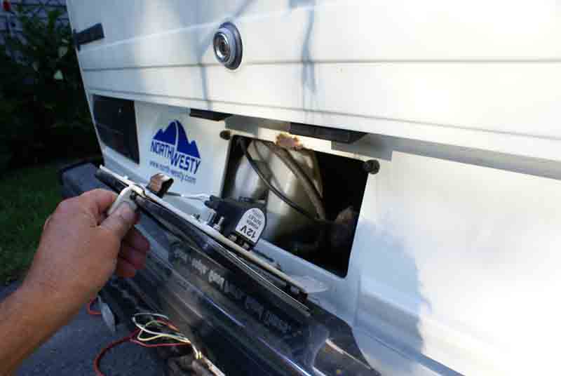

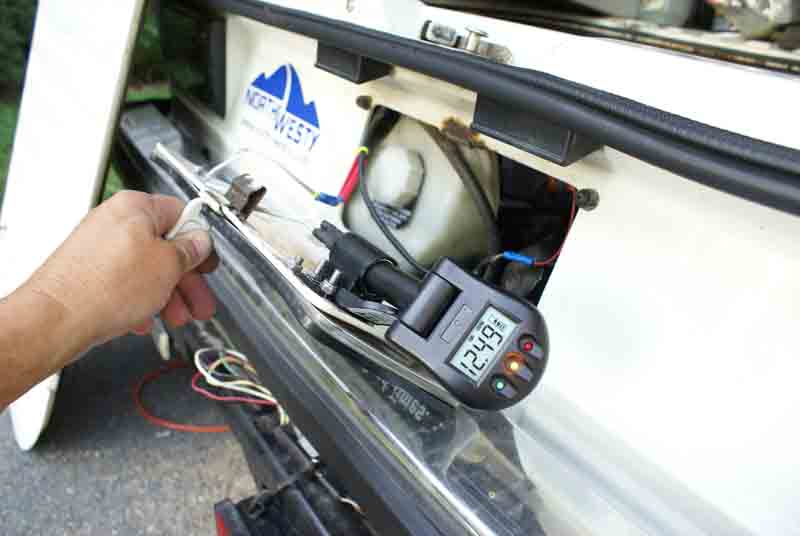

PostPosted: Thu Aug 11, 2011 3:34 pm    Post subject: Reply with quote
Looking for a way to power up my XM boom box from the outside of the Westy. I came across
a thread on the 80-90 club forum, where a member mounted his shore power receptacle on
the inside of the license plate door. Great spot, out of site and easily accessable.
