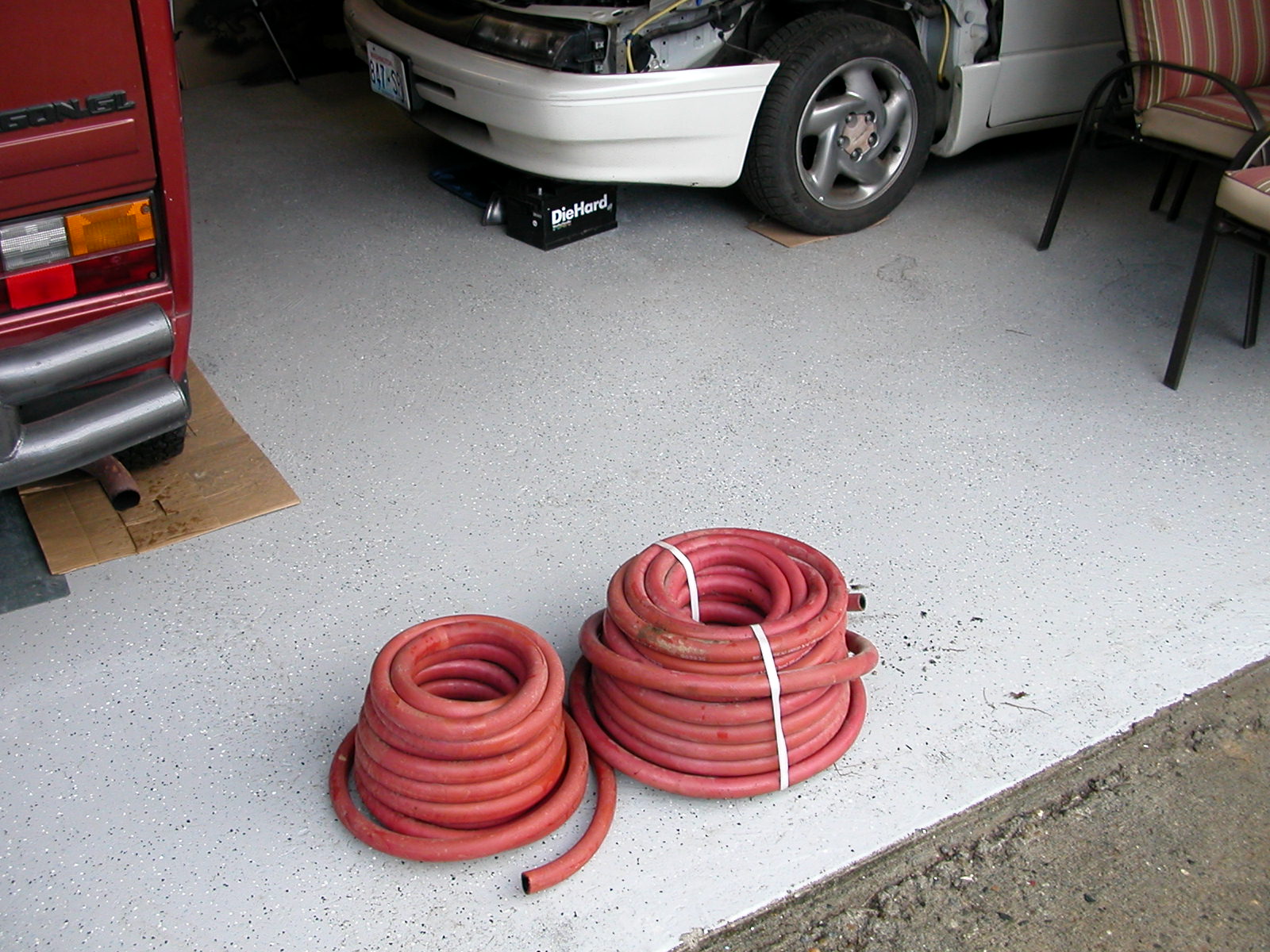

I used marine grade 3/4" hose when I ran my stainless pipes and it worked great, and did fit nicely in between the crossmember.
I used 5/8" to 3/4" adapters to tie in to the stock hose.
I have about 70 feet left over if anyone is interested. Located in Seattle. pm me.

that's the same stuff I used. didn't know it was marine grade. the kid at the FLAPS screwed up then because I only paid about $50 for what I got. I remember when I bought it from him it was his first week working therer.no longer there,they caught him sleeping on the job.
