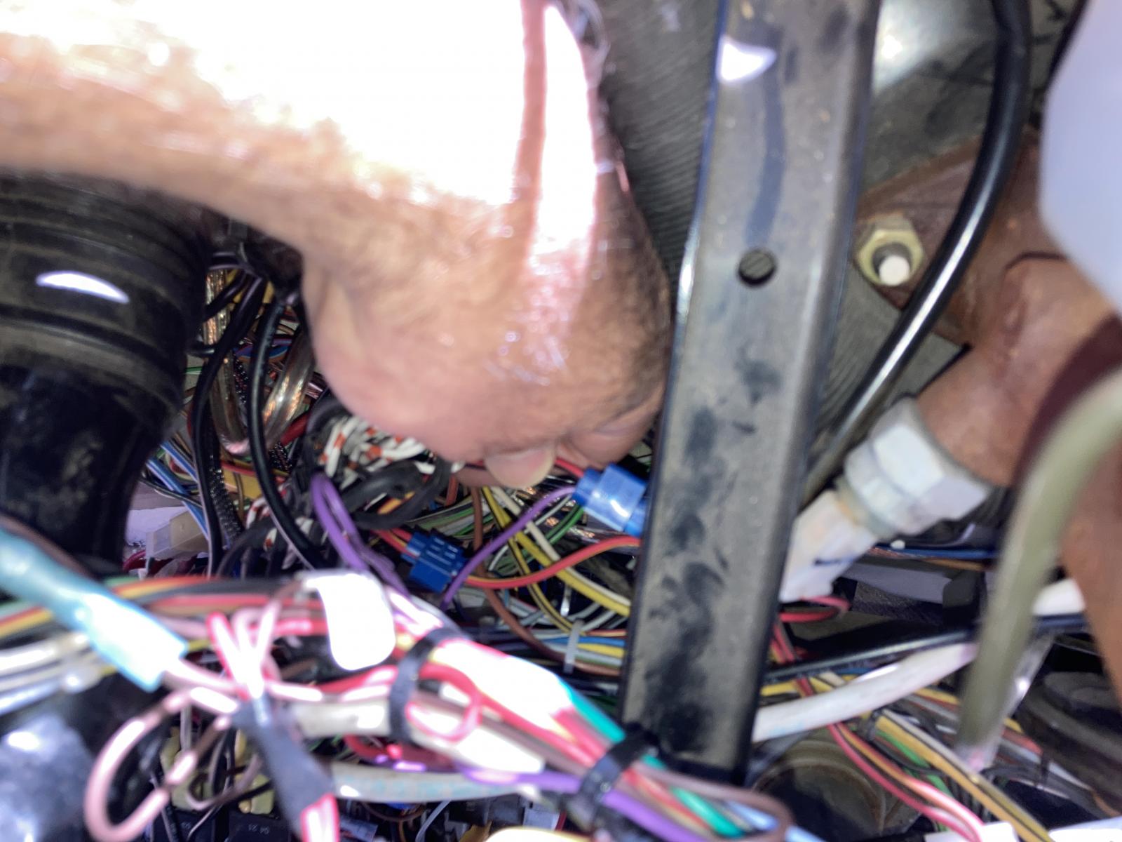

For the brake switch, connect the Rostra purple to the Red/Black on the brake switch at the master cylinder. Given the VW brake switch is a pressure switch and it doesn't illuminate the brake lights until some pressure is applied I use the clutch to disengage the cruise 95% of the time.
I have my dash apart, here's the purple connected to the red/black...
Here are the install instructions with wiring suggestions...

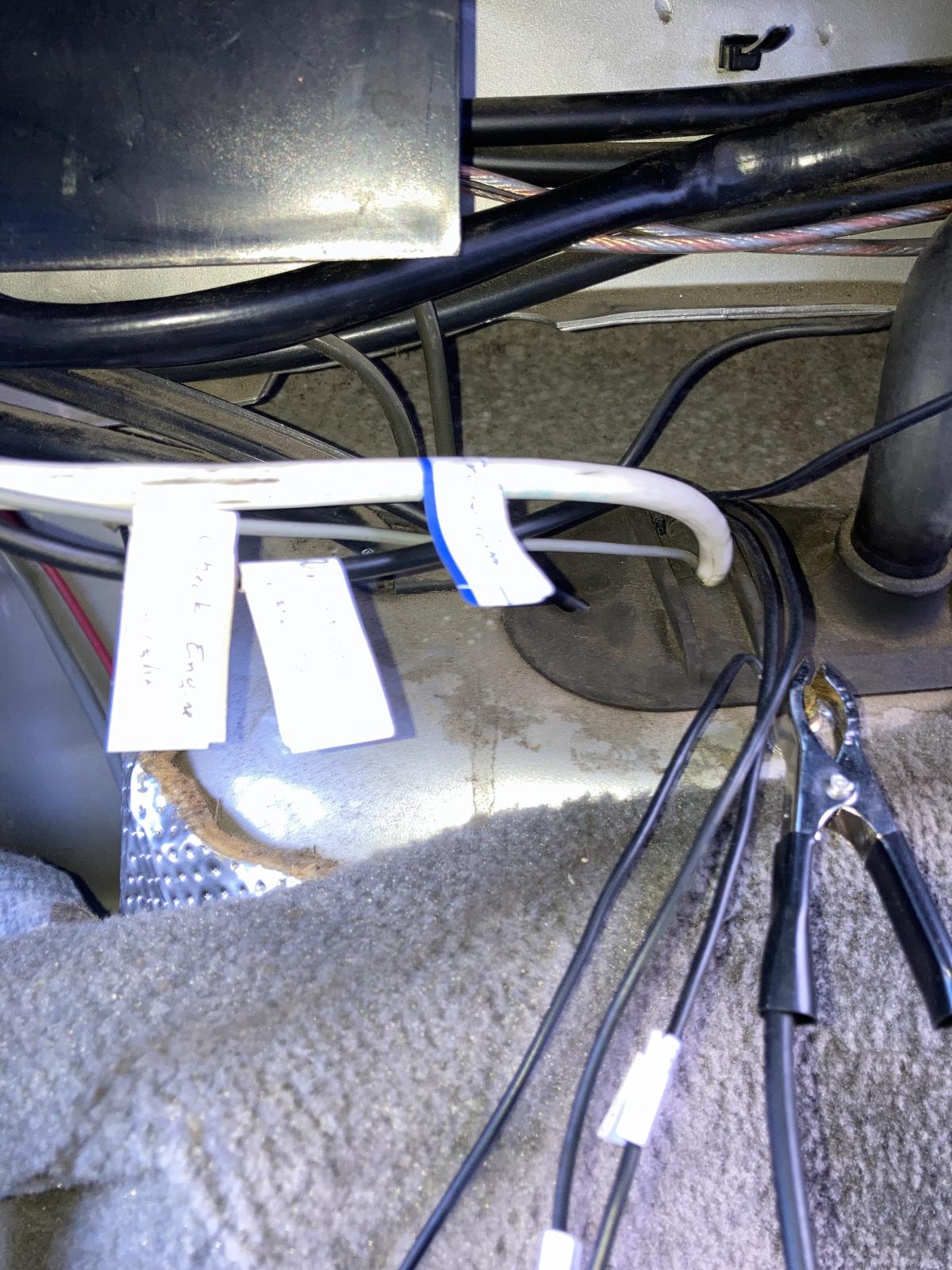

For the wire, I spliced in a 6(?) wire bundle in a sleeve to extend the wires to the front.
I'll post some better photos today, including the dip switch settings.
Controller installed...

To extend the wires from the engine bay I used Ancor 8 conductor signal wire:
https://www.ancorproducts.com/en/158010
West Marine sells it by the foot...
https://www.westmarine.com/buy/ancor--20-8-round-signal-cable-by-the-foot--541748
The RF receiver box that receives signals from the wireless steering wheel control and cutoff switches and the Ancor wire...
Routed through the grommet below the vents...
[/img]
- Jim
