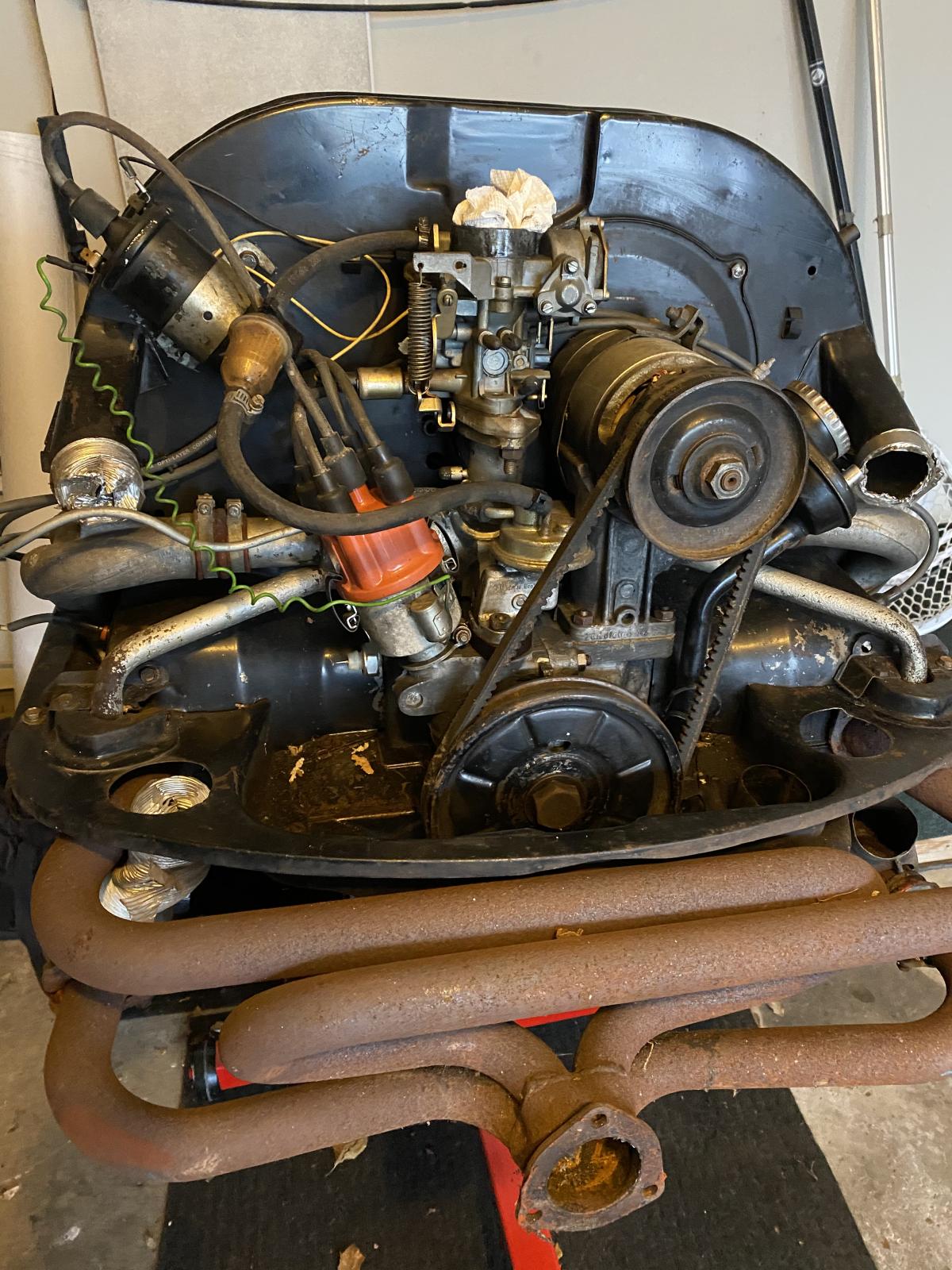

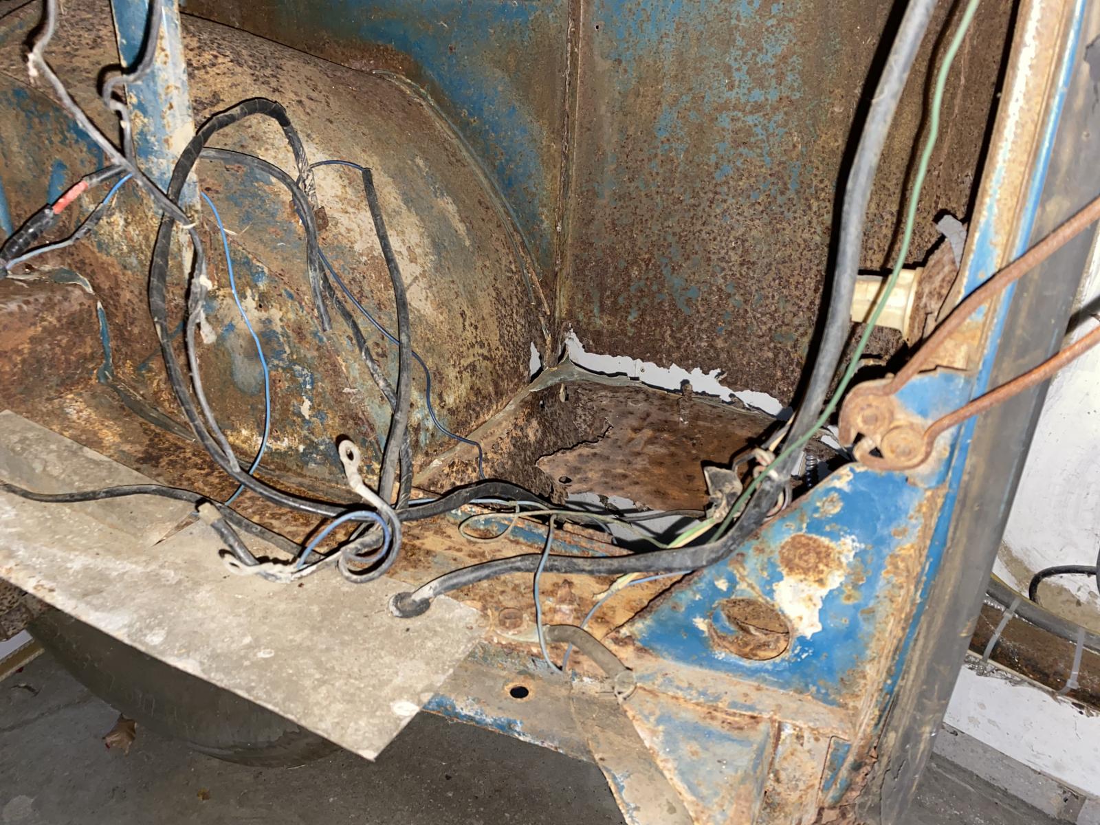

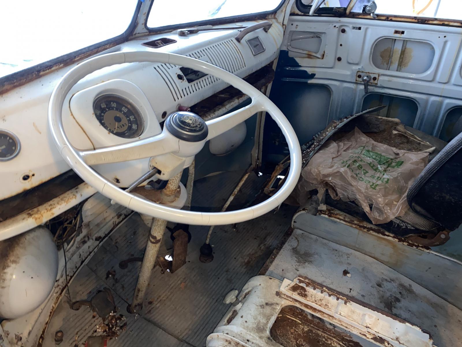

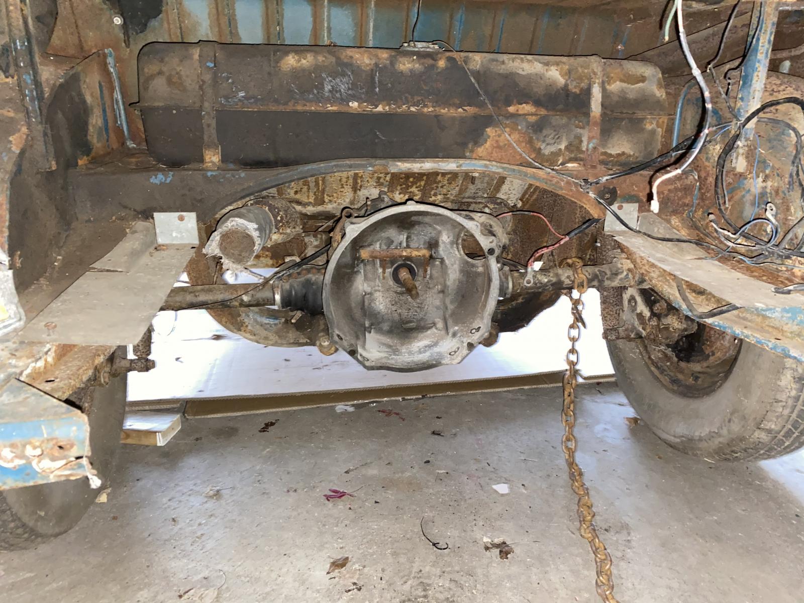

I thought I would share my bus that I bought late summer 2019. This will be my first project so it’s going to be a learning process. I didn’t do much to it yet other than taking the windows and bumper off. Its got some good things and some bad things going on.
The good:
• Rebuilt 1600cc engine from 1972 or 71. (The guy I bought it from said 72 but I thought that’s when they went to pancake).
• Was in Texas for the majority of its life so it doesn’t have the typical east coast rust
• Frame is very solid
• replacement parts thrown in (passenger dog leg, engine hatch)
• It had a bad driver side spindle, but I replaced that with a donor front axle
• The wheel wells were coated with some undercoating, very little rust under there.
The not so good:
• Front floor is swiss cheese
• Rust pretty much on the lower 2-9 inches all around
• A fair amount of bondo
• The previous previous owner had a corvair engine installed, so the engine shelves have been cut to fit.

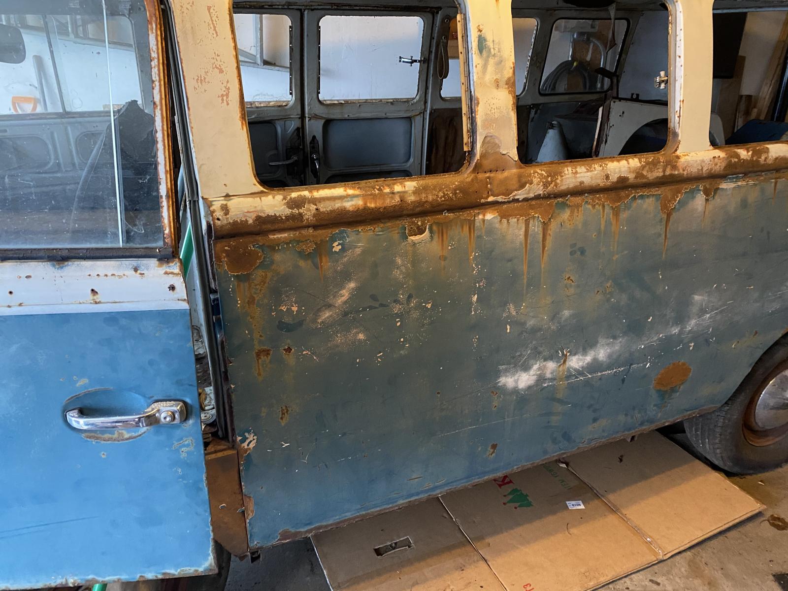

PostPosted: Fri Jan 10, 2020 3:48 pm    Post subject: Re: My 66 13 Window Project Reply with quote
Think at this point you should give up on the original paint. Have the all the rust soda blasted, especially the underside. Then have it primed and painted an inexpensive grey for now. Then you can fix all the metal that needs to be replaced.
Rust does not sleep...
In Stereo, Where Available!
ZafLax22
Joined: May 30, 2017
Posts: 10
ZafLax22 is offline
PostPosted: Sat Jan 11, 2020 9:56 am    Post subject: Re: My 66 13 Window Project Reply with quote
Thanks for the advice! I sort of realized that original paint would be a lost cause. I’ll look into the soda blasting
Eric&Barb
Joined: September 19, 2004
Posts: 25960
Eric&Barb is offline
PostPosted: Sat Jan 11, 2020 10:24 am    Post subject: Re: My 66 13 Window Project Reply with quote
Glad to help. Only problem with using soda blasting is it does not remove the thickest rust. Then you will need to use sanding, wire wheeling, and acid to get out the rest.
Sand blasting will, but that all too often will warp panels if the operator uses too much air pressure. Big problem with sand blasting is that the sand gets into all sorts of places and does not just come right out. Then the sand will collect and moisture that condenses on the sheet metal will be held by the sand like a sponge causing rust to work its magic faster from the inside of frame members, drain areas, etc., out of sight till too late.
Soda will wash out of those areas, due to being soluble.
