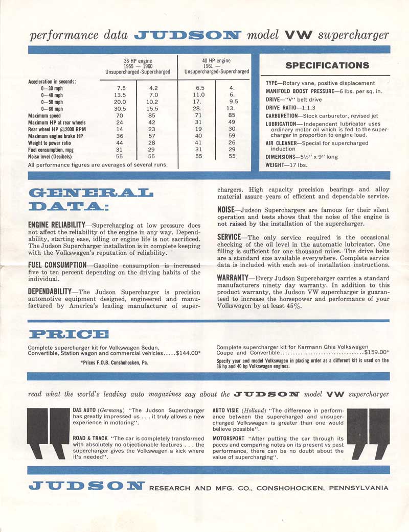

something is weird because in the latest Judson documentation (71 or 72) they say that you can use a the judson on a 1500 and a 1600CC engine

I have always been at a loss to see how overdriving a Judson for the 1500 & 1600 could ever have been achievable.
I'm also well aware of the Judson brochure page reproduced above and it's contents but it pretends overdriving the unit to be a simple procedure...it's not. The extra heat generated by the process has nowhere to go.
Fitting the larger 34pict carb (stock carb on a 1600) wasn't an option on the Judson as the stud spacing is too wide so the largest available carb was the 30pict.
John.

so the 1500-1600 kit is a oderdriven judson for 1200??? or am I wronk?
John Moxon Premium Member

grueni wrote:
not to wide when you build an adapt-peace Wink
The stock Judson application is a tight fit add anything to the height like a carb adaptor and the aircleaner hits the decklid.
Yes Judson supplied the same sized larger pulley to overdrive for the 1500 & 1600.
Edit: That is what I was told...this now seems to be incorrect.
John.

good to know with the pulley. 1.3:1 for 1500-1600 and what is the ratio for stock 1200?would be interesting for me.
but to adapt an other carb is for sure not easy, but pussible. 28mm carb or 20,5-21,5mm venturies are very small to feet the supercharger.
judson is a very nice supercharger. only the heating problem sucks.
I think if you look at this 1964 version of the one shown from 1971 you will notice the pulley ratio is given as 1:1.3 and a boost pressure of 6psi for the 1200.
The 1971 brochure gives the same pulley ratio of 1:1.3 and a boost pressure of 3 - 6psi. What this suggests is that Judson didn't actually provide a revised larger pulley to overdrive the larger engines.
The boost pressure refers to 3psi for the larger engines and 6psi for the 1200.
John.
