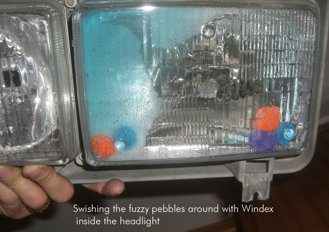

Seeing as how one or two other folks on this list might have 19-year-old headlights.
I was installing my GoWesty 80/100W bulbs+relay kit when.......
....I noticed the headlights had foggy film, and funk inside on the glass and reflector. This would NOT do, for new 80/100 bulbs. I searched the internet for ways to clean them and found no joy whatsoever (for cleaning the inside). Lots of folks were heating them to soften the glue, taking lenses off, all kinds of trouble.
So I took some pipe cleaners and wrapped them around little pebbles and dropped into the lamp, with window washing fluid. I swished the fuzzy pebbles around on the lens top, bottom, sides, and reflectors for a few minutes each lamp each 'side', then dumped out the (now) cloudy washing fluid. I rinsed them with filtered water.
I had to swab a little water out of the corners with a group of 3 Q-Tips clamped in a roachclip. Then placed the lights in the oven at 170 degrees with the opening upward -----> for about 45 minutes.
Headlights are now nice and clear!
----> Onward to the 80/100 bulbs!
