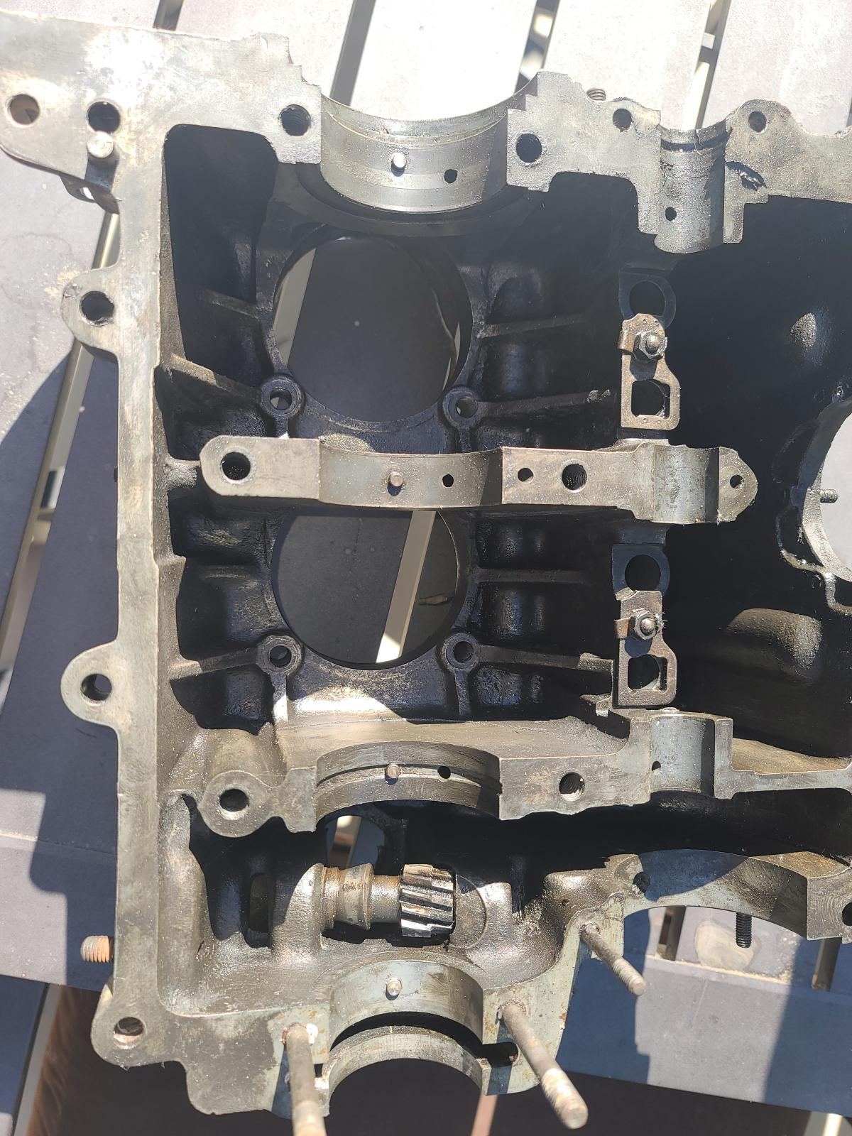

Hello, I was wondering if anyone could help me identify problems with my main bearings for a 1957 beetle. I'm including some pictures. Also are there any resources like specific books out there that show bearing condition to identify issues? I have no idea how to tell if these are good or bad. Thanks!

You are showing only the side that inserts into the case. It looks like they are loose in the case, just a little bit. The one dowel hole is buggered up (from being beaten by the crankshaft) and needs to be resolved before new ones get installed.
Right now your case needs to align bored (that #2 bearing has been pounded on, by the crank) but that other side of the bearing surface (where the crank spins) is what needs to be seen too!

If your engine case has a ridge in the main bearing saddle where the bearing groove sits, it can give you a visual and measurable amount of pounding the case has from loose bearings. If you can feel anything it is too much.

The crankshaft needs a certain amount of clearance between it and the bearings for oil. Too much and it knocks, too little and it seizes. The bearings are a slight interference fit in the case; they are just slightly larger than the case bore so they lock in place. #1 is the flywheel end bearing, and it controls the fore-aft movement, also called the thrust bearing. This is the one that typically gets loose in the case, and requires a line bore. Line bore is when the case bore is precision bored oversize. The crank can also be ground undersize, and the #1 thrust end of the case can be remachined to make it tight again. So there are multiple different bearing sets to accommodate all the possibilities..
You cannot do any of these things, but you should get some decent measuring tools to check your work as you go. Good measuring tools and knowing how to use them sets a successful build apart.

36hp bearings can be difficult to find…especially ones to match your crank and case cuts. Most of the time you just cut both to match the bearings you can find.
