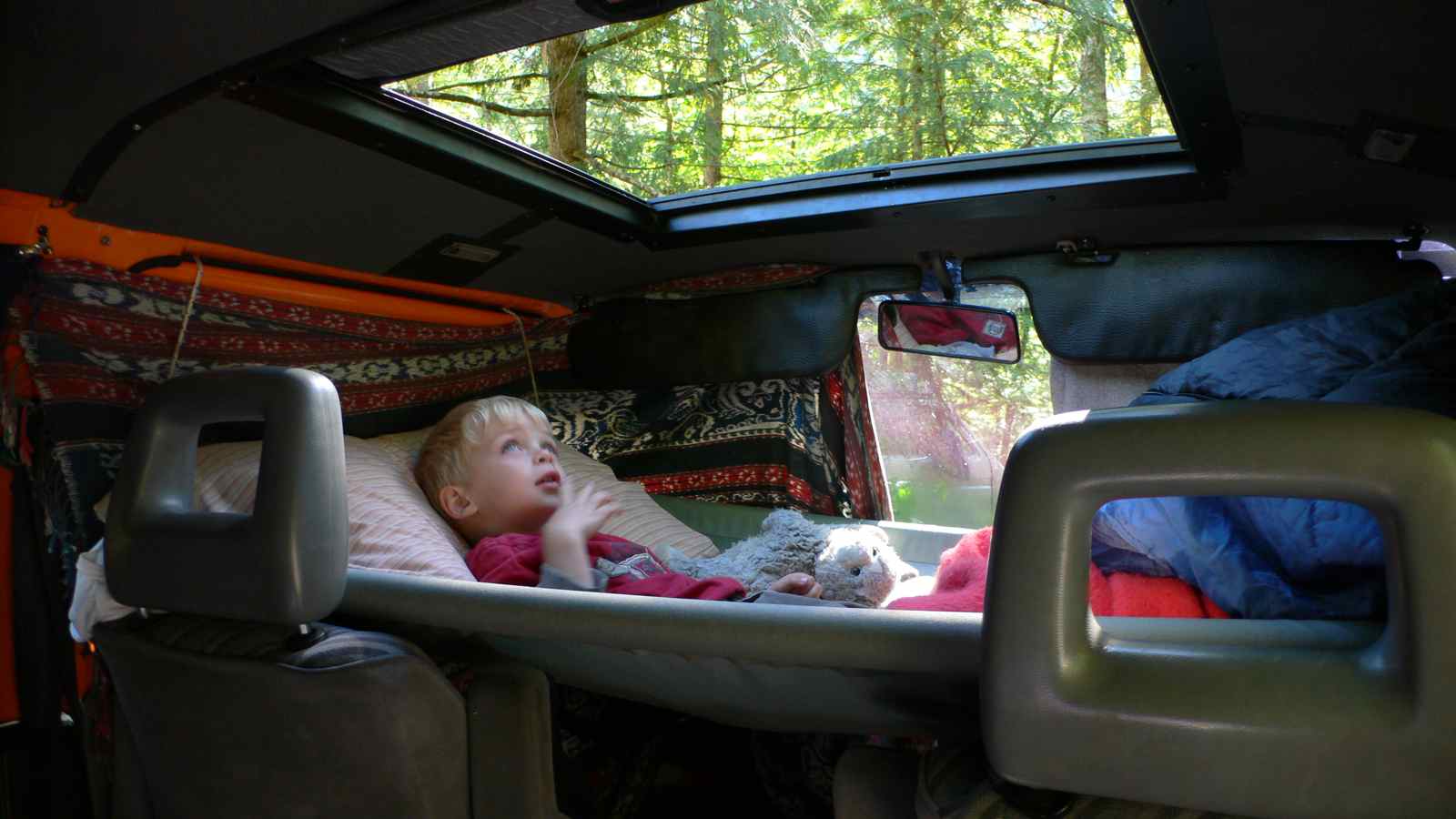

Here's some pics of mine in use.
The only problem is deciding who gets to sleep in the cot.
Those pics are priceless - made me smile! (Both mine are teenagers...seems like a looooong time ago...) Good for you for starting the van years early!
I love it, but, like someone else said, I love the swivel seat more than the space. I am looking into the rear shelf idea (brilliant Mikey9!) but the kids are growing quick and next summer they will be relegated to the top bunk! Cool Once they are up there, there will still be several years of the ability to store the extra "in the way" gear up top as they are short. With the rear shelf idea though, it would still be useable as a cargo shelf and especially, guitar shelf as I always bring one or two of those and they tend to get in the way lots, especially when the rains come Razz I also like the idea of the tent to put the extra stuff in at camp proposed by 1621 in another thread.... Idea
Beautiful kids!

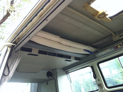

I saw the hammock at the start of this thread in a Colorado show, and was inspired to build one, but modify so that it is stowable. I have another thread on here.. didn't realize that this one existed so this is a bit of a repost, but good to have everything in one place.
By building 54 inches long when broken down, this tucks neatly in the pop top housing when not being used and is completely out of the way.
Here's a couple of pics, but more pics and dimensions and basic instructions along with more pics here:
http://picasaweb.google.com/gnoshmepics/VanagonProjects#
In testing:
Stored:
In a nutshell:
1.25 inch Schedule 40 pipe
2x 50 inch sides
2x 24 inch ends
Corners made out of Ts with one leg cut off, and a slice for the strap to go through
Corners attached to long sides with screws to allow canvas removal for laundry
Routing of straps done so weight on hammock holds end pieces in place
Hang heigth 13 inches.
Hanger "ends" are 3/4 inch pipe with slits cut in them for the straps - then a knot inside.
Cost $25.
Time taken 3 hours.
Time it would take me again 90 minutes assuming the sewing machine is in a good mood.
Best
K
