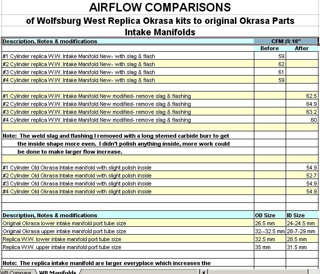

Folks have been wanting me to do a flow comparison between the Wolfsburg West kit parts and the original Okrasa parts. I got the setups done & here are the figures. In a nutshell the carbs are not quite as good but the manifolds have way more potential.
Note: The replica intake manifold are larger everyplace which increases theair flow. However, they need some T.L.C. work in the runners to get it all.
All tested by Tom Bruch (Bville Tom) on a Superflow 110 @10 H20 (4-28-2011)
Got my work cut out for me now Tom. Before I do any other changes to my engine I'll tune the carbs and intakes to see what improves.
