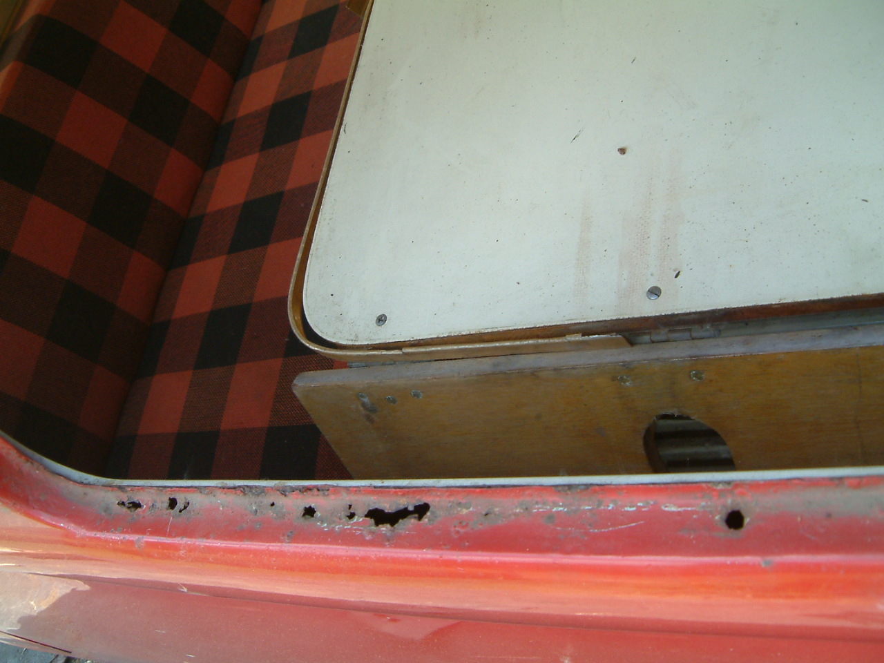

I'd value your opinion of this rust-belt bus. I picked it up for a grand (circa 1993) and drove it for a few years, but eventually deemed it too dangerous to drive. Its been parked in the garage since, like so many large-scale projects you have likely seen. Well, I'm trying to get something going. I've got a birth certificate coming which hopefully clears up what this bus is or isn't. Whatever the case, my main question is how much green should I expect to sink into the funky green needed to repair this once-green bus?
P.S. For all you lind dudes out there I'm going for stock, not interested in lowering or any modifications that would cause the purist's woody to go flaccid. I will admit to driving this bus with red shag carpeting, 13" front wheels and a Kraco tape deck when I was younger (PO's mods). NOT going back to that...
My list of metal, add / correct as you see fit:
lower nose/entire nose?
inner nose/bumper support
front floor
dash (or fix what's there?)
A-pillars? (where front doors mount)
dog legs (inner/outer), left and right.
B-pillars left and right
front seat mounts?
bulkhead
cargo floor (whole or sections?)
cargo door bottoms (1 or 2)
outriggers
jack points
short side rocker panel
short side rocker panel support
long side rocker panel
long side rocker panel support
rear apron
rear corners
engine lid
pop-out window openings (2-3)
front and rear (pressed?) bumpers, rear mounts
Thanks to EB for this venue and all TS members' restoration photos (stall 20 / npbusguy / robert davis, etc.), for the inspiration to get off my ass and do something with this!

I'd estimate at least $1500 probably more. Rather than purchasing all the Gerson parts at once, buy a corner and try fixing it, then go to another piece. It took me over a year with a similarly rusted bus; that was my strategy.

Once you get those jackpoints and outriggers off you will likely notice that you will have to replace sections of your top-hats as well. But I agree with Nor-all. I dont know you skill level, but dont overwhelm yourself Wink
Kick-ass bus by the way! 58 PGSG just like mine.

I thought that too, but that one close up shop of the B pillar what's with that really uneven paint line?

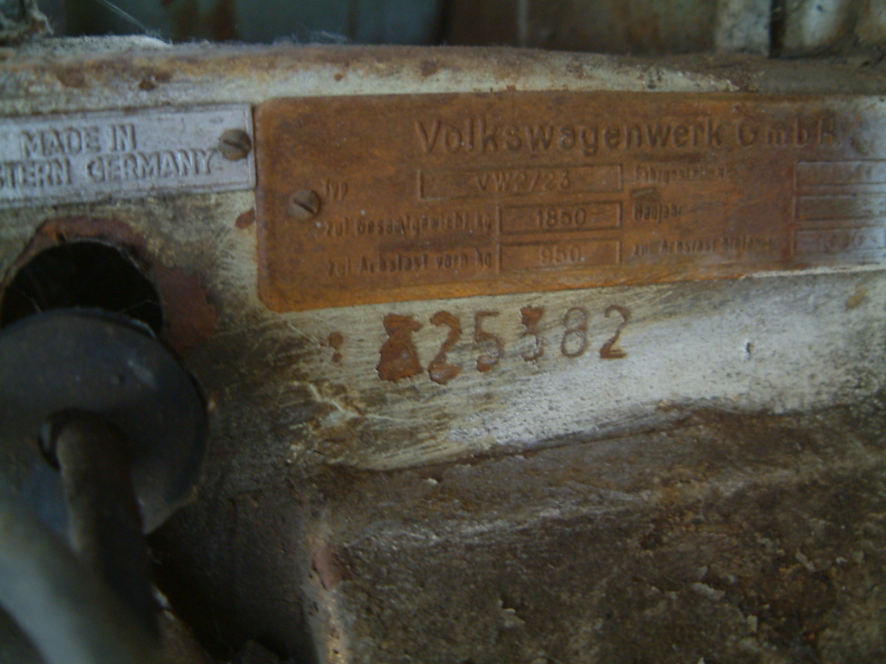

Actually I was wondering if it was a 58. What is the VIN? does it have an m-code plate?
Sorry, no m-code plate on the mangled bulkhead.

There would be no M-Code plate. The plate started in 59. So your not missing it no worries.

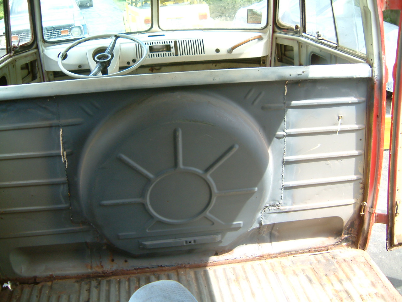

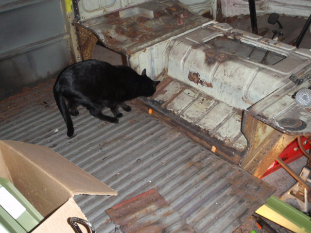

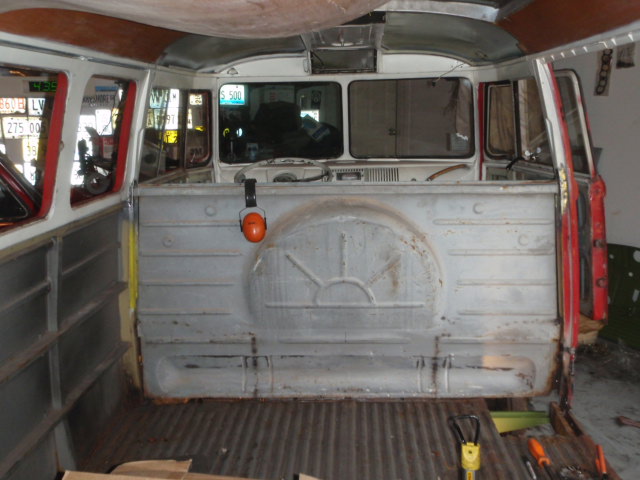

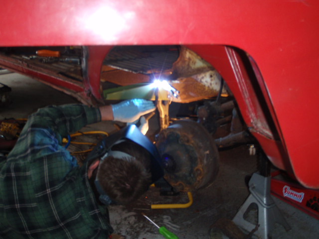

OK, so after some coaxing, Jim has made some serious headway on his February 58 sand green/palm green westy. Check out the pix of the work done today. It had a cobbled up bulkhead in it due to a crazy previous owner.....
Buzz the bus cat checking out the work we did today.....
Bulkhead temped in. Don't worry, we will eliminate the grab handle bumps and will add the original body number back to the new bulkhead
More pix tomorrow Cool
Gerson.... expect a phone call Shocked
