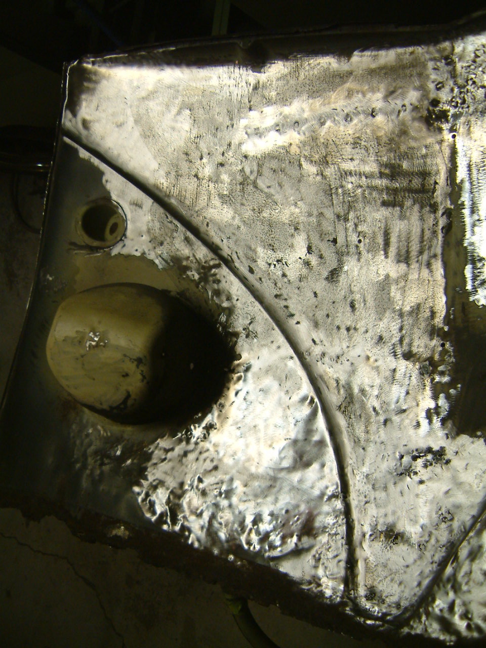

I have now welded up over sixty small holes in the nose of this bus, all left from some old-school bodywork techniques. I have also been slowly hammering many dents out, while trying not to stretch the metal too much.
Maybe saving this nose is too big an effort. I have been looking at the less-than-great noses that are on the market for $1K or more, to me it seems this is worth trying to save.
I was thinking once the nose was done this project would be smooth sailing.

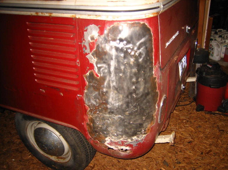

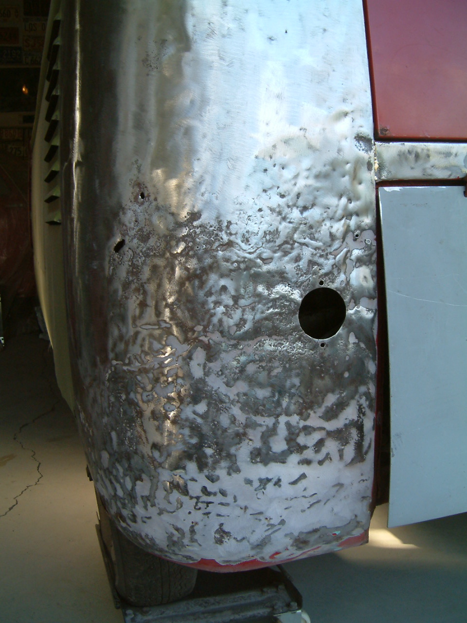

Then I took off the red paint from the rear corners for another surprise.
Someone thought brazing was a good idea. Shocked

That corner looks like a fat old lady cottage cheese thigh.

If your going to try and repair that nose and rear corner, get yourself a shrinking disc if you havent got one already.

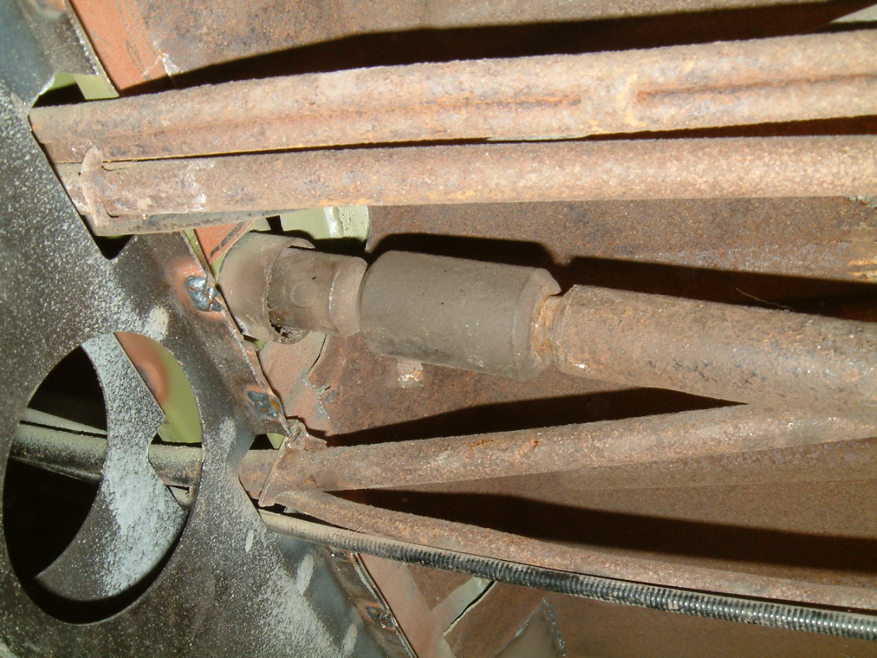

I have been assembling all the parts that make up a '58 shift assembly, and I'm afraid I'm not done yet.
Thanks to Bill from FL for the shifter.
Thanks to Rich for the early front shift rod.
Thanks to Hazetguy for the M-spring, although there is no cutout for it on my shift plate.
You can see in that photo where I cut-and-spliced the earlier rod.
I got it all together and it shifts, although not super-smoothly.
I don't know if the plate is correct or will affect this.
Is this correct or should there be a different "link"?
The rear bushing (at the transmission) that is installed is the one that was on the bus when it came apart. I found another in my parts stash, is either correct?

Either rear shift bushing will work but the one in your hand is more "correct".
