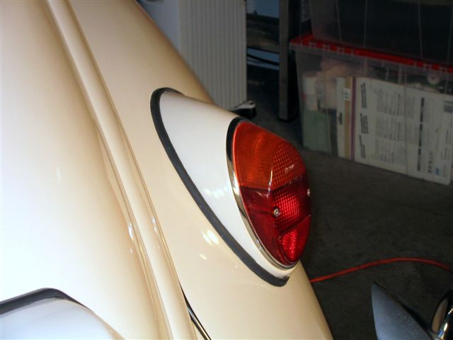

Have you checked the VIN here to see what year it was made? Does the body number match the pan number? It could be a '61 body on a '64 pan, and thus would be registered as a '64. What makes you think it's a '61? If it's all original, a few things to look for that would distinguish a '61 from a '64 are the tail lights (snowflakes on a '61, larger 62-67 style on a '64), front turn signals (thin peanut on a '61, larger on a '64 and mounted closer to the body) turn signal switch (6-wire on a '61, 3-wire on a '64), lack of a fuel gauge and fuel sending unit on a '61.
