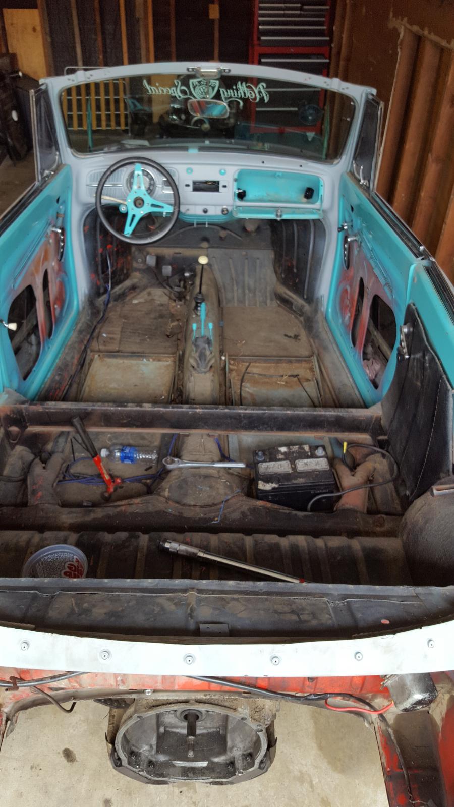

I'm currently restoring a 1965 convertible it's my first vert and it's a whole different ball game from the 63 ragtop I had the car is pretty much taken apart and in the process of being gone through bolt by bolt I actually just replaced my pan halves in my garage a simple diy for any handy man I just thought I'd share my build with those vw enthusiasts out there like me share your thoughts give advise I could use knowledge of those who have been doing this longer than me
My plans may not be everyone's taste but to each their own right?
Basically I'm going full bolt on airride from jerfab as I already have a custom airride beam I don't plan on welding or cutting anything what so ever as I don't want to ruin this beautiful vert.
Let me know what you guys think I'd like to hear some feed back

Haven't posted in a while but I'm plugging along with this build here are some updated pic of metal work that has been getting done recently.
Once we sat the body down on the pan we realized the cheap panhalves I had put on in the beginning didn't fit that well so I had to buy brand new Wolfsburg west pan halves which was a big bummer because my pan had already been Sand blasted and powder coated but it is what it is have to keep plugging along
Once I finished the pan it was on to repairing the heater channels because I didn't want to go through the pain of removing these convertible heater channels.

Had to modify this repair panel a little to fit right
Sprayer some rust preventative before I close the heater channels
Gotta make sure those body bolts don't spin

Sucks having to redo the pans especially after having it powder coated, some of the bolt holes on mine were off as well. Did the Wolfsburg West pans fit up perfectly?
Nice work on the heater channels and support rails as well.
I have the body off my 65 vert right now sitting on saw horses and 4x4s, I want to be able to move it in and out of the garage with ease. I really like the body dolly that you have there. Would you happen to share dimensions and some pictures of it? I think I might have to build one, it would make things much easier.
