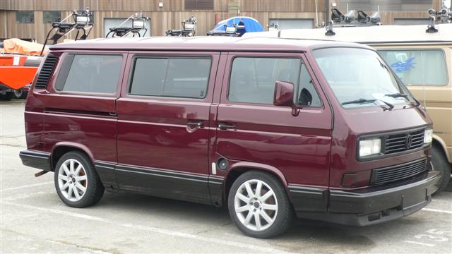

This setup on my van was butter smooth, H&R purple, Koni adjustables & trimmed bump stops.

Sounds like I'll have to check my own bump stops and replace the shocks. What wheels and tires are you wearing there?

225/55/17's on audi A4 wheels, 17x7.5 45et 10mm spacer in front & 5mm rear

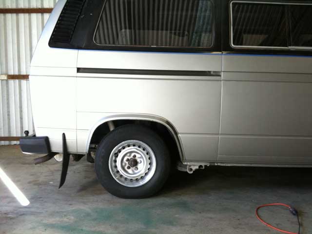

PostPosted: Sat Jan 30, 2010 2:31 pm    Post subject: Reply with quote
did you get your ride sorted? you might want to put a spacer under the front springs (or on top) to get the front up a bit, to match the rear. My rear is lower but I am running air bags and they are adjustable. My ride height was just like yours before I got the bags. When I get the fronts installed I will set it a little higher.
Blackdogvan,
I have the same tire size, wietec springs and I get some serious fender rub, even bottoming out the tire on the top of the wheel well. Bumps stops are trimmed to the washer+1 rib. Do you have any issues with tire rub?
