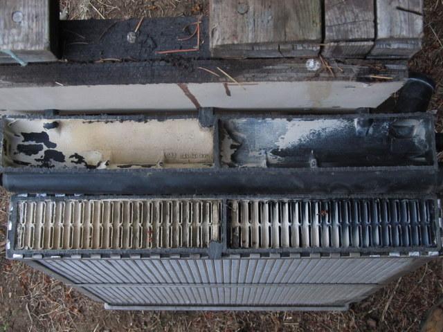

PostPosted: Mon Sep 09, 2024 12:39 am    Post subject: Re: 1985 vanagon radiator Reply with quote
Here are some pictures of the tanks on the radiator out of my 91 Multivan, with ~300K miles on it. None of the tubes were clogged, but I have no regrets with having changed it out.

PostPosted: Mon Sep 09, 2024 6:23 am    Post subject: Re: 1985 vanagon radiator Reply with quote
that white schmoo showing in Wildthings pictures of the core has a huge influence on heat transfer. sure, the core is NOT plugged but the heat transfer capacity is reduced. the Vanagon cooling system has quite a large over-capacity and can deal with reduced heat transfer but only up to a point. if you live in a hot area, obviously you want every BTU possible to leave the radiator.
that said, white schmoo probably would respond to a citric acid cleaning. but with the large hose runs of a Vanagon becomes a chore to flush it ALL out of the 2 heater cores, the block, and the rad. a new radiator in a 40 year old vehicle is a good thing, quality of replacement parts withstanding.
