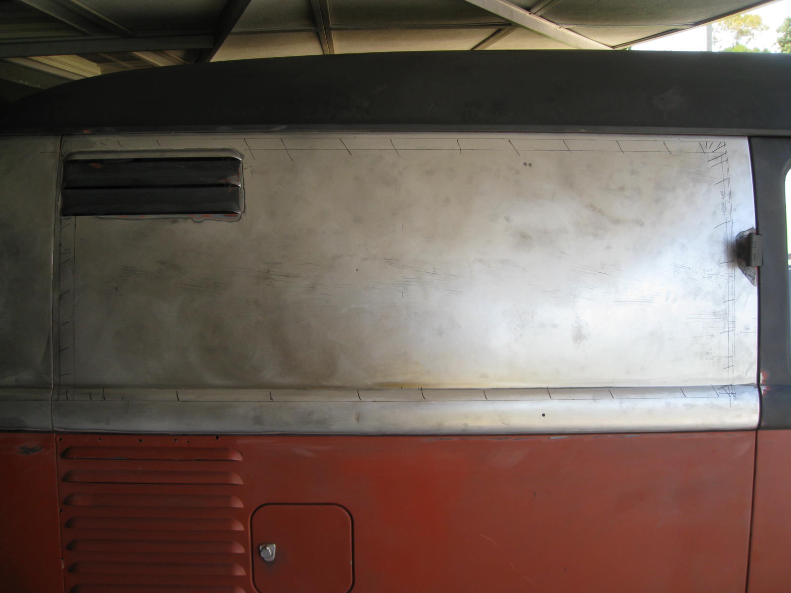

Posted: Thu Dec 24, 2009 12:15 pm Post subject: 59 panel van conversion to 15 window deluxe |
First stage of conversion.Clean painted area.Mark out cut lines.Cut donor side windows from cargo doors.

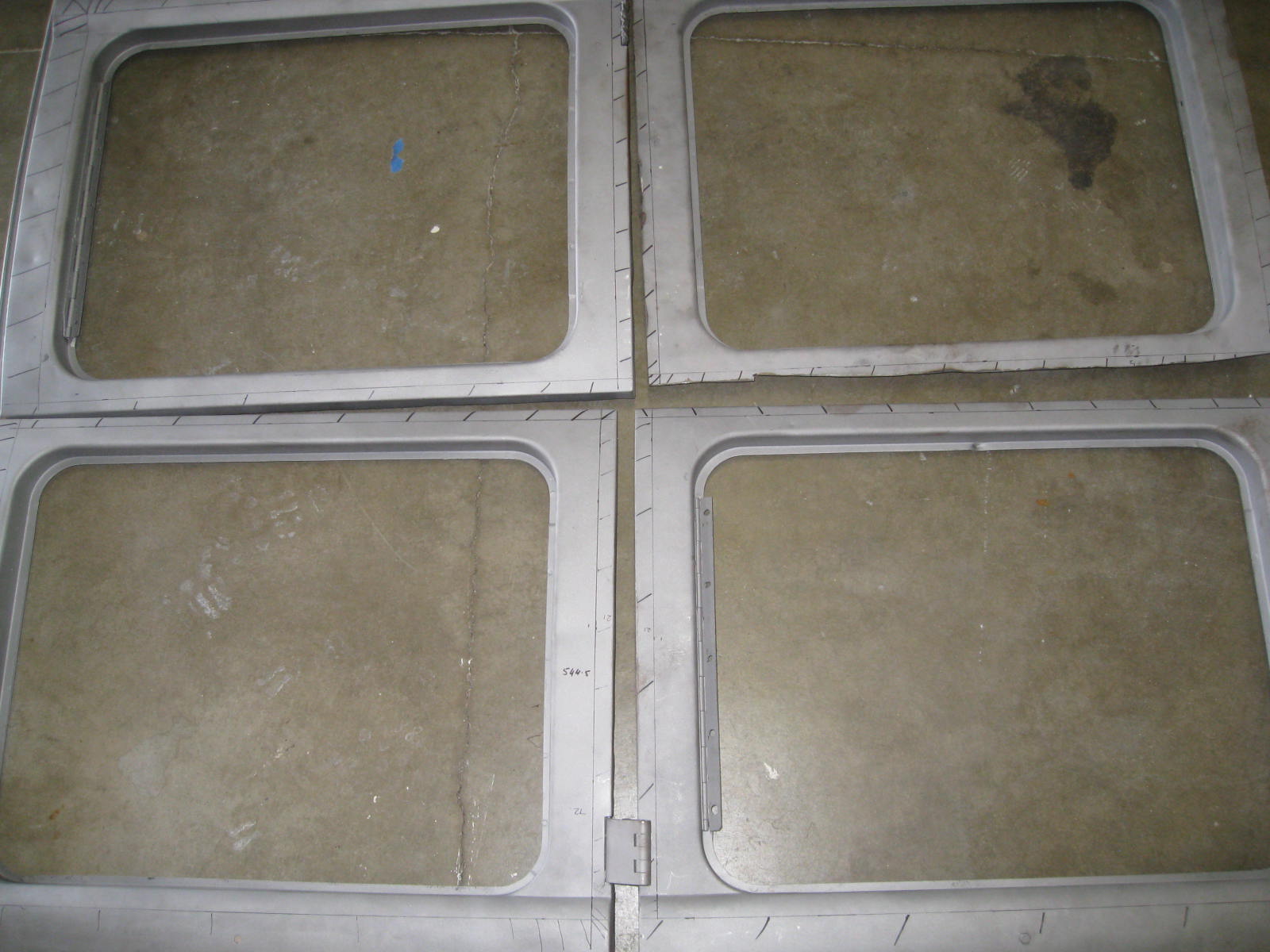

Posted: Thu Dec 24, 2009 4:24 pm Post subject: |
pics include cargo door top window frame donors to graft in to the bus. |

Posted: Thu Dec 24, 2009 8:35 pm Post subject: |
are the door window sections flat like the side panel? _________________ FOOK CANCER

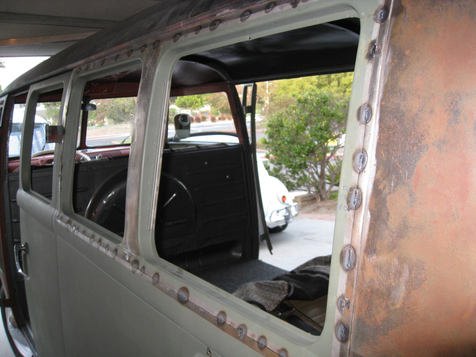

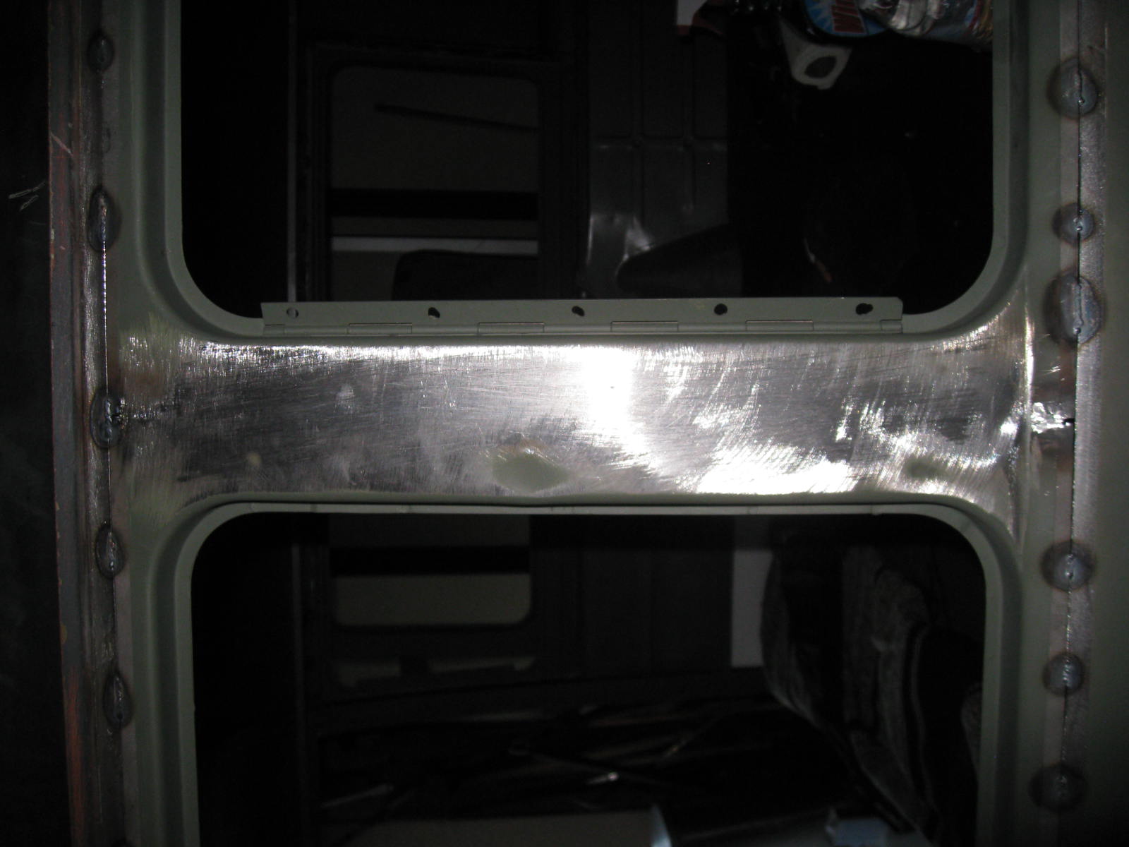

Posted: Thu Dec 24, 2009 9:19 pm Post subject: 59 panel van conversion to 15 window deluxe |
the 2 donor cargo window frames TIG welded together and metal finished.Then grafted into the ares cut out in the bus body.Klico'd in ,then tacked.
Followed by welding an inch at a time ,and cooling immeadiatley .Then metal finish as shown in the centre section of the 2 window frames. |

Posted: Thu Dec 24, 2009 9:22 pm Post subject: |
Quote: |
cargo window frames share the same profile as the body. |

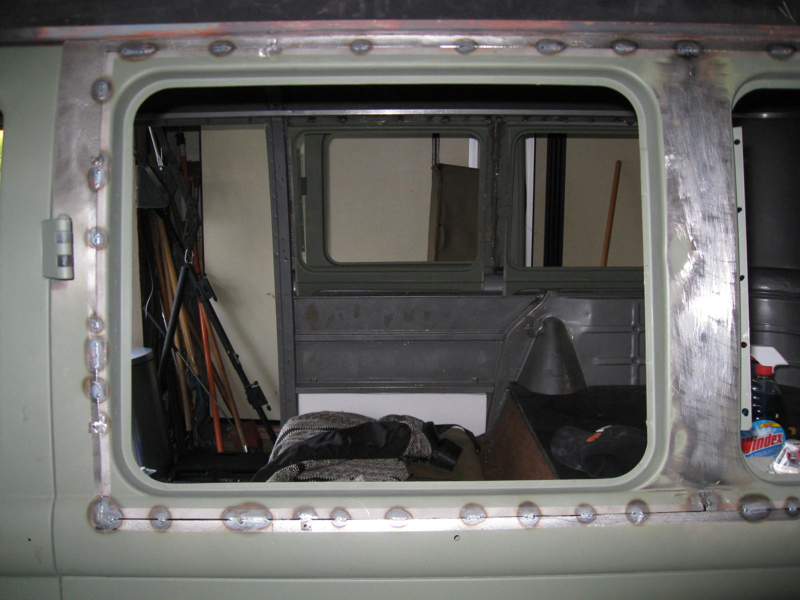

Posted: Thu Dec 24, 2009 10:17 pm Post subject: |
another angle |

Posted: Thu Dec 24, 2009 10:26 pm Post subject: 59 panel van conversion to 15 window deluxe |
inside the bus.weld penetration |

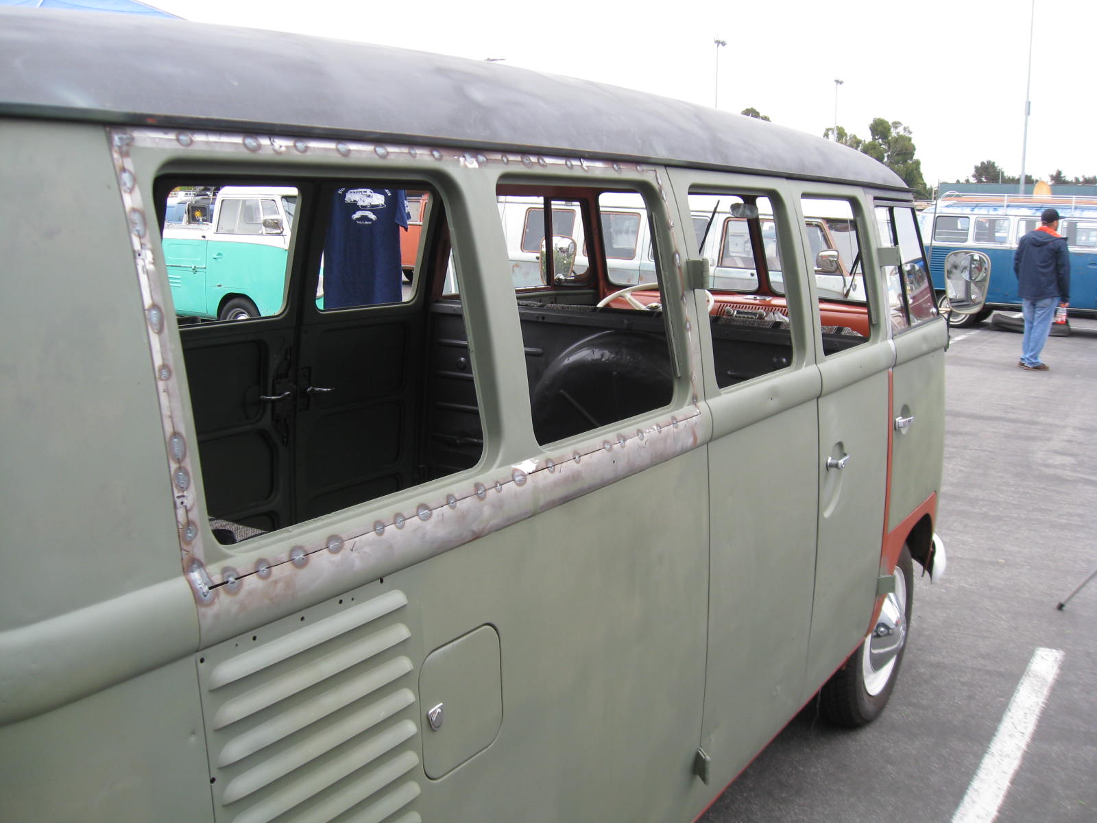

Posted: Thu Dec 24, 2009 10:37 pm Post subject: 59 panel van conversion to 15 window deluxe |
the bus at OCTO fest 09 .Work in progress! |

Posted: Fri Dec 25, 2009 4:06 am Post subject: |
Door window inner skins are not right above the window line. The original skins are flat. _________________ 58Euro 23 343208 The Ultimate Zimblewinder Machine.
