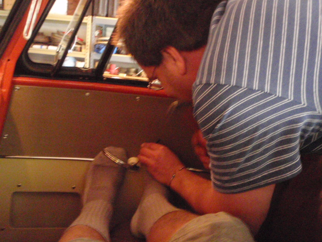

Use the tried and true sock method:
https://www.thesamba.com/vw/forum/viewtopic.php?p=4581956#4581956

OMG, thats hilarious... and I'm going to try it with my wife. She's small and too weak with the hands but the feet she can handle. I'll take my own picture too!! Very Happy
I think Clara has a nearly identical photo in her instructions sheet.

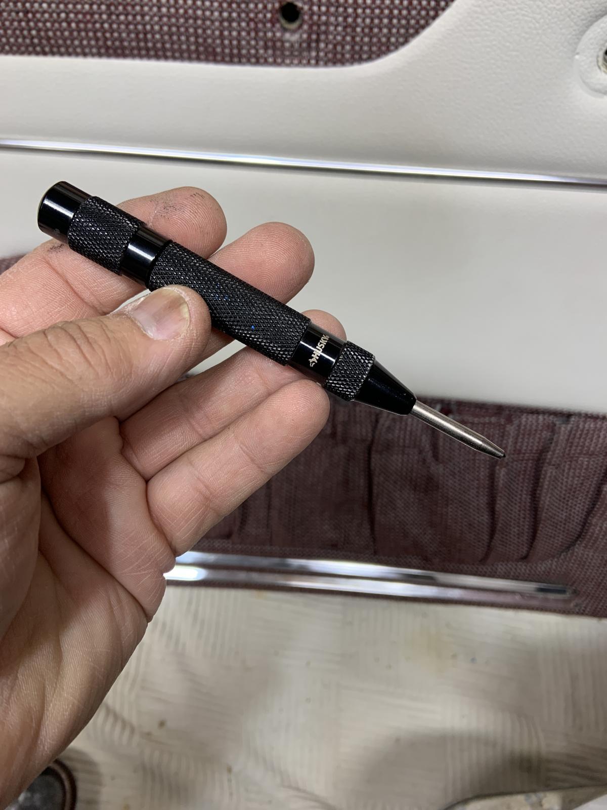

Working alone (without an extra pair of stockinged feet or a third hand) I’ve had some success using a spring loaded “push & pop” punch to drive the handle pins in while strong arming the panel with the other hand. Something like this
After a near miss of almost ripping the panel (thank goodness for a bit of just in case protective tape) I decided to file one end of the remaining pins flat and put pop dents in the center of those ends before setting the other three handles. It takes a few careful pops to drive the pins but worked like a charm. And I didn’t even swear once.
