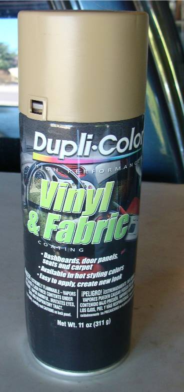

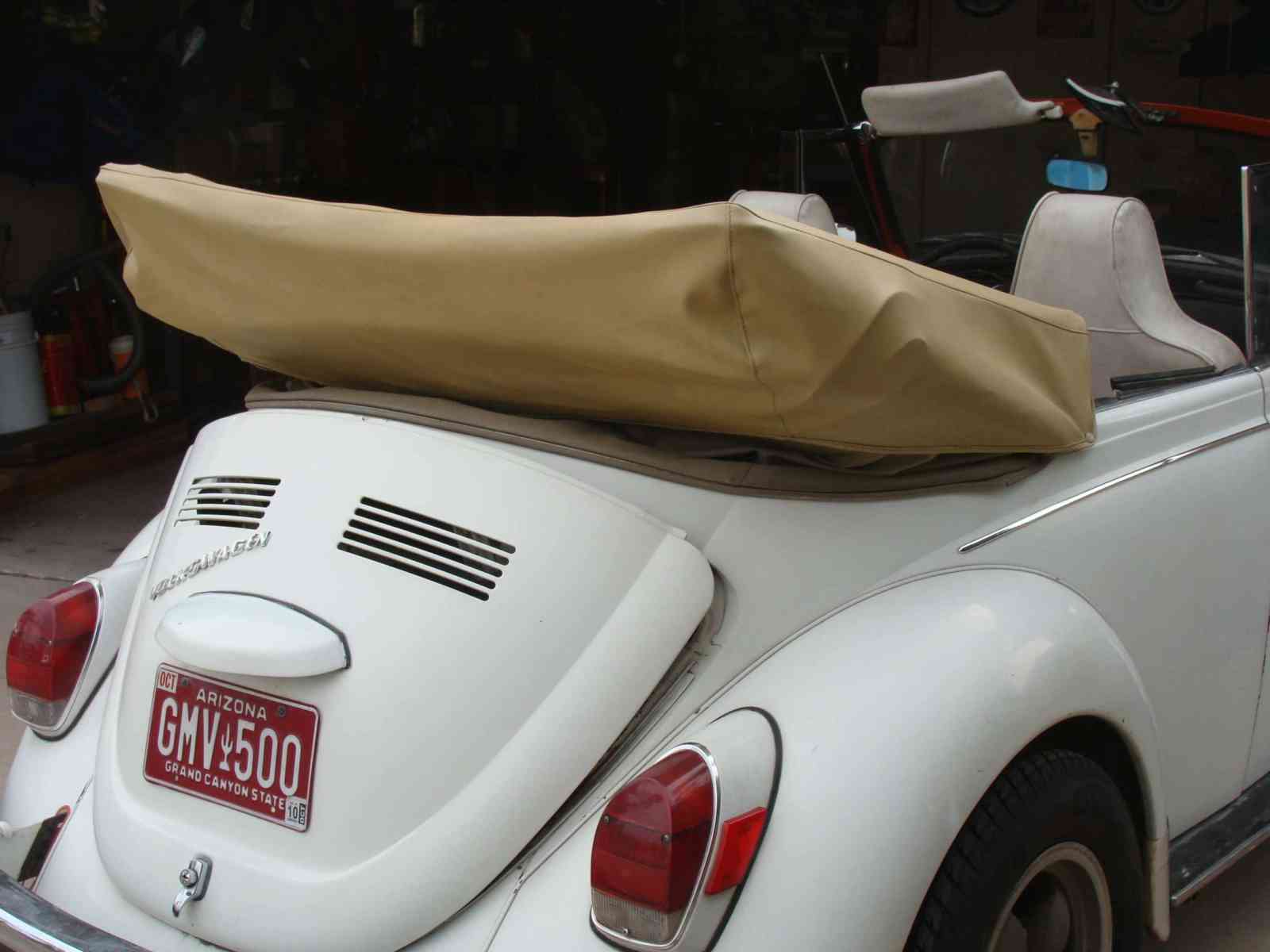

Here's some "after" photos, now the boot cover is tan instead of the dirty white it was for 29 years, and did show its age with scuffs, etc.
I used DupliColor Vinyl & Fabric paint, tan color, used 1 and 1/2 aerosol cans, purchased at O'Reillys/Checker/Schuck/Kragen for $6.50 each.

I used the same DupliColor Vinyl & Fabric paint about 10 years ago to paint a gray vinyl jacuzzi cover tan, and it worked good. So that's why I stayed with that brand. The can states to use on seats, dashboards, etc, so I figured if it works with seats, where someone will rub it, and sit on it and flex it, that it was worth the try. I read a post here on convertible boots and I think one must install their own snaps; see http://www.thesamba.com/vw/forum/search.php?search_keywords=Convertible+Top+Boot+-+Snap+Installation&search_forum=3.
Rustoleum also has fabric and vinyl paint, saw it at AutoZone, have never used that.

It does not look like you have your top folded correctly for the boot to fit. he boot looks to be riding a little high. You might want to check out the owners manual for the correct folding pattern. Here is one from 1972.
http://www.thesamba.com/vw/archives/manuals/72bug/72T1-47.jpg
Actually the earlier manuals say 61 show the procedure a little more clearly.
Folding the top correctly an using the boot which obviously you do prevent premature wear marks.
I have used Vinyl and fabric dyes by both duplicolor and SEM for various interior pieces never a top. Nice job!

Yes, I intentionally don't fold the top down correctly until it snaps into place. Because if I do that, the boot cover physically rests on the top of the hood, because of those hood standoffs. I have the hood standoffs because I live in Arizona and have an 1835cc engine, and decades ago I traded my bottom-dented original hood with 4 louvres for an undented sedan hood with 2 louvres (the guy was making his into a Baja bug anyway). Besides, it's still hard to see a low vehicle directly behind even when I did snap the top all the way down.
Would I get sufficient cooling if I removed the hood standoffs? That's anybody's guess, maybe and maybe not. My guess is yes because I don't drive that engine long highway distances to California, etc. any more. However, VW went to 4 louvres on 70 Convertibles with 1600 SP, so apparently they felt there needed to be more air than with 2 louvres. The 1835cc DP engine does not have a doghouse shroud (it's based on a 1600 SP, with 1970 fan shroud) but has a mid-1970s external oil cooler on the far side of the fan shroud.
The other issue you're dealing with is that the convertibles don't have the louvers under the back window, so you're already dealing with that loss of air. Combined with fewer slots in the deck lid I'd be a little concerned about cooling.
Correct; and my 1970 sedan's engine hood is also two-louvre, so I can't just swap those. Besides, I'm getting surface rust-through on that, washed it too many times from 1972-1993....
