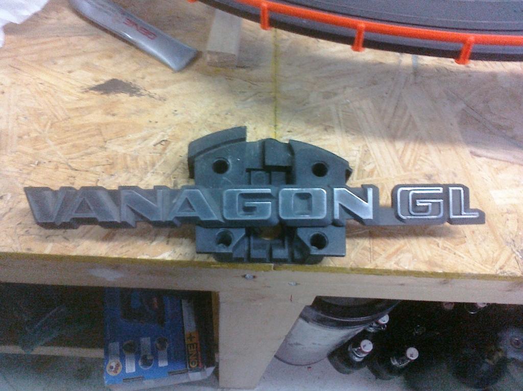

Any tips/tricks on restoring the Vanagon, VW and Syncro emblems? The chrome is pretty much faded. One option I may go with is to just paint everything black since I plan on doing that to the grill and sliding window trim as well. Chrome is for '57 Chevys!

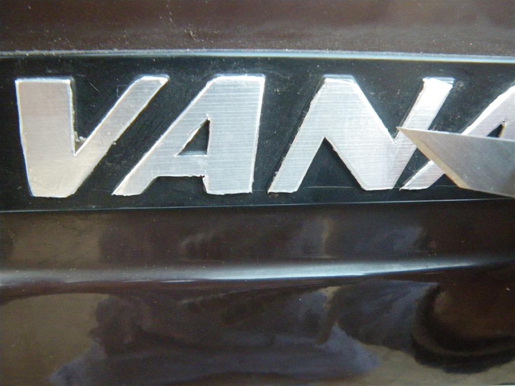

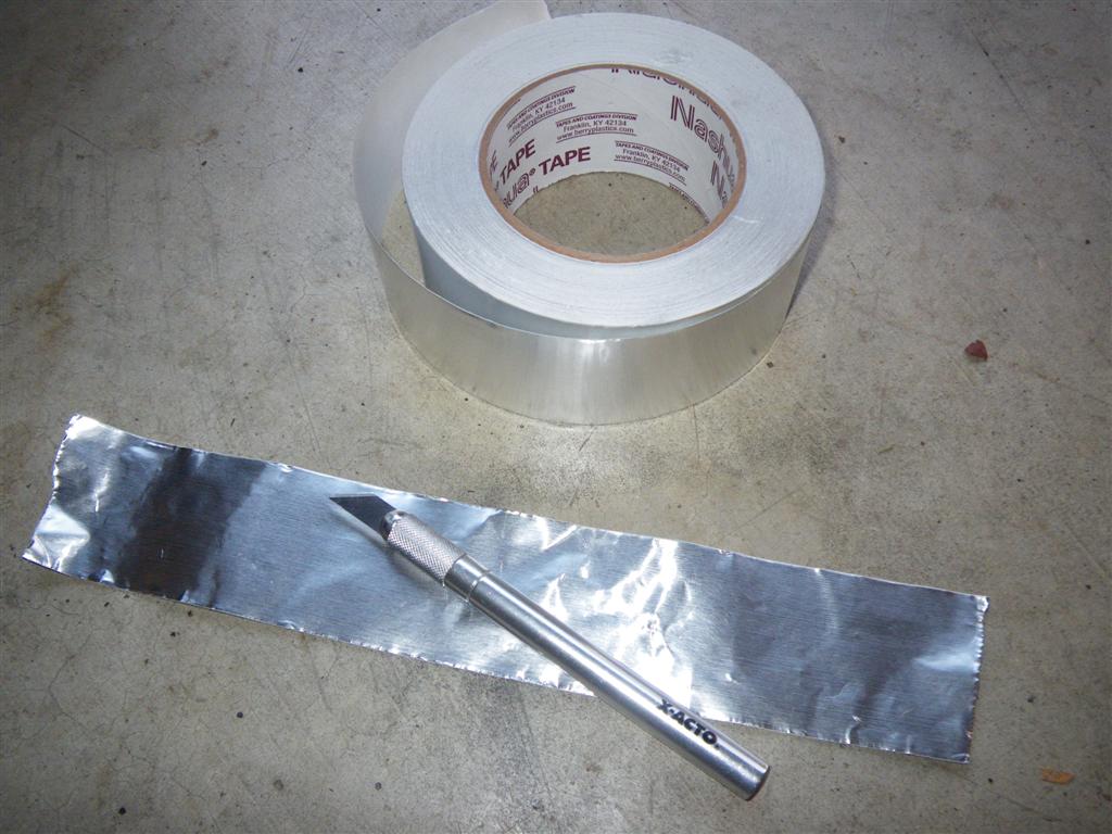

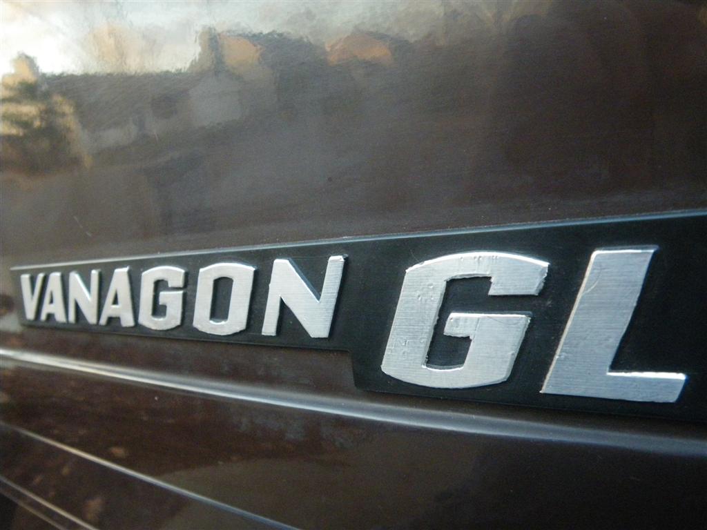

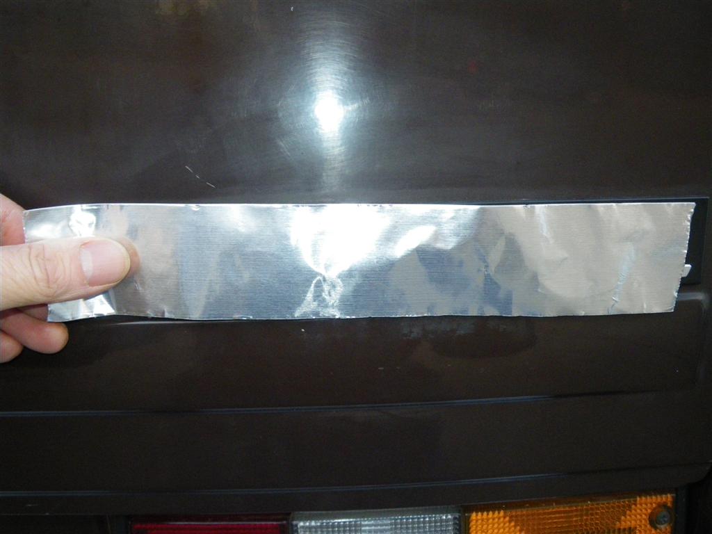

VanWilder wrote:
Today I cleaned up the rear emblems. The "Volkswagon" "Vanagon GL".
I used Heating and Air Conditioning foil tape and an Exacto knife to cut the letters out. So simple and looks great. Stick the tape on and get to cutting.
Material used.
Place tape on Emblem and smooth it over all the letters.
Cut out the empty spaces of the letters with an exacto knife or razor blade
The finished product looks real good and should last a while.

Just do the Alum tape thing like I did. It worked great, looks great, will last a looooong time and it was so easy. My 2 Emblems took 30 mins. Get your blade,, grab a beer.. etc.. Laughing What ever you do I would love to see it.

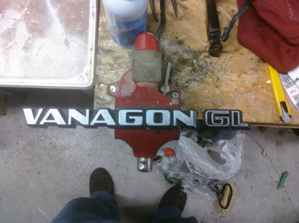

I used the block roller method. I got a soft rubber roller. Maybe I should have gotten a hard roller as it left a little alligatoring. Looks good from 20 feet and I may try to hit it with a high grit sandpaper.
Before:
After:

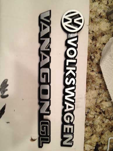

PostPosted: Tue Feb 14, 2012 8:41 am    Post subject: painted emblems Reply with quote
I just painted mine. I used Kylon Fusion black satin spray paint and acrylic silver paint. went over the letters with a very hard little paint roller for wood trim. then went back and touched up the black with a small art brush. came out ok it think.

PostPosted: Tue Feb 14, 2012 9:07 am    Post subject: Reply with quote
i just sprayed mine black and i love the look but i like the way PAdom'c came out also

PostPosted: Tue Feb 14, 2012 9:34 am    Post subject: Re: painted emblems Reply with quote
Wow!!! Looks brand new. Great job!!!

PostPosted: Tue Feb 14, 2012 9:40 am    Post subject: Reply with quote
Yeah that looks really good, I tried to find the info Jay leno had on a video on how to rechrome these on the cheap but couldn't find it...I think this will work fine.
