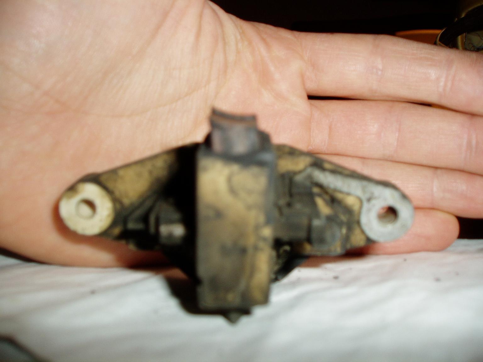

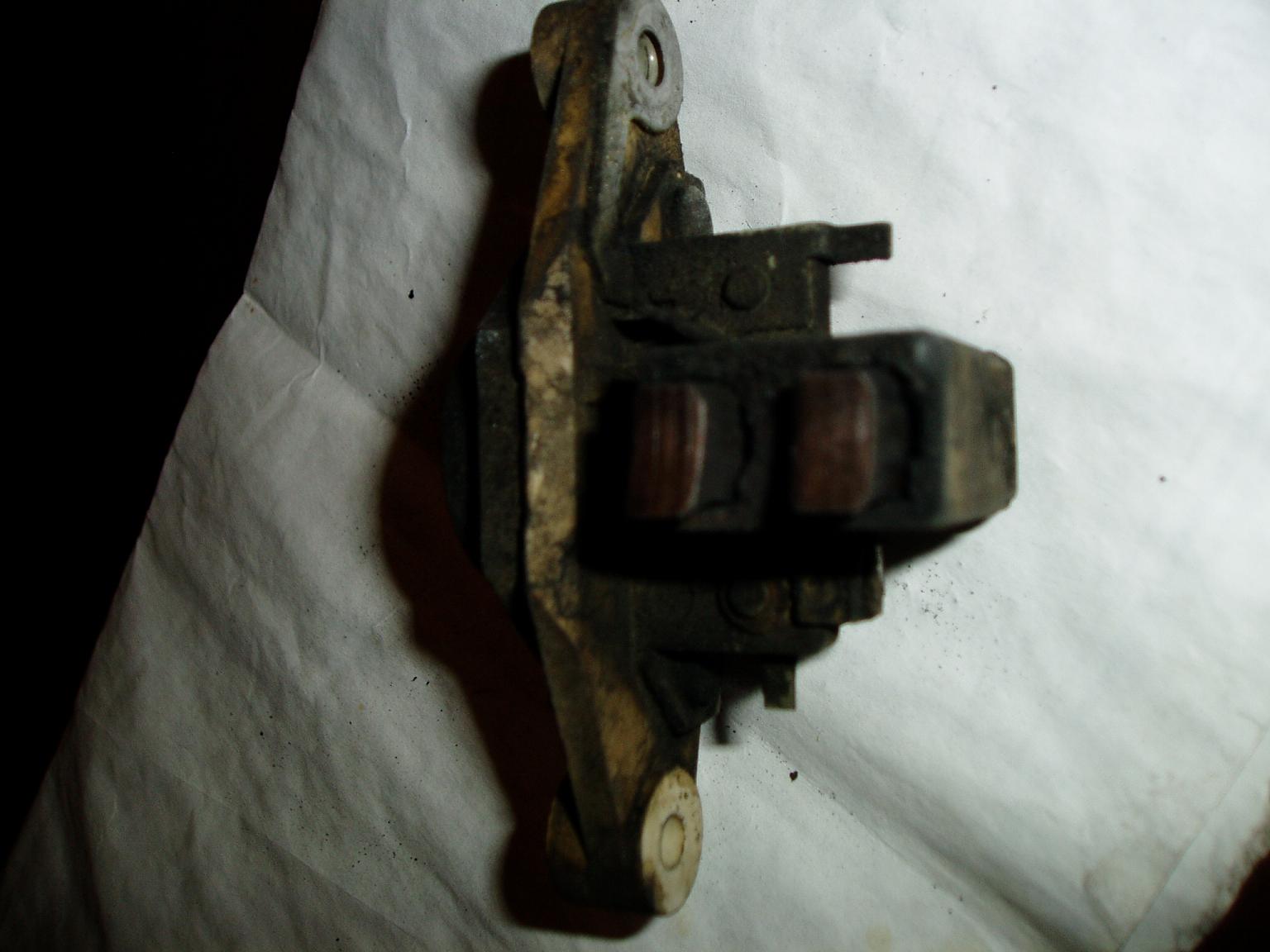

Ok, I pulled off the voltage regulator just now. Here's what I saw:

Regarding that voltage regulator, the brushes are getting low, but they are worn evenly, so that's good. As I suggested, clean the corrosion of the metal grounding contacts you see there on it , and the metal "tang" you see just inside the back of the alternator. Put it back together. But consider ordering a new regulator. (you have a bosch unit, by the way)
