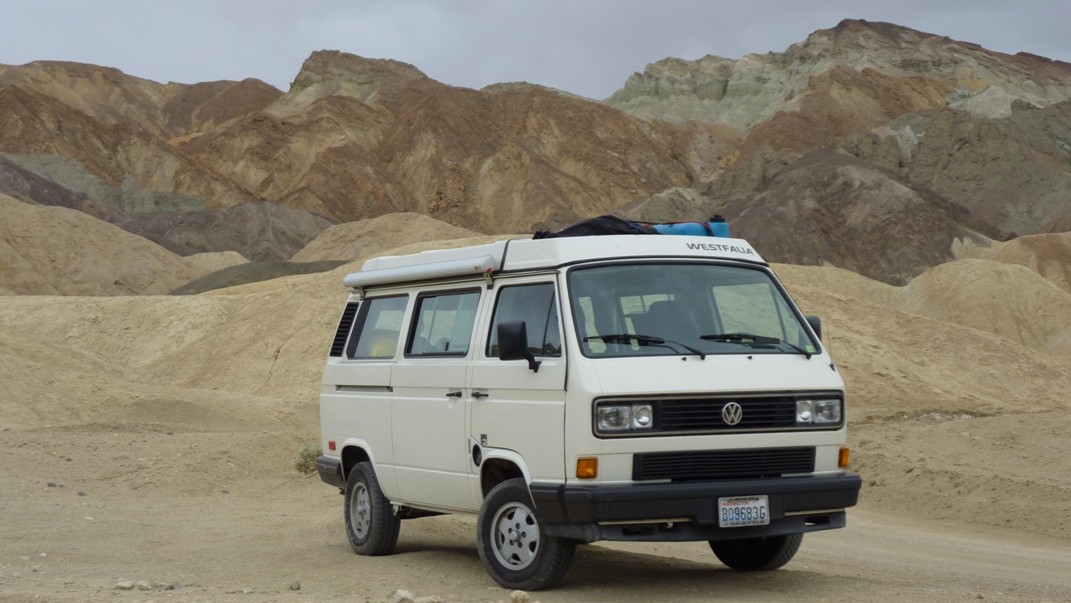

Death Valley: Wildrose Campground at 4,000 feet. We came in the back way from the west which is part gravel and goes through a wash. No problem the road was in good shape. Probably only a problem when it's raining or right after a heavy rain. Free camping in winter.
Death Valley: 20 mule team canyon, quick and easy way to see some niffty colored hills. Great place to pull off for some lunch. The road was fine in my 2wd however it looked like fwd cars were spinning on one of the steep hills. Loved the open spaces of Death Valley too.
