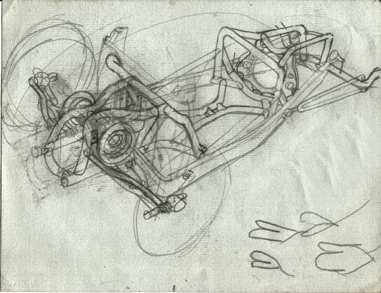

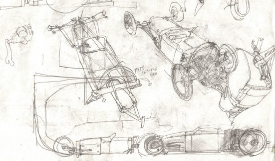

Here are some drawings that are laying around our shop. For us , its a pastime to draw and design.

Those are great. Thanks for sharing..!! I'm not very good when it comes to drawing so I'm not too sure I'll share mine. Laughing
