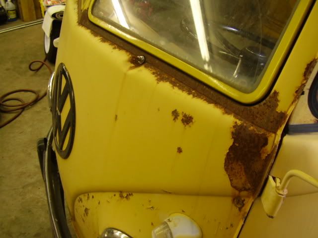

I am in a similar situation. My Windscreen is rusted pretty well, but no holes or rust through. The overlaying metal is not swelling.
My question is with a condition like this, how does one restore this area and not have rust reappear from under the overlay?
What is the best method, media blast then POR treat, the prime and paint?

That a tough one, even thought the metal is not rusted through there is still more than likely going to have rust in between the 2 peices of metal.

sandblast and paint with POR15 then prime as per their guidelines. it isn't 100% needed to sandblast if you're using POR15 but when the rust is like that i'd do it if you have the ability.
here is a photo gallery with some decent details on replacing the lower channel. the owner of the bus is a member here, velvetgreen.
http://www.germansupply.com/Picture_Galleries/germ...bi.html#15
