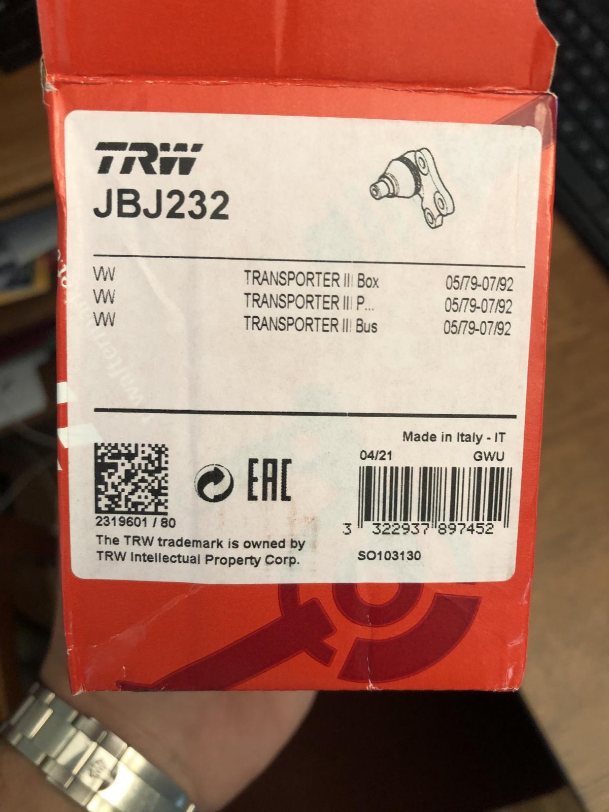

PostPosted: Fri May 07, 2021 12:59 pm    Post subject: Re: Lower ball joint boot dilemma Reply with quote
I finally received the TRW lower ball joints from Lithuania. They are pictured below. This is the best I could find and I hope they will last for a while more than the other brands:
