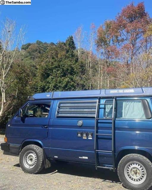

I have a hart time to find a capable windows installer here in the California Bay Area to install custom made Louvre windows for the Vanagon.
So far I went with 2 different installers in the body shop my car is in and none of them is able to install the 2 louvre windows because they are not installed like the other 6 windows on the Vanagon.

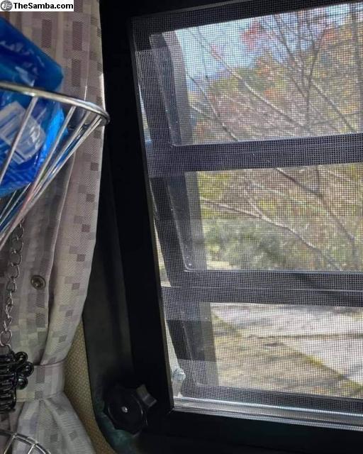

I bought them here at the Samba and the seller send some basic 4 lines written install with the Windows and really he tried to help per email but I am more a visual guy and need pictures to makes sense out of the install description.
Here is what he wrote:
Hello Mike,
The windows go in from the outside. holes have to be drilled in the inner lip in your van... screws go from the inside of the van through the lip and into the channel on the back of the window.
screes?... the screens fit on the inside... they go in from the bottom...up into the channel then drop down to stay in place.
The large seals are just to finish off the look inside the bus... they don't seal water or anything...
The thin seal fits between the window and your paint.. it has 3 ridges on 1 side... the 3 ridges go to your paint... the other side has a small lip... that small lip fits onto the window.
Question I have is if someone knows a capable installer who can do not standard installs or maybe someone did this window before and has some picture specially on the screw in part what still makes no sense to me.

they literally just screw in.
look up in the bay window section "jalousie window" and that may help clear things up
on bays, the screw hole is VERY close to the edge on the pinch weld, just a heads up. not sure how these will work in a vanagon in terms of how close the holes will be to the edge

They fit in perfect and touch the pinch weld.
I am not sure where the screws goes. They would stick out inside and you would see them. It came with 2 seals, one thin one and one larger one you can see on the frame outside. No seal for inside to cover screws pointing inward.
that is exactly how they are. some bays had a decorative "seal" to hide them. that may not be the case with the vanagon windows as they never came with these
you will see the screw heads

these are a "reproduction" of the bay window jalousie windows and install just like (gasp!) jalousie windows for a bay window where they screw to the pinch weld just like they did in the split windows.
funny... people will attack their van with a hatchet to install solar, a/c, different engines etc but lose their minds when they have to drill a few tiny holes...just like westfalia did on earlier campers these windows are modeled after Laughing

i understand that 100%..... gut sliding windows, plug in bay window jalousie windows and rope in a seal like normal
but these were never made to do that as they are a bigger copy of the bay window jalousie assemblies.
even his ad clearly states screws are included for the install:
https://www.thesamba.com/vw/classifieds/detail.php?id=2447553
i suppose the seller is under the assumption anyone purchasing these understands how the original bay window jalousies install, as well as the split window camper windows but evidently that isn't the case.
so i guess the o/p has 2 options...return these and make your own from bay window jalousies or screw these in and enjoy them

they literally screw in. you drill holes in the pinch weld in the area where the extruded groove is, as shown in my link above:
The screws go through the pinch weld and into the little duckbilled channels.
here is the link...again....
https://www.thesamba.com/vw/forum/viewtopic.php?p=8800195
i mean you couldn't ask for an easier install of a window
