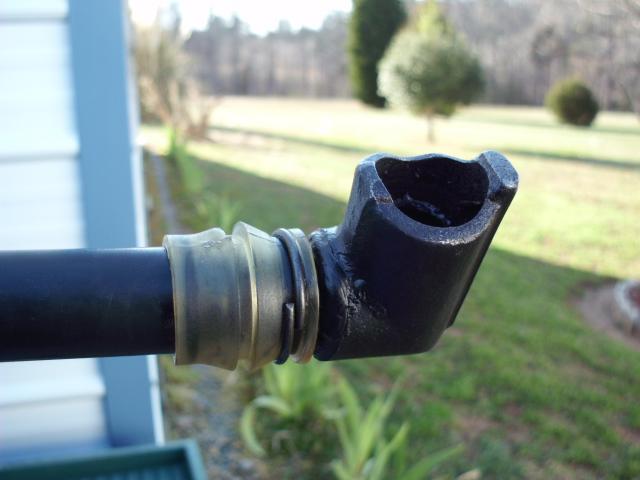

Hi everyone,
Does anyone have a picture of the shift rod bushing actually installed. I don't need the diagram, I need to see it installed. My '64 bus came without one. This is the bushing on the front under the shifter.
Thanks
Moderator edit:
Here's a shop manual and a real photo of a new one installed:
Eric&Barb

hazetguy
Joined: April 06, 2001
Posts: 10804
Location: the past
hazetguy is offline
PostPosted: Fri Jan 29, 2010 8:21 am    Post subject: Reply with quote
phipplet wrote:
Eric&Barb wrote:
From a "Search" of the "Gallery" for "Shifter Bushing" in "Categories" "Parts/Accessories 49-67 Bus" :
http://www.thesamba.com/vw/forum/album_search.php?search_keywords=shifter+bushing
Thanks, You guys rock!
in this pic found in the search above, the bushing is installed incorrectly (a quick look at the diagram would show this).
the snap ring end is supposed to face forward and the slot in the bushing is supposed to face to the side.
also, this area needs to be greased liberally.
correct:

Thanks Hazetguy! Very Happy You saved me. I was about to put the shift rod back in and the bushing would have been on backwards. There's got to be a way to delete that gallery pic to save other people from future problems.
Thanks again.

PostPosted: Sat Mar 13, 2010 2:28 pm    Post subject: shift rod bushing Reply with quote
Here is the one that I am replacing in my 65 westy. Hopefully installed correctly. And, yes, I had to cut off the coupler between the front and rear rod with a cut off tool. It was too rusted to budge with anything. It's going back together as soon as I get a new coupler.
