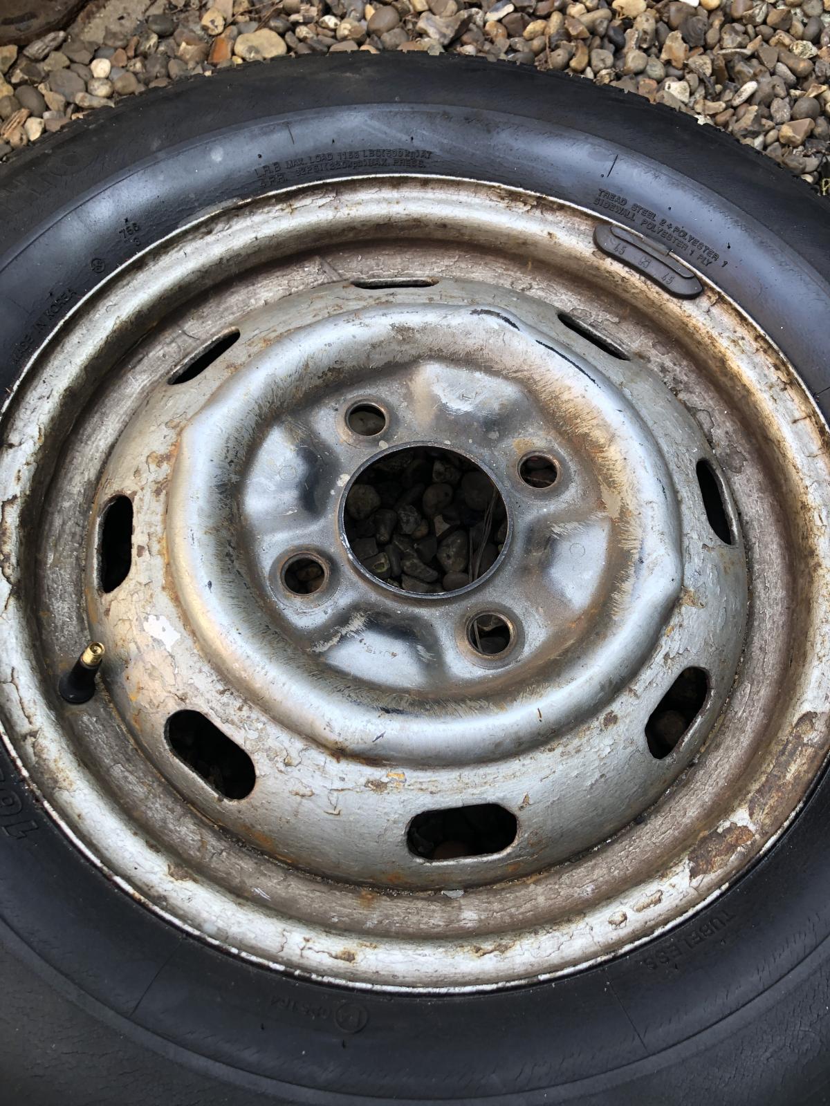

Can I remove the top layer of paint safely on this beetle wheel?
jonat
Joined: July 16, 2013
Posts: 110
Location: United Kingdom
jonat is offline
PostPosted: Fri Aug 15, 2025 4:14 pm    Post subject: Can I remove the top layer of paint safely on this beetle wheel? Reply with quote

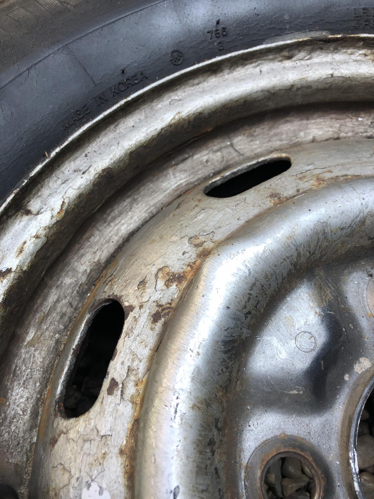

The original paint looks to be present underneath all this top layer of paint which must have been painted by brush years ago. This is the spare tyre in the boot.
Is there a way to remove this top thick layer safely without damaging the original bottom paint?

Unlikely. And it probably isn't pretty since someone felt the need to respray it.
I'd remove as much paint as possible mechanically, then smooth it, and respray with Wurth or other matching silvertone paint.

You might be right. Seems quite rusty in places so probably not worth it.
I’m considering having the whole set of 5 powder coated in the closest match of diamond/metallic German silver which the local powder coater had which looked near spot on to the correct L91D

Originally those wheels (and many other models) were coated from the factory completely in black. Then a template was laid over just the fronts for a coat of silver paint. You can see the fade around the lug bolt areas.
That said, I often powder them black and spray a good coat of silver myself. The result is more factory on the inside rim face as well.
